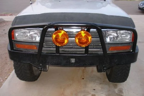

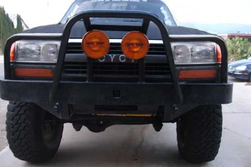

I finally made it to phase II of my custom front bumper. I first built this bumper with the help of a friend over 2 years ago. That same friend and I recently began some changes that I had in mind for quite some time.
The original thread is here https://forum.ih8mud.com/showthread.php?t=46827

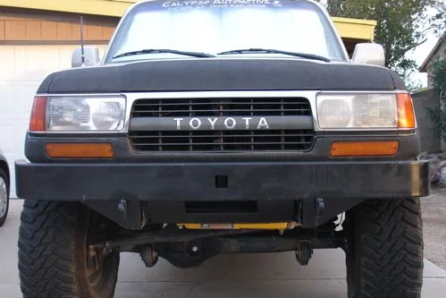

Phase 2 started with some shackle points from 4x4 labs. The same ones are in my 4x4 Labs rear DIY bumper. I then added some reinforcing gussetts to those points and the main bumper.
Here is a pic of the gussetts and recovery points added to the original bumper
I then used a print of the above pic to draw out what I had in mind for the stinger and headlight hoops.
We used 1-3/4 tube .120 wall. appx 15'
First the middle hoop was figured out and bent and welded into place. I drove it around for a couple of weeks until we had an opportunity to finish. I don't have a bender so this job had to be coordinated with when my buddy had time.

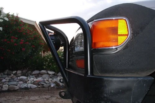

Then we did the uprights/supports for the center hoop. Once those were done we figured out the headlight hoops and got those in place. The next day at home I put in the bracket for the LightForce 170's and got it painted.
All told about 7 hours of work for Phase II of my bumper.

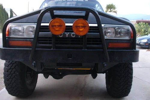

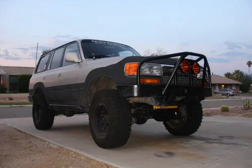

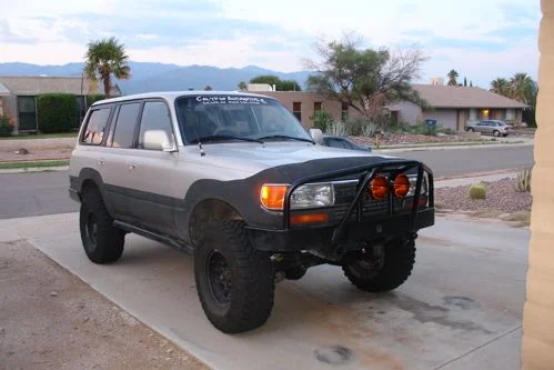

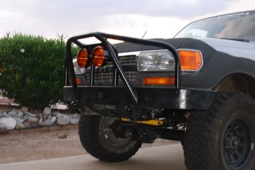

These pics don't really do it justice. It's pretty sweet and still lighter than an ARB. There is room under the lights for my (future) receiver mounted winch. It will probably be a T-Max Outback series. They have a good low profile to fit under the lights.

Thumbs up for trying something different from everyone else and doing it yourself. It's nice to see some new ideas come to the table to give others (including vendors) ideas for new designs.
Personally I don't like the side peices you've added. The center stinger/light brackets are decent but the lines of the side peices make it look very bulky. Just my opinion which doesn't matter anyway. If you are pleased with it then run it. Looks plenty strong.
Once again good job being unique and trying something on your own.
it looks really clean and nice in #1, without the hoops. Good work, unique. very cool you have the fab skill
what is a 'stinger'?

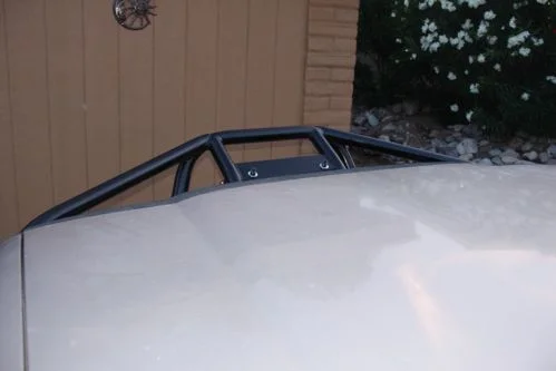

A stinger is what my buddy calls the center hoop (not sure why). It is higher than the radiator so, in theory, it would protect the radiator in a roll over. The headlight hoops are also high enough that they should protect the battery as well. With those things protected, if the rig isn't completely toast, it should be able to start up and drive again. I sincerely hope I never have to test that theory, but I know someone who has and his rig started up.

Yeah, I was on the fence about doing those as well. But in the end I decided I wanted the extra protection for the whole front end. The only rub about doing it the way I did is that when I burn out a bulb I will have to undo all 14 bolts holding on the bumper and slide it forward until it almost comes off...just to change a bulb.

Dunno what kind of wheeling you do, but one of the functions of the stinger is to aid in steep descents--kinda like sliders for the front end--they keep you off the rocks until you get your wheels off the hill. that being said, are you worried about the lights getting taken out while wheeling?
I like the lines of the original bumper, the tubes look good, but not my style.
Web wheeling only for me.... he he he.
Well, if I ever come down anything steep enough to rub that stinger the lights may get hit on the bottom edge. If I'm lucky they will just get hinged back. Or if I know it's gonna be a rough descent, I can push them back some.
