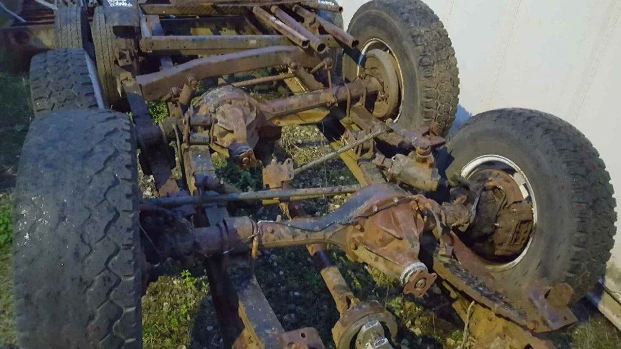

I'm planning on going 4 wheel disc brakes on my '67 FJ45. I found a front and rear axle setup out of a '79 FJ55 for sale on Craigslist, I'd just need to disc the rear. Any know what mods if any will need to be done to get these mounted on the '45?
Just keep in mind if they're 79s, they'll have the taller 3:70 gears. I put a set in @FJ45Dude's truck. With the 2F he got from @orangefj45, it works just fine.
Also, not sure if your planning on replumbing new brake lines but the truck will have the old, obsolete 9mm hardware and those axles are 10mm. It's easy to cut/flare the lines and replace with the 10mm stuff.

Can anyone tell me from either looking at the axle picture or identifying marks I need to look for on the axles when picking them up, to make sure I'm getting what's advertised ('79 FJ55 front and rear axle setups)? I will be picking them up after dark, so the easier the better.:clap:

unless the diffs have been changed, if it has the smaller knuckle pattern it should be 4:11's, the larger knuckle pattern should be 3:70's
another would be if it has the short aisin hubs it will be the 79+, the longer hubs would be earlier.

Both excellent points Paul.
