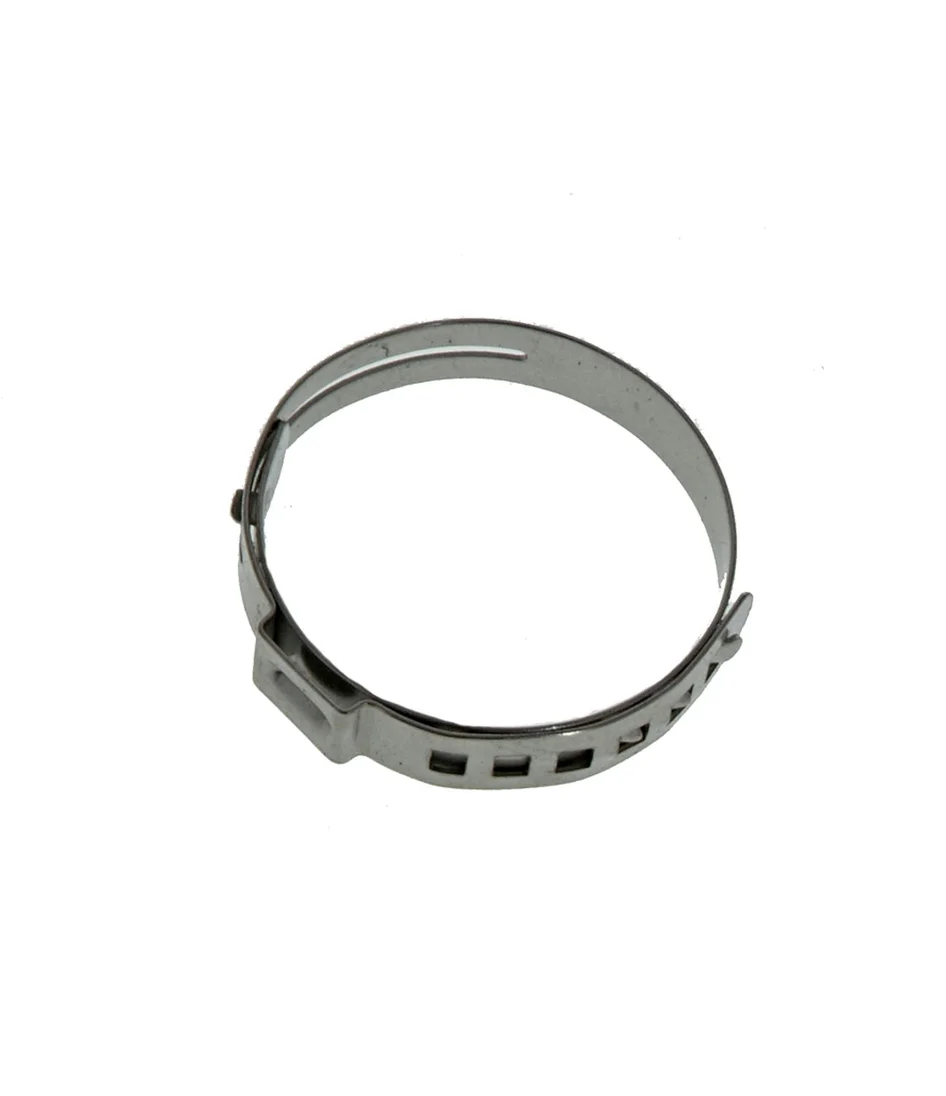

Sometimes the small clamp on the inner boot is not clamped with enough tension and it will leak a little- mine started right after the warranty period 🤨. You can tighten the the clamp with the right tool- OTC makes a good one.
Check your front height- 21.5” is a good hub center to fender lip setting (2”) that yields a little better than 70mm droop- if it’s too high, you’ll limit droop <50mm and that will impact your angles and put some additional stress on the boot/clamp.
Napa sells CV boot clamps- I think a better option to worm clamps.

I recently reclamped a CV with the above linked clamps from Cruiser Garage. They solved my slinging grease with ease. No issue with them or negative side effects.

@badlander Are worm gear clamp better than the oem. Hence not allow the grease to get out or twist out?
Yes, you can adjust the tension as required to stop any leaking that presents itself. They are also very easy to remove, replace, and adjust in the field which is almost impossible with orher styles of clamps.
