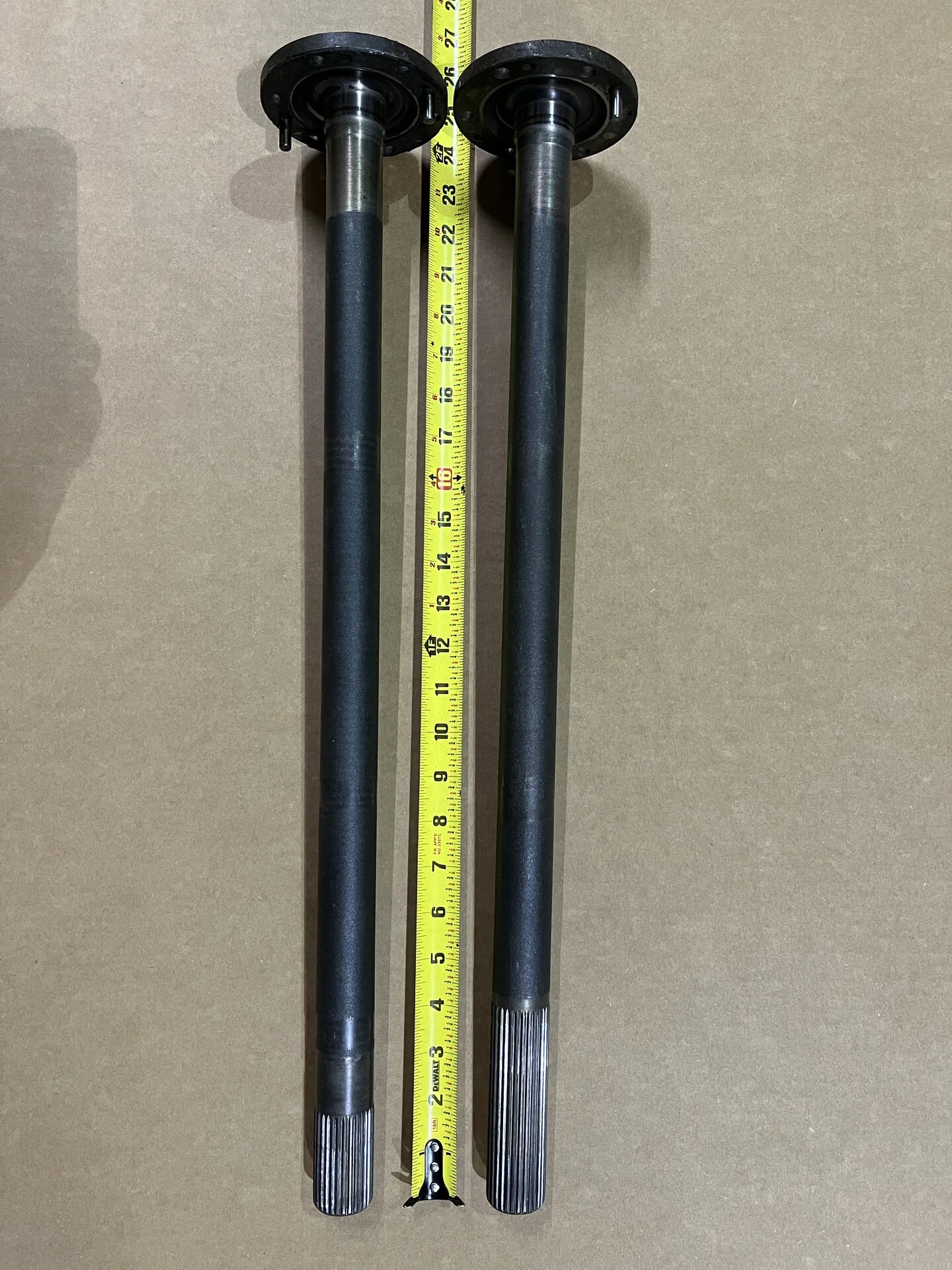

Those axles look fine. I would upgrade the studs to ARP's if you can. Make sure you use a factory type gasket and make sure both surfaces are dry and free of oil/silicone ,grease etc.

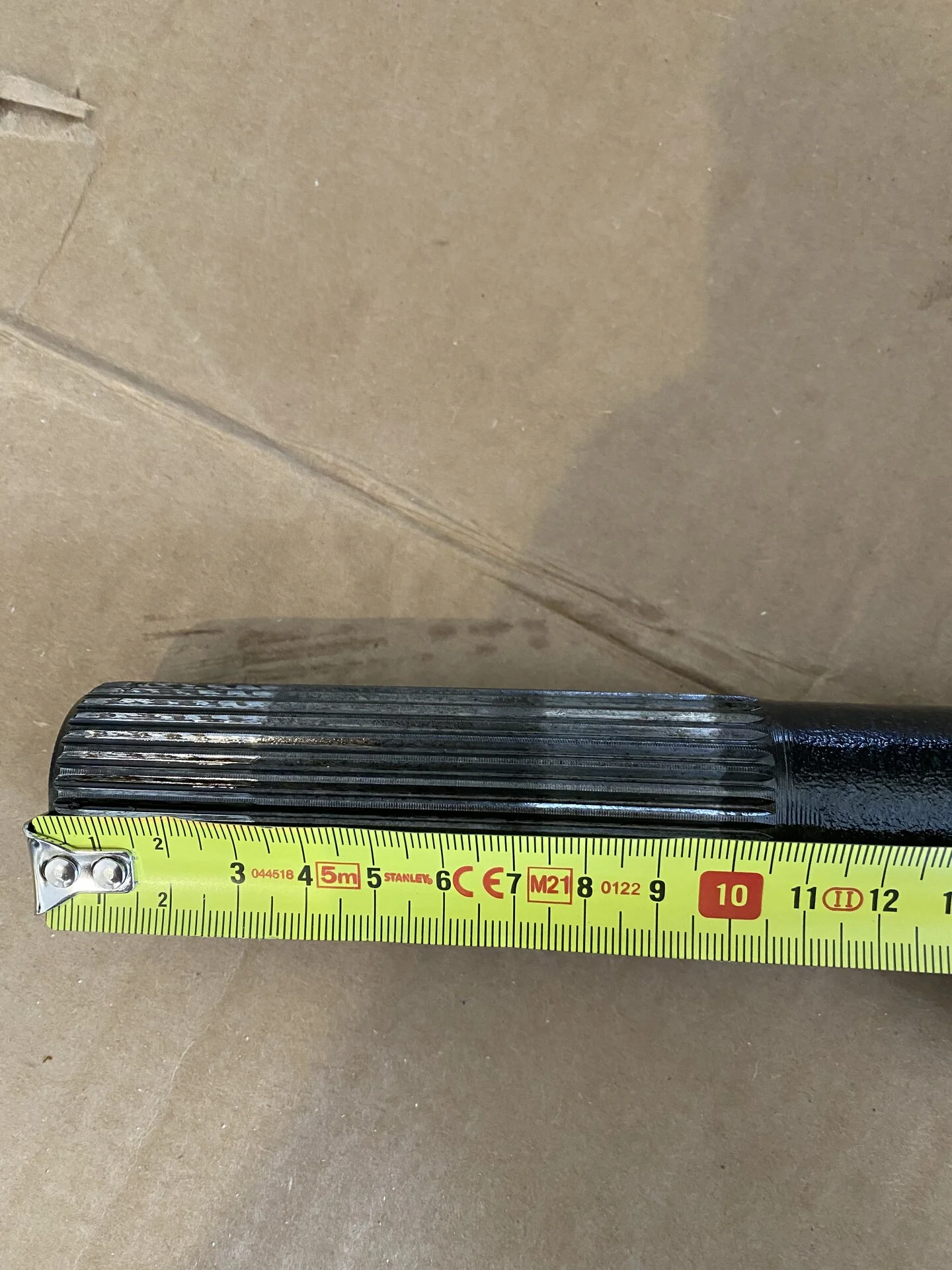

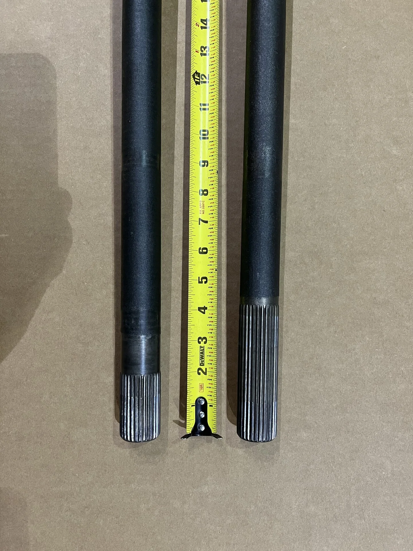

The splines on my axle seem to be much longer than the ones posted earlier. Here on mine they measure to 105 mm.

Why replace the axle if its not broken? its just the studs that broke right?
I only suggested it as I see people chase this stud breaking issue multiple times and in Australia where replacement axles are readily available its nice to rule out a whole lot of issues at once - sometimes the axle can be bent, sometimes the dowel pin holes are wallowed out, sometimes the cones for the cone washers are damaged. The axle does look in reasonable condition though. Its especially important to replace the axle if you're heading into a remote area, for the sake of $AUD200 its nice just to rule it out after such a failure. The cable lockers and possible axle differences are a curve ball.
Yes. I had not seen this problem before and wanted to make sure everything was reusable before I bolted it all back together. That’s when the cable locker issue came up.
But I am reusing the axle and hopefully the hub if I can extract the studs with no problems.
It seems to be false. The shaft part number for full float and semi float axles are the same (42311) as per Toyota parts diagrams.
the shafts are the same length, the splines are cut longer on a truck that has lockers
