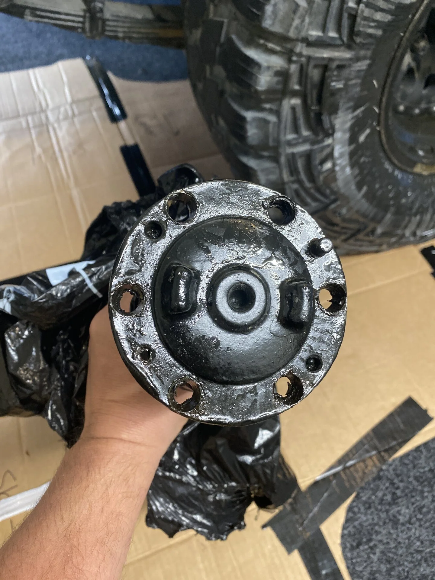

My inner axle popped out. Felt a slight “thwunk” and then lost power to the wheels Felt like the clutch slipped out of gear. No. I jumped out and the rear axle was sticking a full foot out of the bearing. Every nut and one pin holding it in was sheared at the face.
We had gone out to red rocks, Wellington ,Nz (quick google to see the terrain type). Didn’t push hard since I was testing the HJ61 out there. No obstacles, I didn’t go through devils gate, I stayed on hard pack and rock trails, so no soft sand. I was in 4high the whole time, no lockers were on (I have the stock cable locker system and tested them previously). We came off the beach, turned off 4wd, turned right onto the coast road, turned left into island bay, and as we climbed a slight incline, it happened there. That was all the driving it took with rear wheel drive.
How/why would this happen? Tow guy said he’d never seen this on a cruiser. Is this common? Can’t find any replicated examples of this exactly in threads here. I suspect PO didn’t torque the nuts to spec and the rocky terrain plus touchy 12ht throttle to loosen them more until…shear.
Can this axle be reused? It looks good still. The bolts on the bearing housing are the ones that took the brunt of damage. The diff end still looks good. Zero dirt/sand in the housing, and lots of oil, so it didn’t slowly give, it just went.

Upgrades are not required. This failure is almost always just poor bearing maintenance, a close inspection prior to the failure would likely have shown the dowels were walking their way out. Trash the axle, trash the hub, get new replacements and rebuild without upgrades.
Before big trips, and at least once a year. Jack up the rear, remove the axles and check for play in the bearings. You cant check play with the axles in. Also jack up the front wheels and check for play (axles can be left in on the front for this test). A visual inspection of the grease (or lack thereof) can be done when the axles out for inspection as well. Bearing play checks are done by grasping the wheel with both hands and rocking it from side to side and up and down - any bearing issues will result in the wheel wobbling on the hub - for obvious reasons the wheel has to be off the ground when you do this check.
During trips, check the dowels for movement in the rear and at least once every few days put your hand on each hub after a long drive and check none of them are particularly hot.

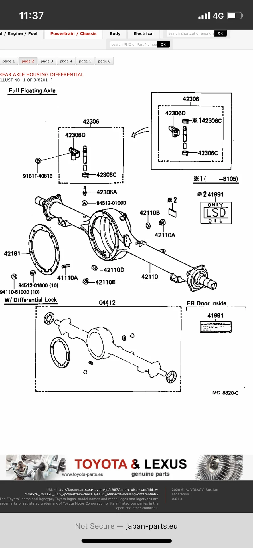

It seems to be false. The shaft part number for full float and semi float axles are the same (42311) as per Toyota parts diagrams.
The discussion was around cable locked diffs.

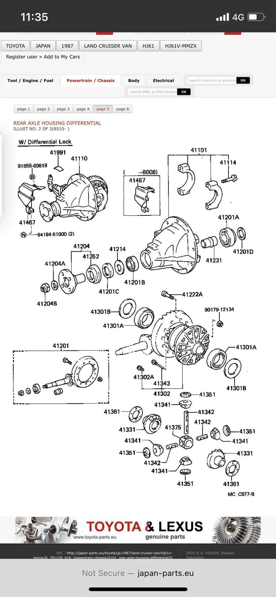

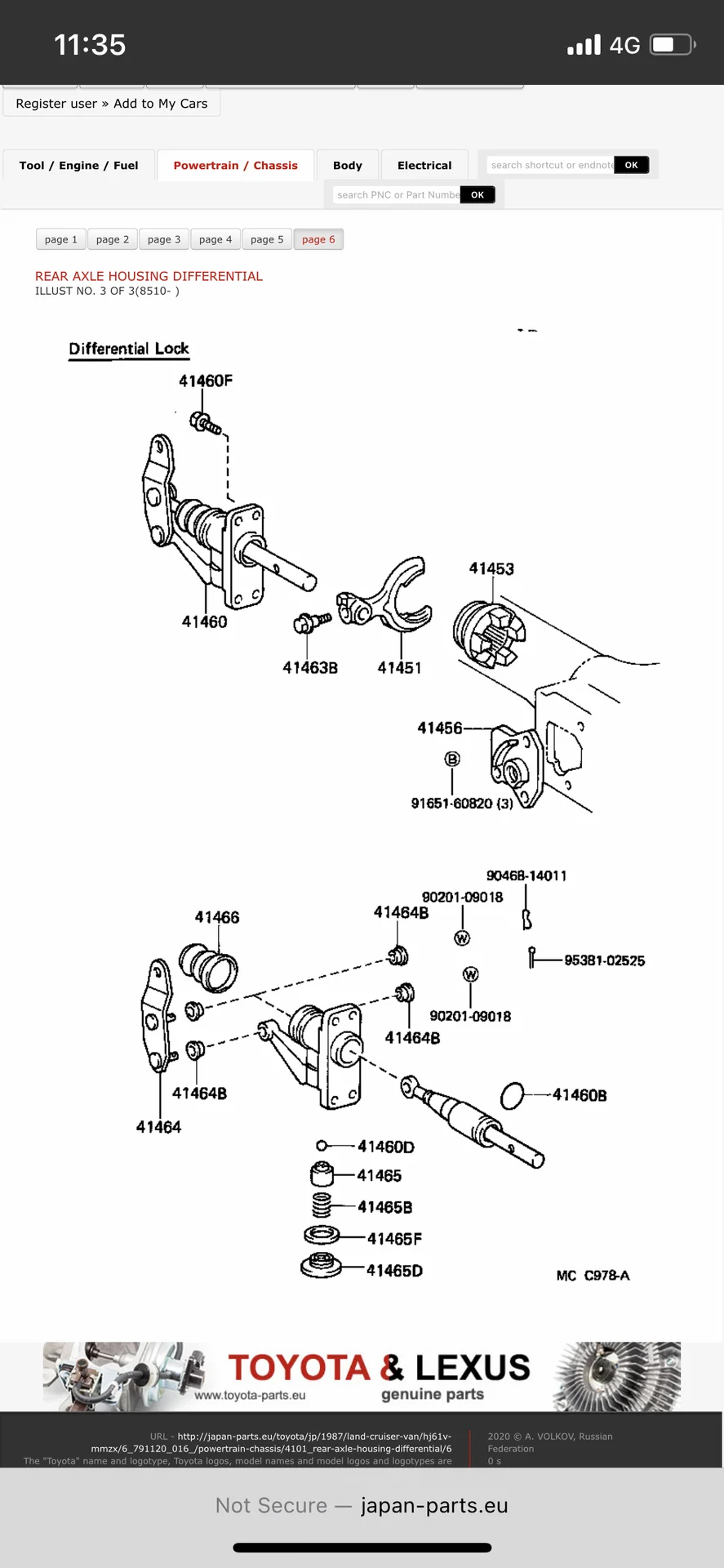

(Edit: I have included the part number pages for the rear diff and axle. You can see there is a differentiation between cable locked and non cable locked diff, but none is made for the axle shaft itself. Unless any concrete evidence of something else, I am going to get the axle shaft listed and install it.)
Yes, but there is no part number for cable lock diff axles. There’s no section that differentiates cable locked vs non cable locked axles and parts.
I’ll measure the axle splines and shaft I pulled out of mine when I get home and post it so we can compare them to non locked measurements. If they’re the same (within a couple mm, I don’t own precise calipers) it should put the claim to bed. If not, it looks like I have more research to do.
I will admit, however, it is always possible that the PO of this specific truck may have installed an axle shaft not meant for the HJ61 cable Locked axle. I’ve found lots of strange unadvisable things in my Hj.
I believe the 5 digit # on that diagram (42311) is used to find the 10 digit part number in the parts number list.

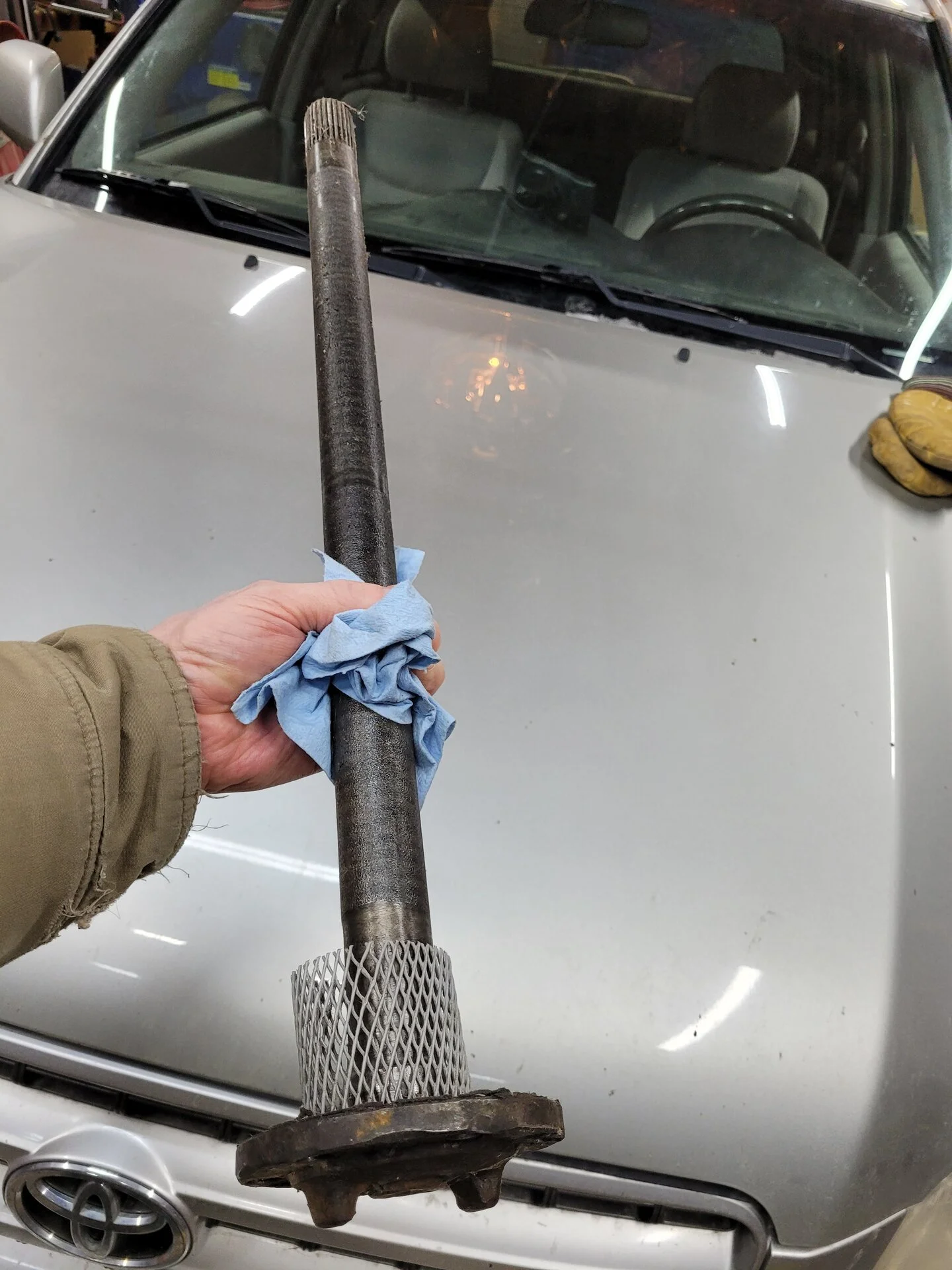

I have swapped e-locker diffs into 60 series axles... I'll say again the inner axle is different between locked and non-locked full floaters on the short side rear (and long side front). The long spline axle for a locker will work with an open diff, but not the other way around. The splines for a locker are ~3x as long as needed for an open diff. Unless there's wallowing of the pin holes on your current axle shaft, I'd reuse it.
Edit - pics of short side shaft from a non-locked, full float 60 rear axle.
