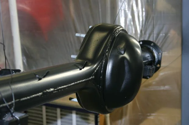

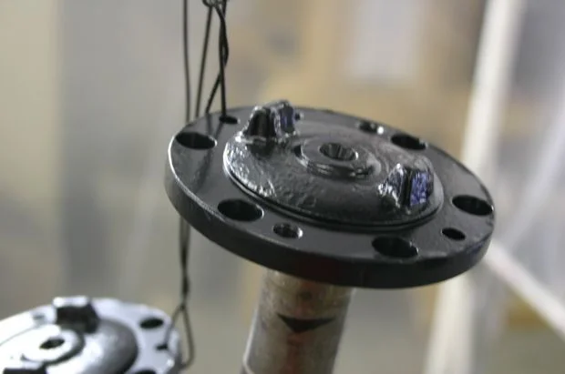

Here's some pictures of how it turned out. I'm thinking that I'll just leave it this way and see how it turns out. Our paint jobber has some stuff that lives outside that has been painted in simple DP90LF primer, and it still looks good and hasn't had any adhesion problems.
I'm certainly no expert either, but the DP primers are awesome to spray, and I'd use them even if I were to put a topcoat on (which is why I didn't hesitate to just put the DP90LF on it).
Dan

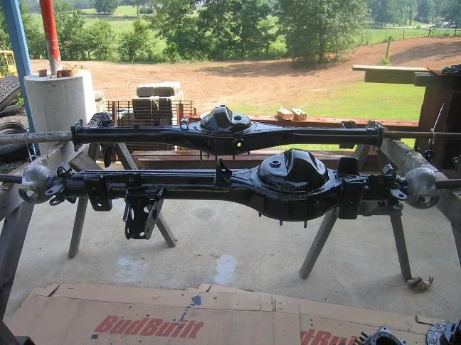

Well I bit the bullet and went with POR15. I stripped the axles with a BASG (that's big a** side grinder) with a wire cup, steam cleaned and then prepped with their metal ready. I put on two coats of POR15 about 2 hours apart (it was hot and humid so this stuff cured really fast). I then put one coat of their chassis black top coat. They look fantastic. I also painted the steering arms, axle hubs, and Marlin Tie-Rod. I decided not to do the dust shield as it's aluminum and looked pretty good after a bit of cleaning.
Here are some before and after pics:

I really didn't smell the paint much at all. I wasn't spraying and I was outside but under roof. I used a 1 1/2 brush and couldn't believe how well this stuff levels out. Although I really didn't care (they are just axles after all), they look sprayed.
I can imagine that if you sprayed in a confined space, however, that you would really want a good respirator.
