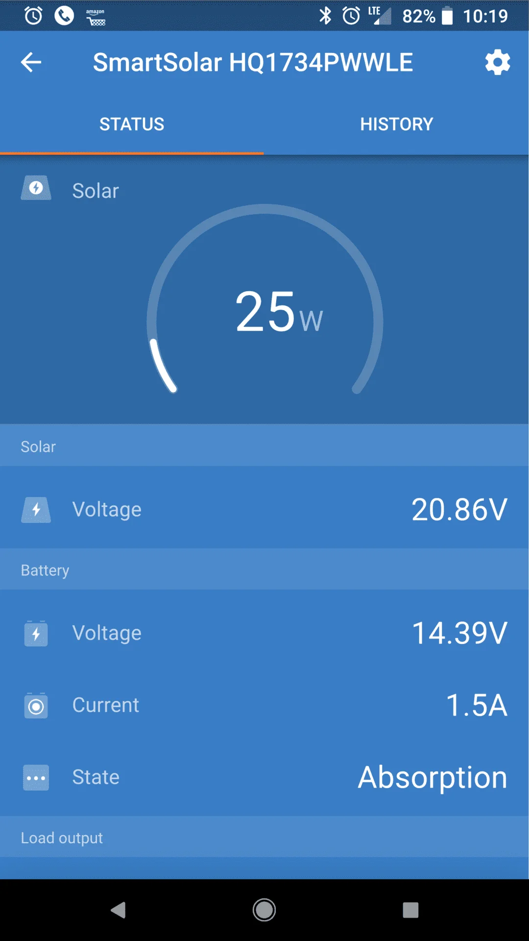

I purchased this and received it yesterday. I have a 100w foldable solar suitcase, but the most I'm seeing is 30w in direct sunlight. Shouldn't I expect to see something closer to 100w?
Yes, like Semi Hex wrote, the MPPT will meter how much current goes to the battery depending on it's charge state.
Create a load on the system (turn on the head lights while the engine is not running) then test the production from the solar panel and the amps going to the battery.
I found on a sunny day I could get over 70 watts from the panel when there was a load to feed.

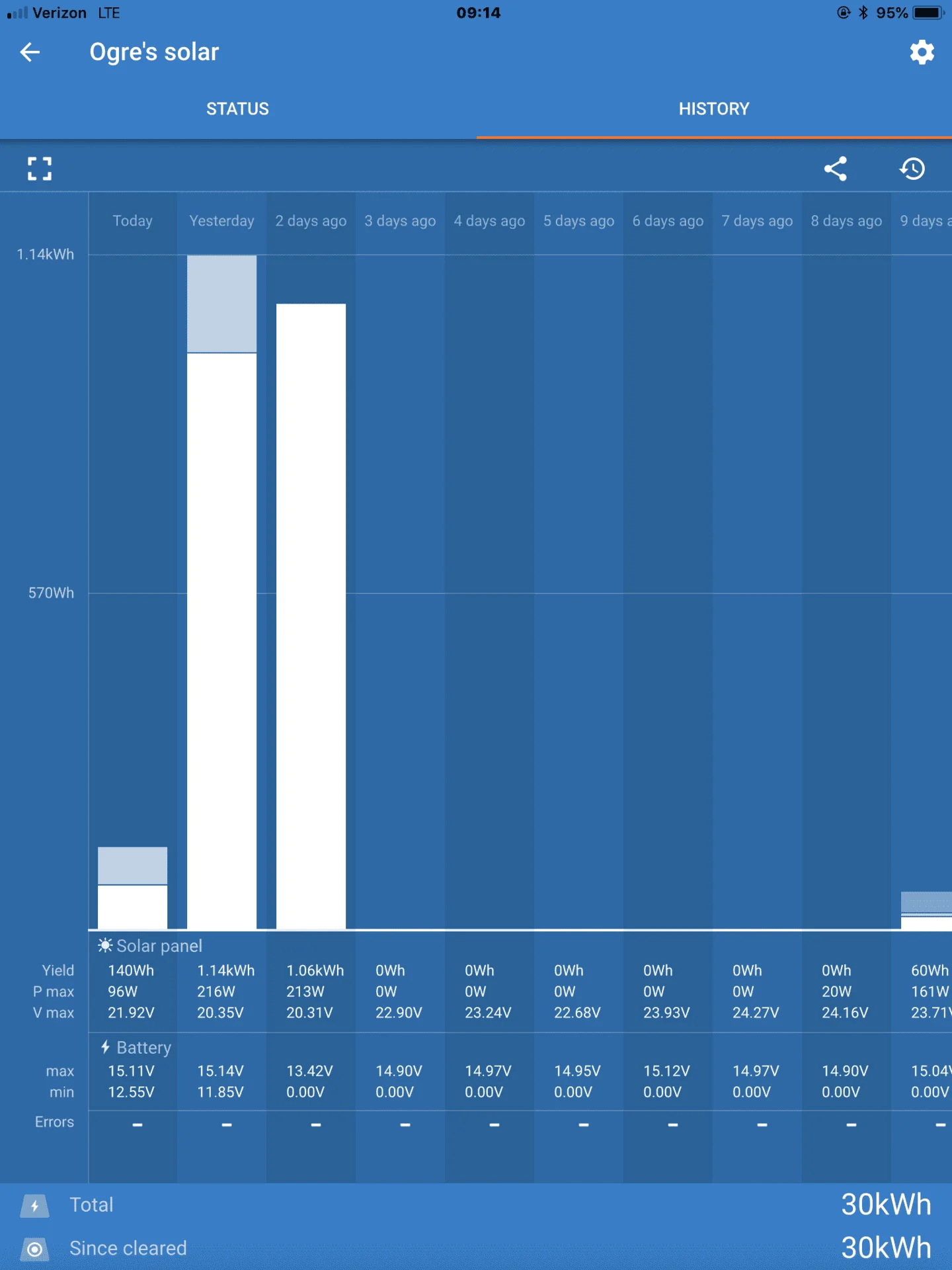

So there was a little glitch in the system and it stopped working. I only realized the issue when I tried to use my inverter. I had to unplug the dongle, battery, panel and reconnect them before it worked again. You can see that it took two days to recharge. I had upgraded to the Victron 30 but everything should be the same as the 15. The weather was sunny the entire time except at night :)

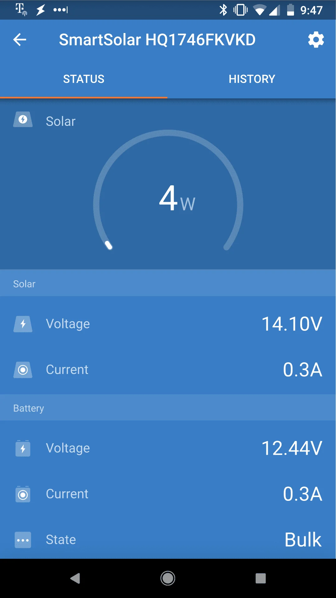

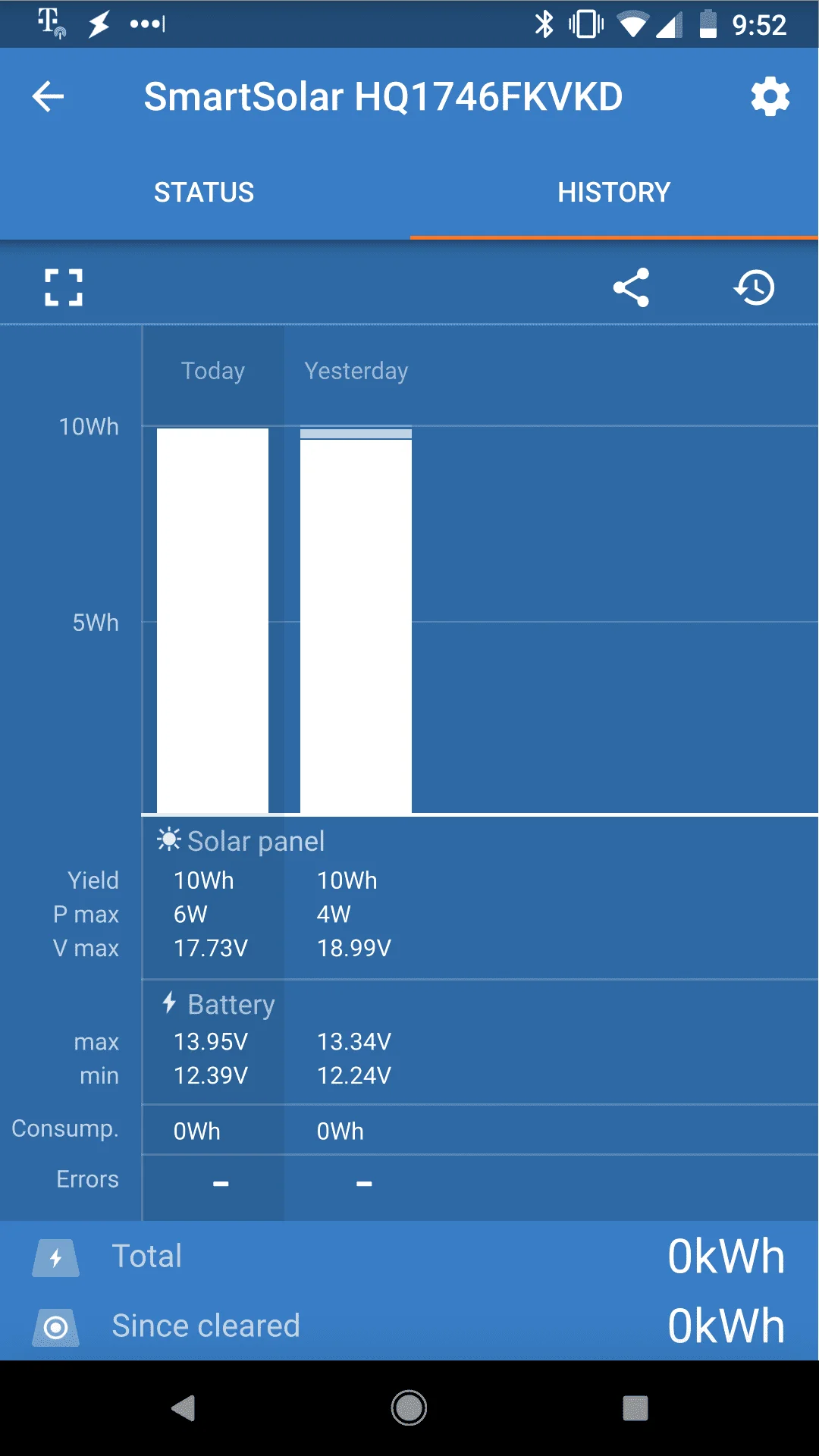

Installed the new controller, 75/15 Blue solar, with my 100w renogy panel. Can't seem to get more than 4-6 Watts on the app reading. I'm in full sun, battery is hovering around 12.5, and panel voltage has been up to 18+ several times. Any ideas?
Fridge has been running at 32 degrees F with just a couple bottles of water, so there should be a decent draw.
What happens when you create a bigger draw, say turning on the headlights or putting the fan on high?
If you could check a couple of things: is the led lit on float, did you set the unit to your battery specifications, is your panel dirty and is your unit stuck (unplug and set up again).
The blue led is lit. I'm running a flat plate agm, and I have the unit set to spiral agm (I couldn't really see a diddiffere in the specs).
How do I know the unit is stuck?
So you're not getting anything off the panel. Check wiring, make sure you got the polarity right and that your connections are good. Do you have another panel to swap in temporarily to make sure the controller is working? Also be sure it's updated to the latest firmware version.
I *might* know your problem. First off your panel voltage is really low. It should be 16-18 volts. (Thats where the maximum power point is). So again look carefully at the panel, there's a problem somewhere. Measure the panel voltage not connected to the controller. Should be 22 volts.
But the problem-I seem to remember with this controller, there has to be at least a 3 volt difference between the battery and the panel for the panel to provide any real power. So with the panel at 14 volts and the battery at 12.5, it won't work. Something is up.
Are you certain the battery leads to to the battery input and the solar leads to the solar input? It's easy to confuse. Go back through everything. Here is what I would do:
-Disconnect the solar from the controller-measure the panel no-load voltage with a meter Should be 22ish volts
-Disconnect the controller from the battery. Measure battery voltage with a meter
-Reconnect the battery to the controller. Pull up the phone app, make sure the output is turned on and the firmware updated
-Reconnect the solar to the controller and see what happens.
If that fails, you'll need to go through your settings. I'll come back with a screenshot.
