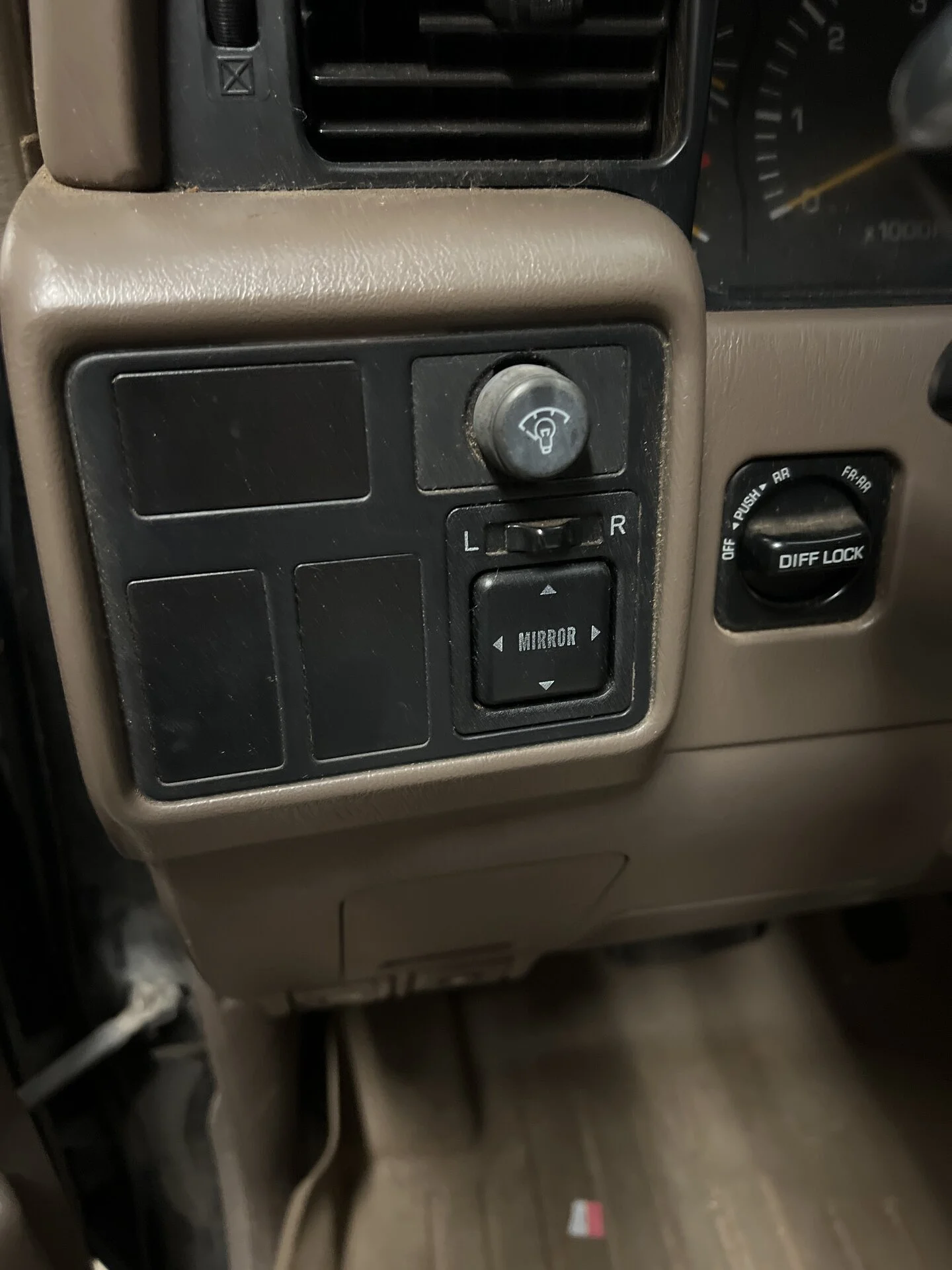

SucioP Joined Oct 30, 2018 Threads 33 Messages 341 Location Oklahoma Oct 30, 2023 #1 How do remove the auxiliary light panel? I’m reluctant to start prying blindly on +25 year old plastic….
jonheld 10 Year 15 Year Joined Dec 8, 2006 Threads 462 Messages 13,374 Location New Jersey Website www.sdsysdesign.com Oct 30, 2023 #2 The individual switch blanks pop out, but the black surround is glued to the lower dash panel. The lower dash panel pops off but you have to remove the lower skirt first.
Outsane Supporting Vendor 10 Year 15 Year Joined Oct 1, 2010 Threads 93 Messages 3,182 Location San Mateo, CA Website solvefunction.com Oct 31, 2023 #3 A good peice of double sided tape, clean the surface. Apply the tape for 30 sec and pop the blank out.
