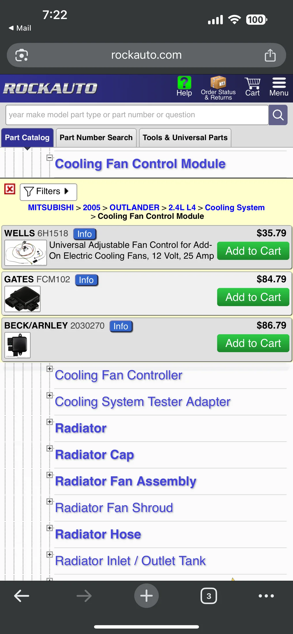

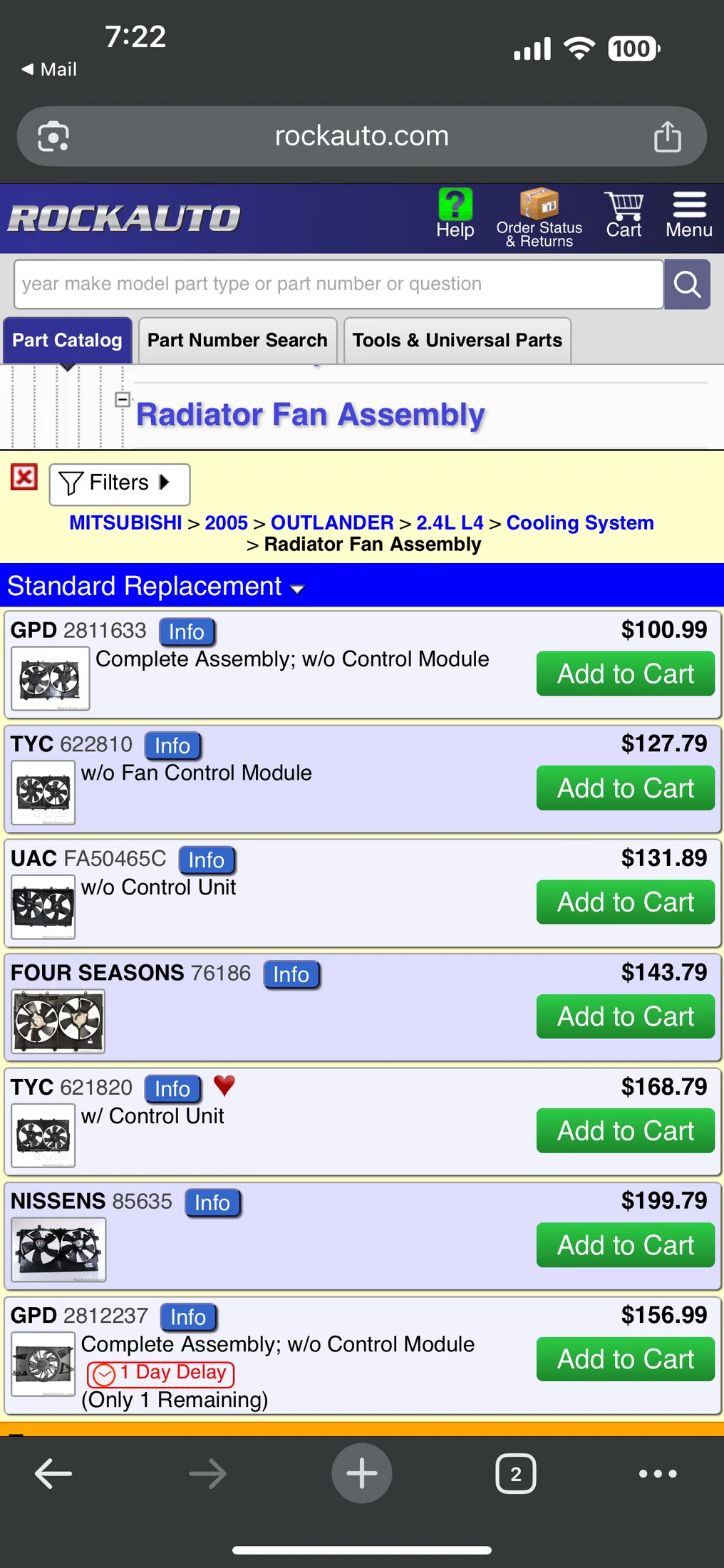

As an update about alternate options, several guys in my local club have used a Mitsubishi e-fan and controller. It is said to mount easily with some DIY tabs to hold the shroud to the radiator.
