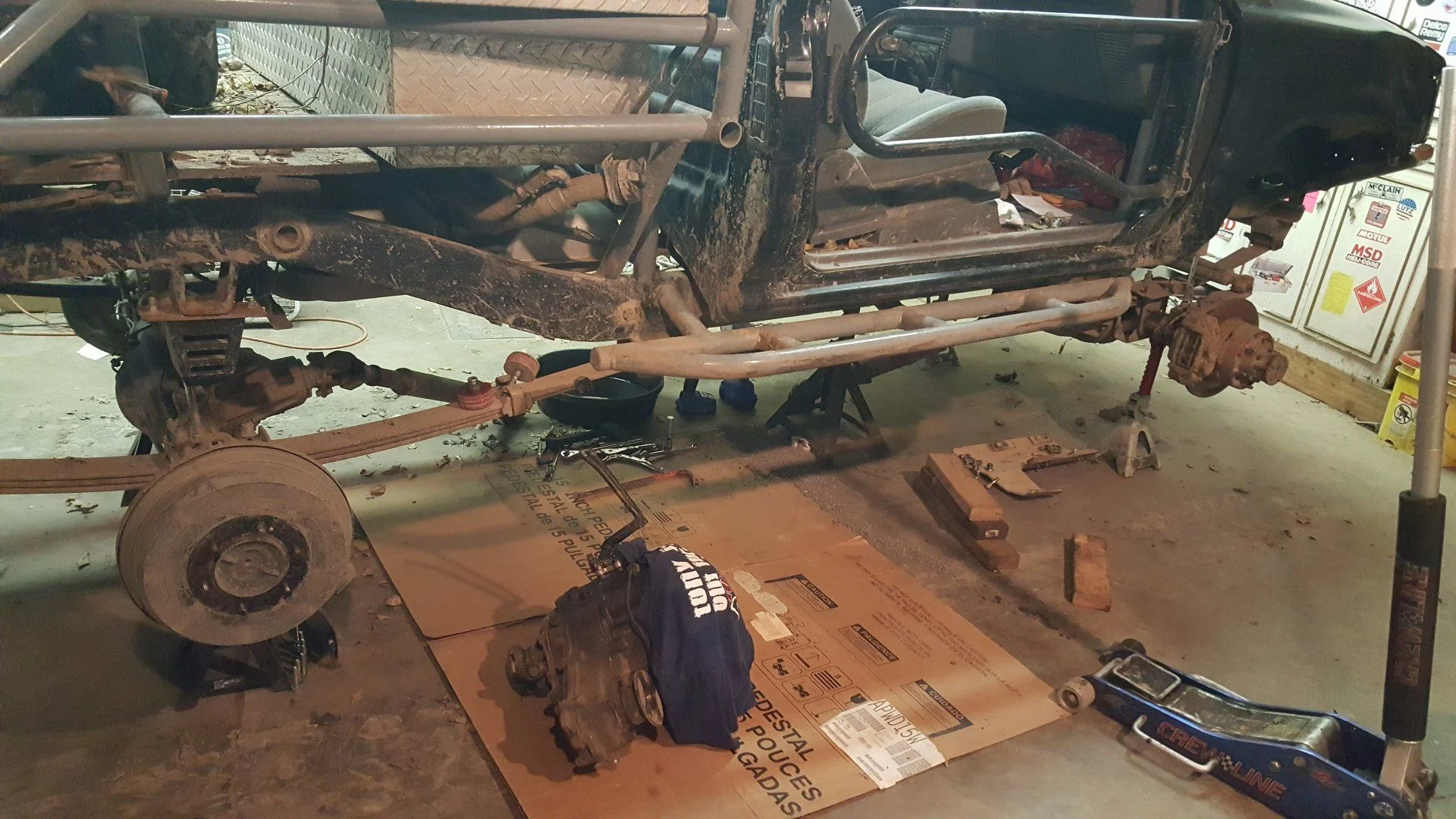

Auto trans and softer ride for my mini.
rear case is out.
Gears go in it tomorrow.
I might take out the front case as well, though I don't see a real reason to, other than clean it up and put a new seal in the trans.
they are purdy and will look nice under a 2wd mini.

Got the gears mostly done, but not finished.
Spend most of the time making sure the tires were safe from any stray slush puddles.
I was surprised how little grinding is needed on the case. Aluminum grinds away quickly.
I'll finish them up tomorrow.

Got the gears done.
Glad I tore it down cause the front output bearing was bad. I had another one.
One of the lube tunes was bent and not supplying lube to the transfer part. Hence the bad bearing I'm thinking. Had another tube.
Had the detent ball I lost in my box of other tcase parts.
