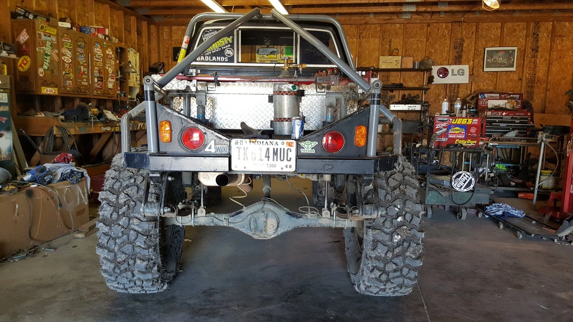

Bed, all finished.

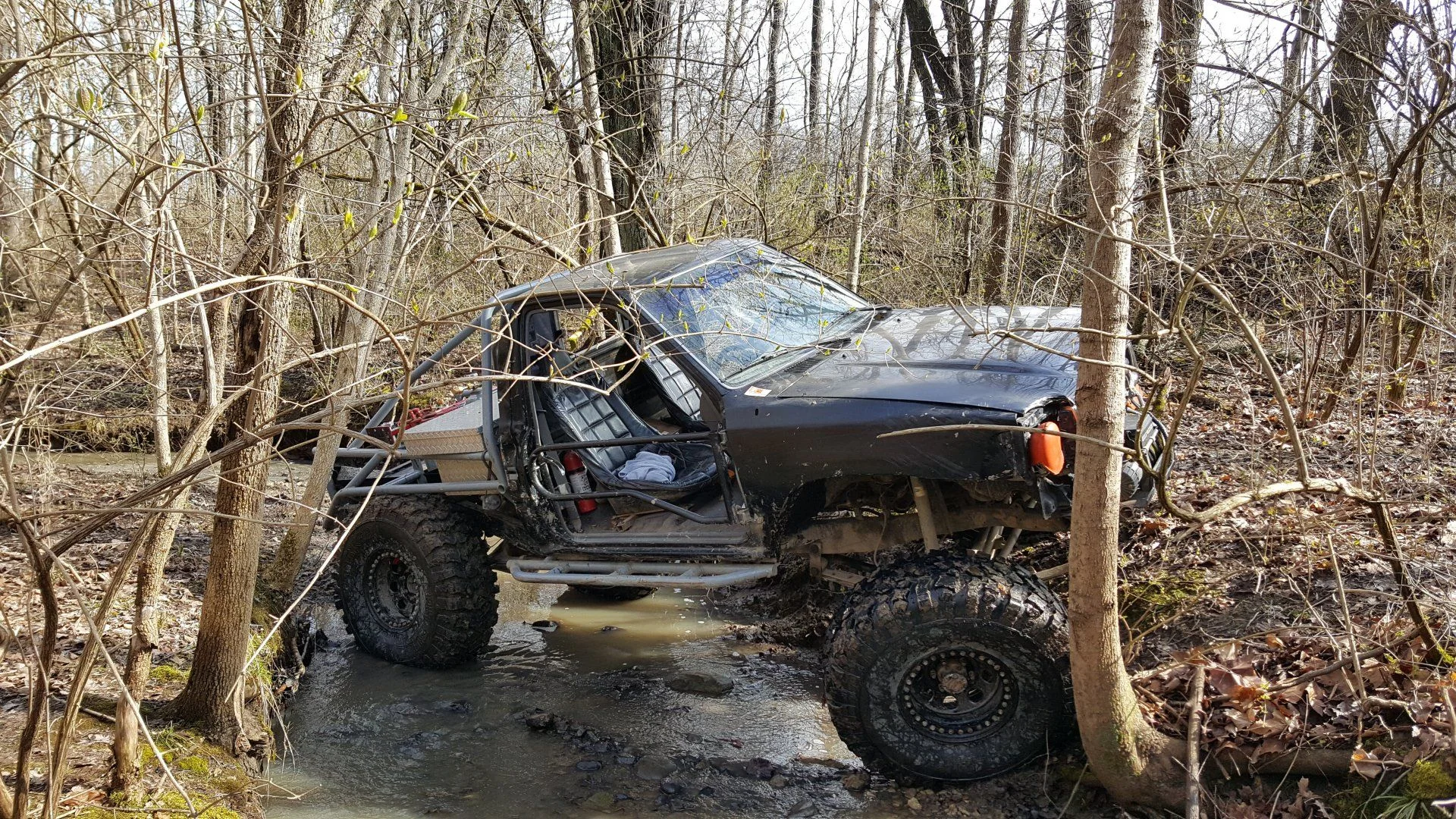

Got both sides clearanced and tested. Looks good so far as I can tell from 4 wheelin in my woods.

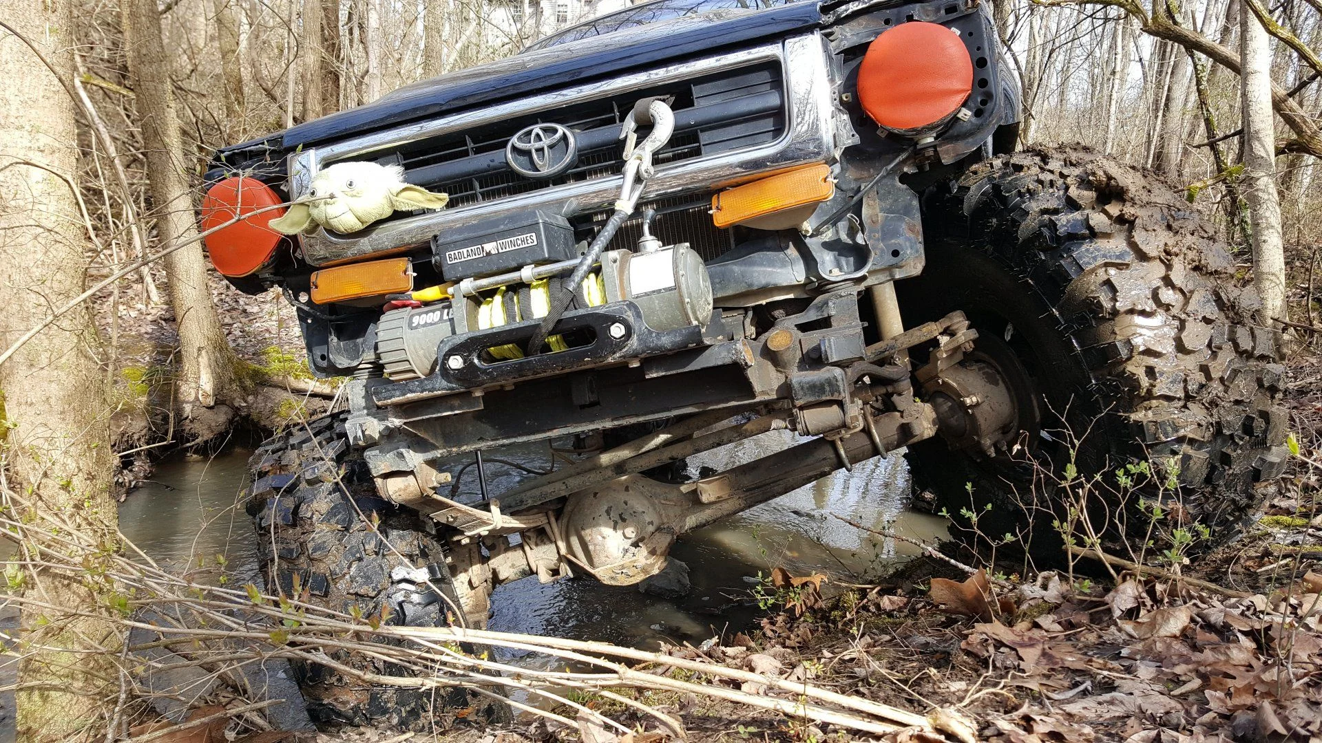

Lights done in front.

Antiwrap, axle truss and box in my rear perches scheduled for Monday and Tuesday. Got the steel for the crossmember.

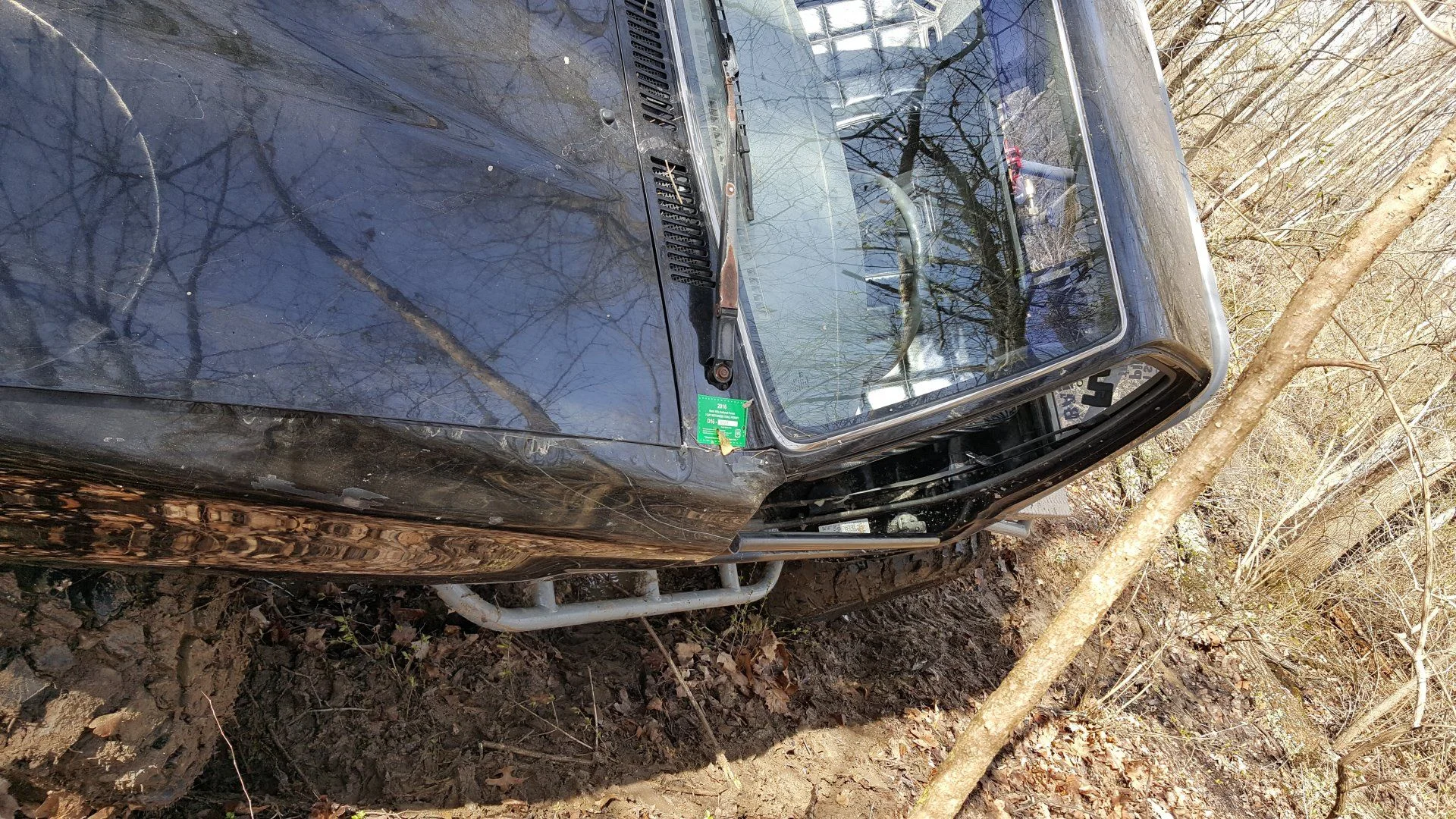

Only the slightest rub in only the most extreme stuff situations.
Wheeled it for bout 2 hours today out in my woods.
That's equivalent to a day at the badlands.
Most fun.

Why no pics?

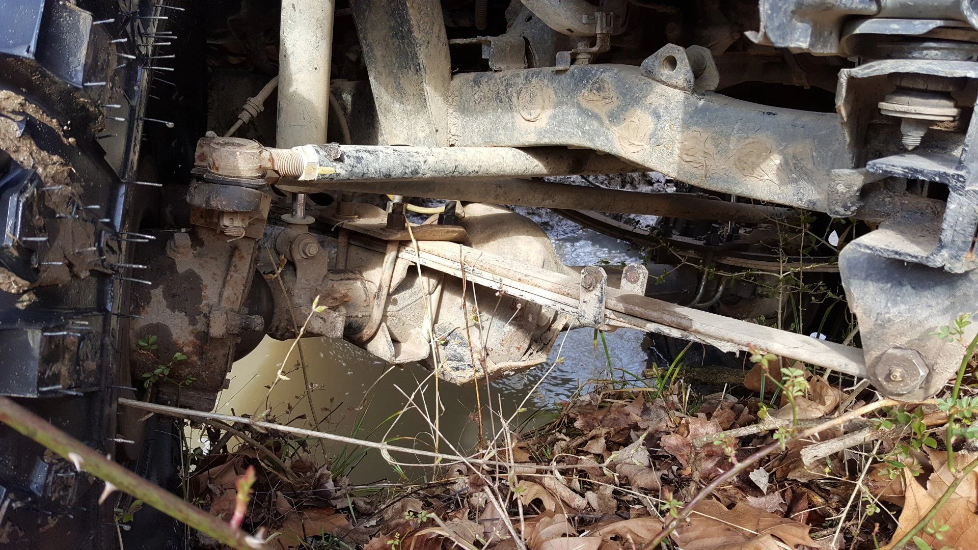

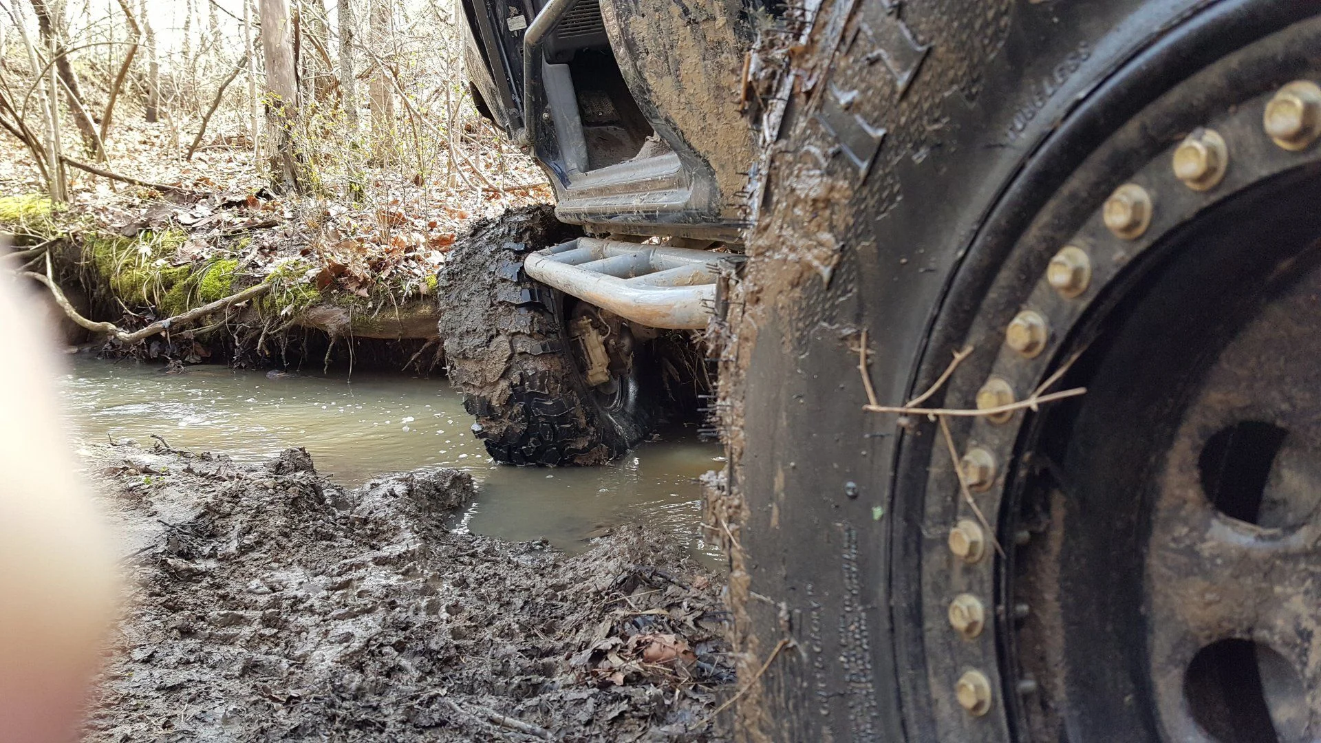

at max flex this way.

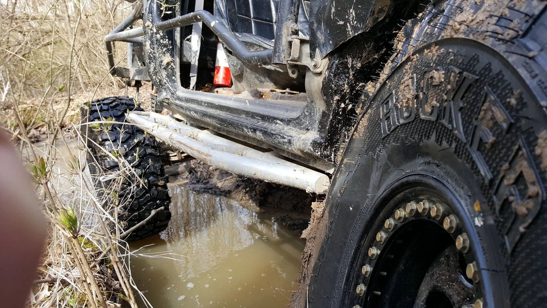

it was greasy mud everywhere and the tires had amazing traction. Had lots of fun on my shakedown.

Any plans to notch the frame for drag link clearance?
