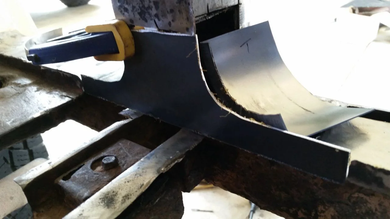

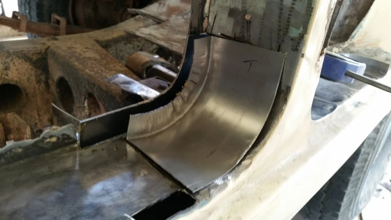

Cutting all the tin worm out of the pillars at moment.
Bent the new steel
Putting the new sheet metal shrinker to good use.
Finished panel:
Made a smaller patch for the other side

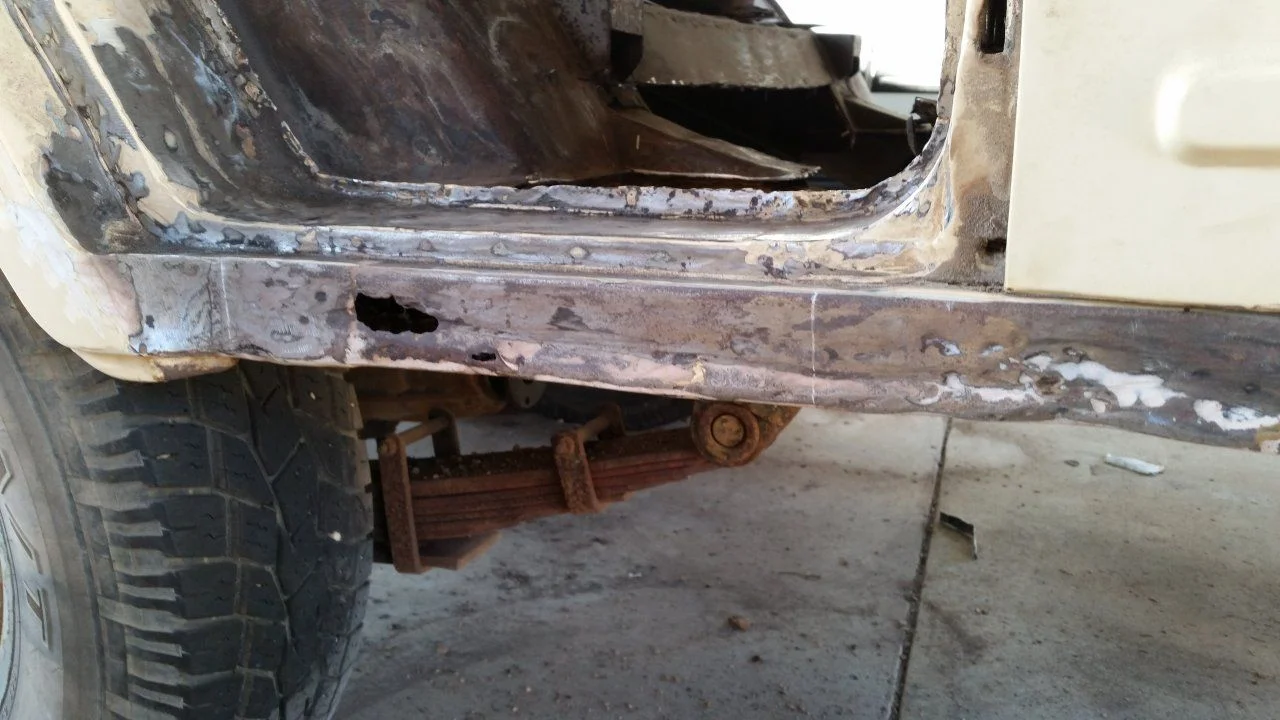

Only 100 more to go. You can see under all the layers the car was originally blue.
I wonder how the sill got bent. It has been patched with silicon bronze wire and reshaped with a lot of bondo
Kept cutting. Side pillar body mount bracket fell off. This is what is left of the good metal:
Nearly finished the FJ45V sills. Base is made with 3mm plate. Just not happy with the top shut line. Has a low spot. Silly me doing it the hardway and going bare metal finish. Everything has to be perfect.
