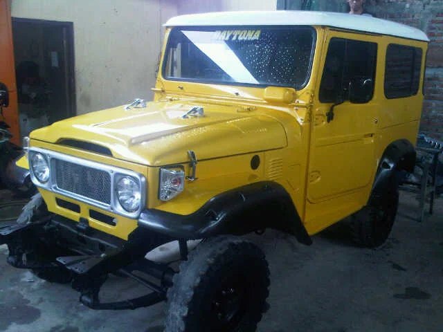

Toyota Landcruiser BJ40 Year 1982 Just repaint..not finished yet
Toyota Landcruiser BJ40 1982.
Just finished repaint.
But not finished yet to give other accessories.
Keep enjoy...your vehicle looks better than mine.
What color is yours? silver or grey?
