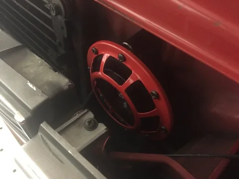

Heat shield bolts from when there used to be a heat shield....also, the springs an connection is shot here.... anyone got a tip how to get the Horns off easy?
