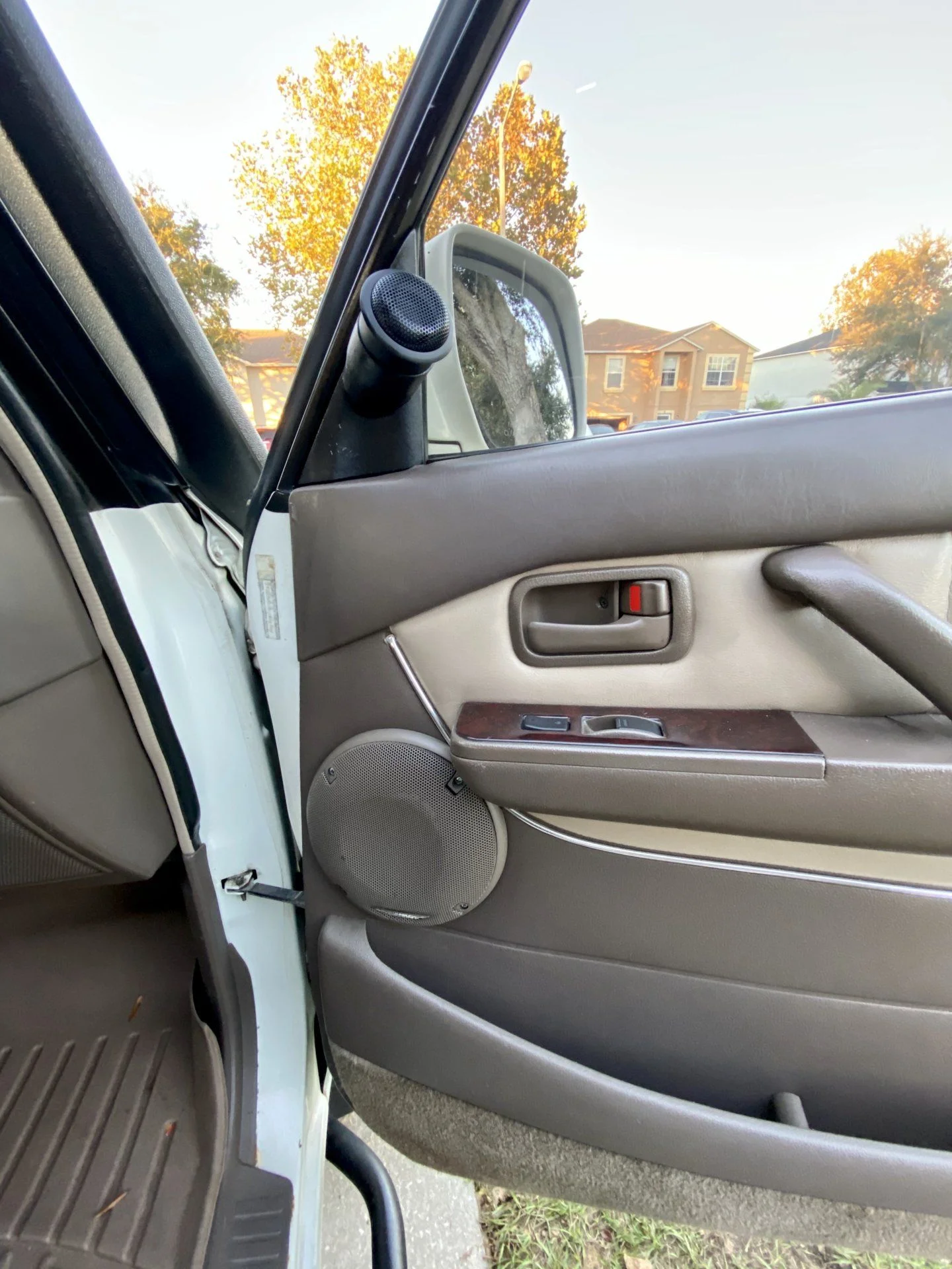

Then I started on the dash speakers. I know a lot of people get rid of these but they make a huge difference. With the right type of speakers you can hear the highs blasting from the dash vs the mids in the doors. Simple speaker swap here.
The passenger side speakers will only fit after you remove the factory amplifier that sits on the ECU
No fitment issues with the driver side

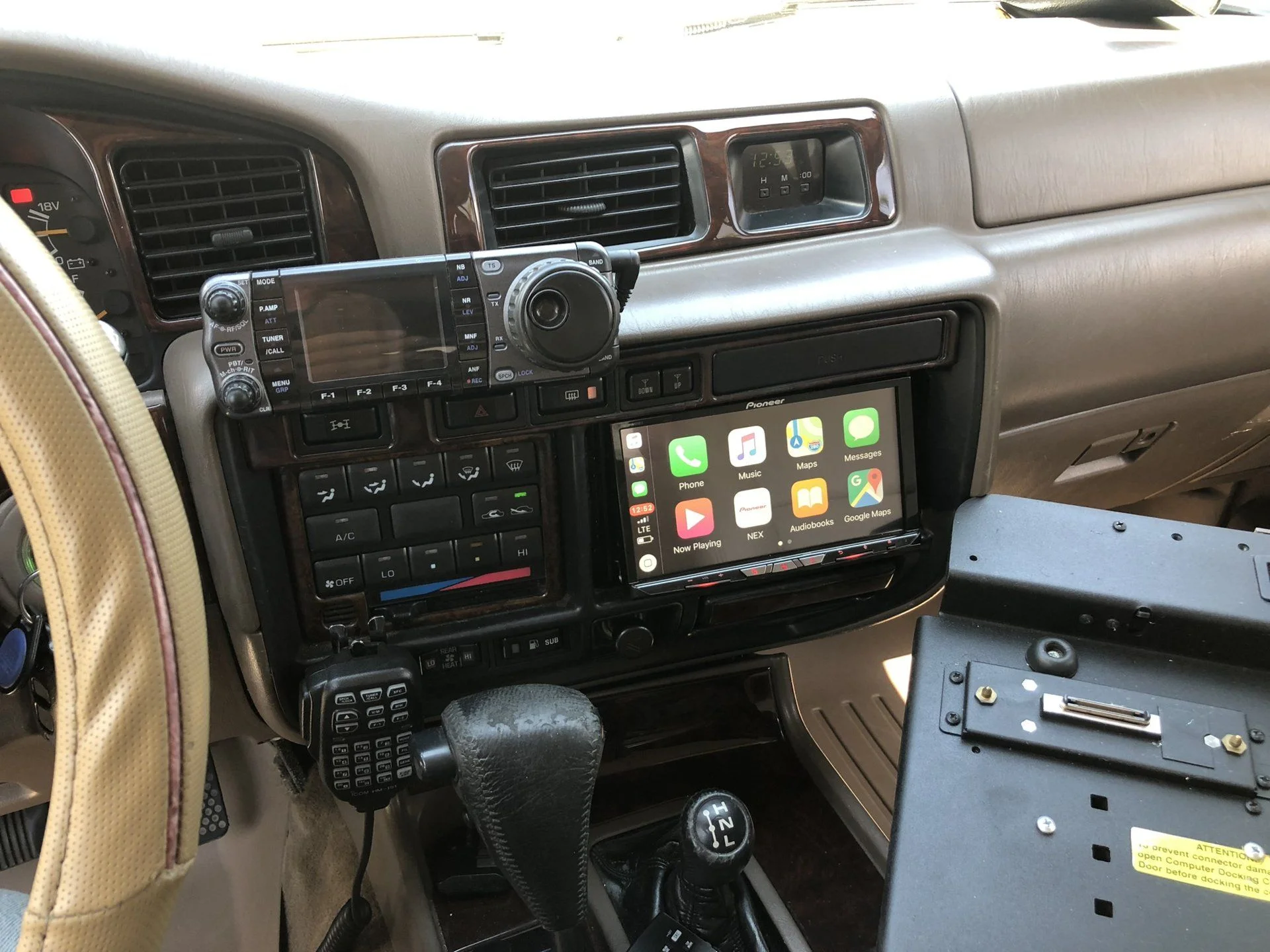

Now the head unit. This is a mech-less receiver which means it's digital only and has no CD player. This allows it to be super slim. The matching Alpine amp mounts directly behind the deck and gives a very compact package. Even with the amp back there, this package is still slimmer than your standard single DIN CD player. Having the amp behind the deck makes wiring that much easier and allows to use all factory wiring with the Metra harness.

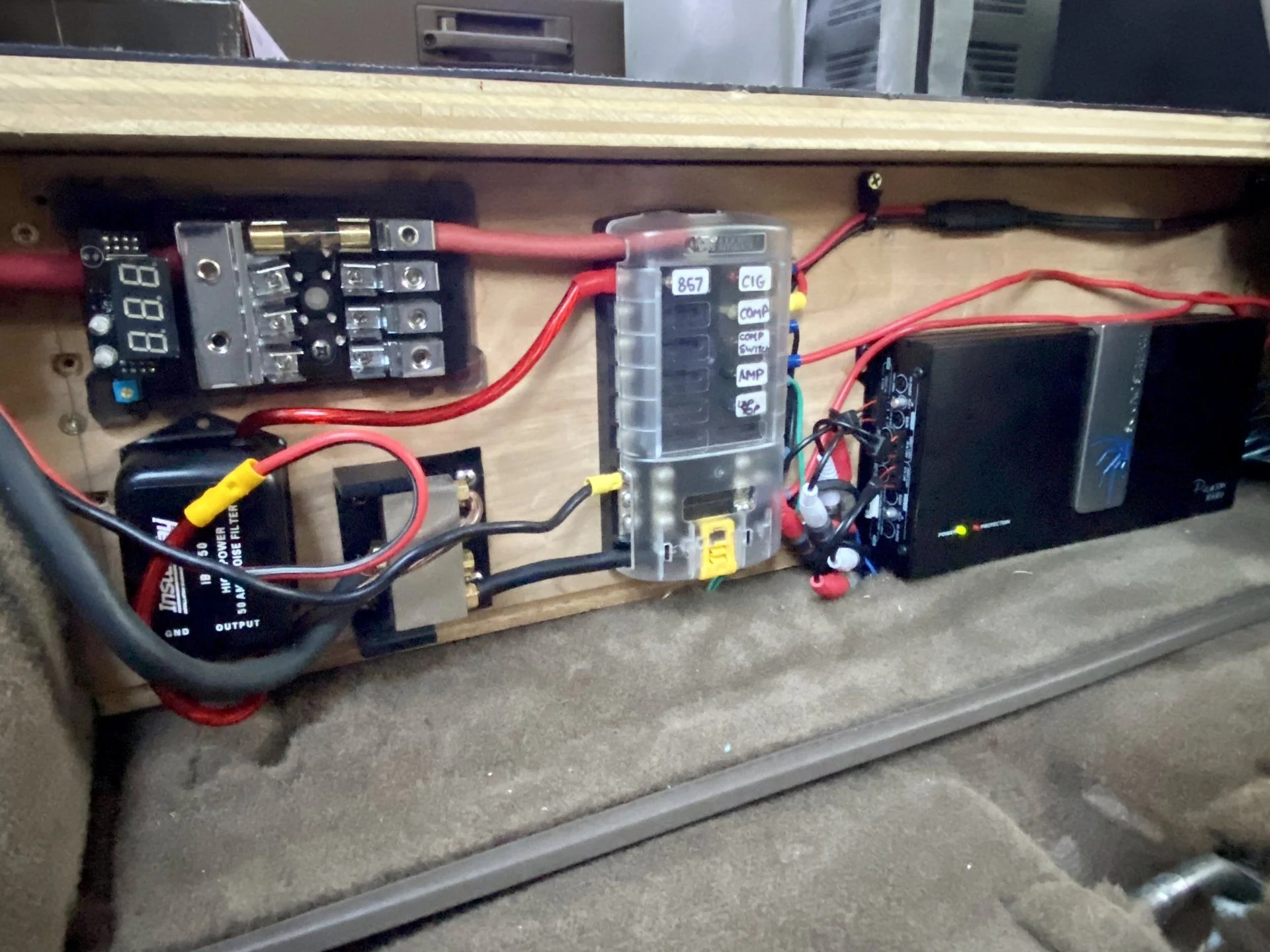

Here's the entire setup, soldered and wrapped. As you can see there are very few connections to make once you have it all wired up. The two plugs at the bottom plug into your factory harness. Then you have your subwoofer/camera inputs and power/ground for the power pack amp. Oh and the other little plug you see sticking out is for my sub's amp remote power.

The head unit itself is great. Has all the modern features and does Apple Car Play/Android Auto. I'm a huge fan of Android Auto for the various app integrations but Google Maps takes the cake. It's hard to not have AA once you've gotten used to it. I only wish Gaia would be added to the support list!

Google Maps via Android Auto.

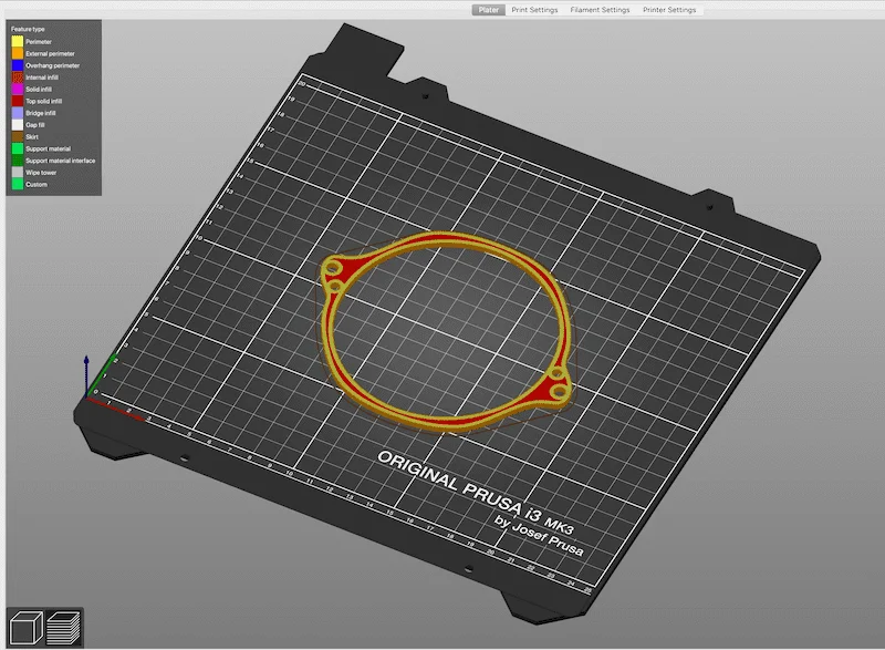

For those that want to use the matching Polk 402 DB+ 4" speakers in the dash rather than the Kickers you'll need an adapter plate as the mounting ears are not quite long enough to match the factory mount spacing.
I can also confirm the Polk's DB652's clear a '97 door brace just fine as long as you top mount them and don't try to retain the factory grills.
Mounting bracket STL can be found here in 24 hours (thingiverse wants me to wait 24 hours before publishing ) :
