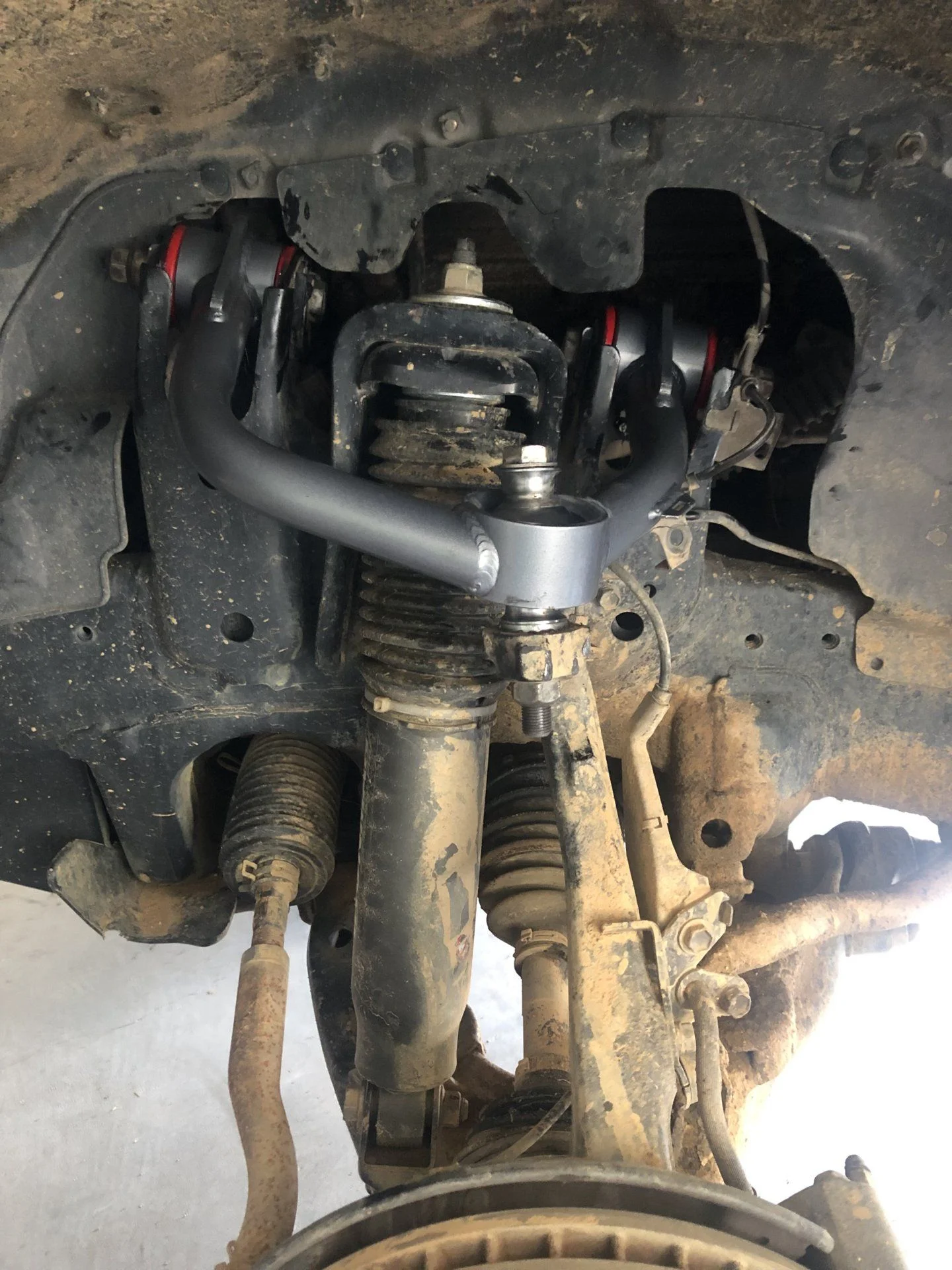

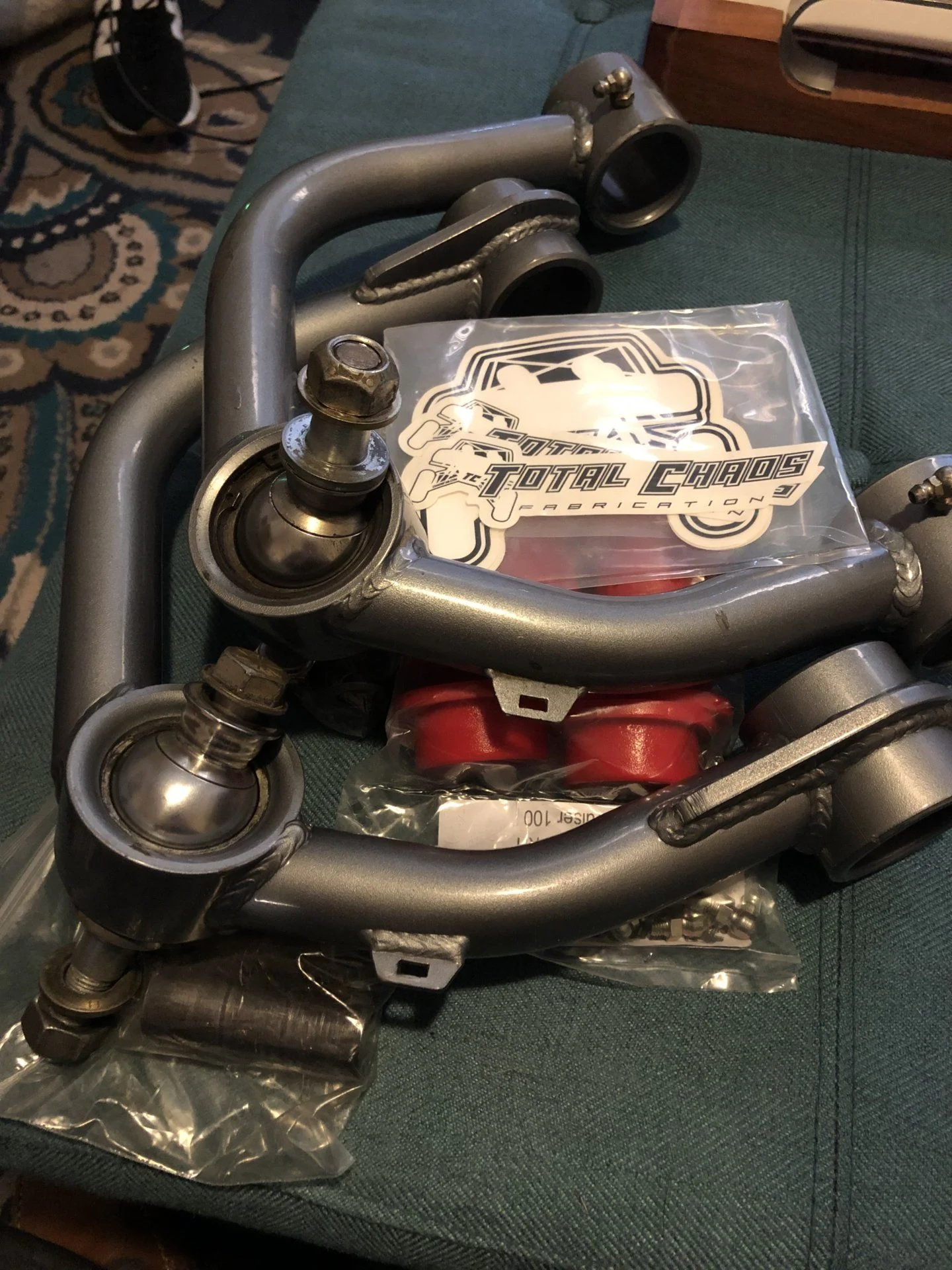

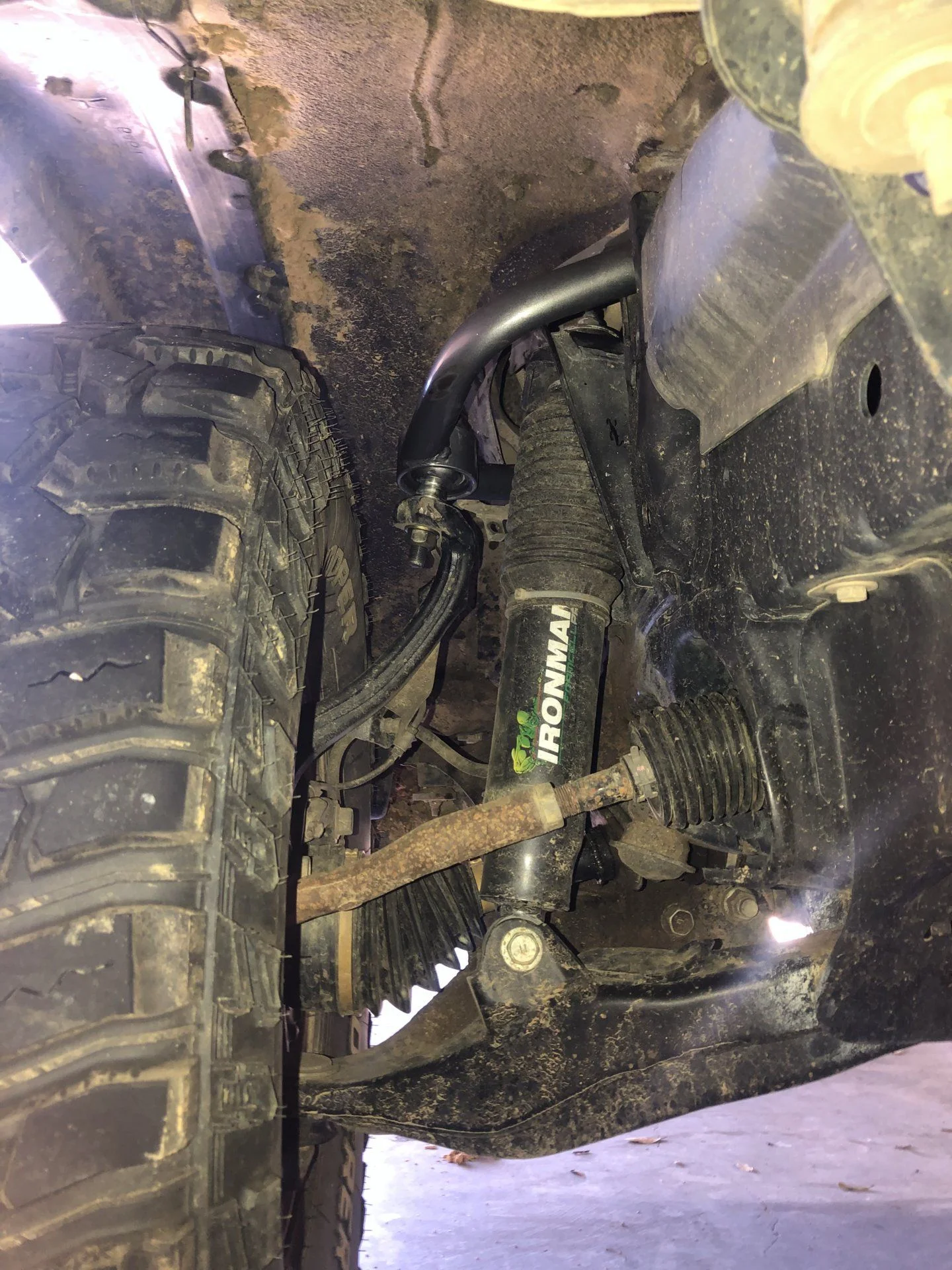

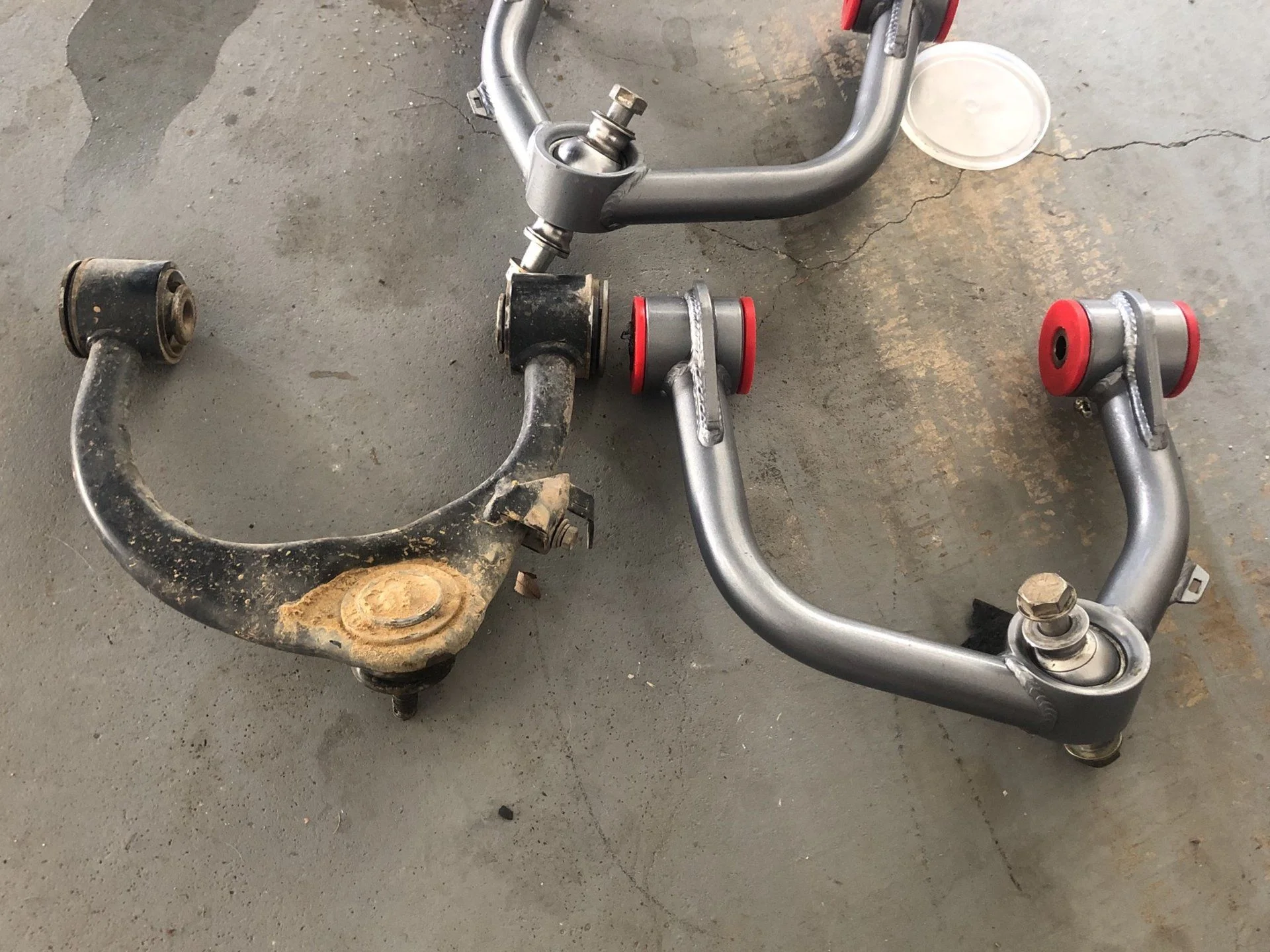

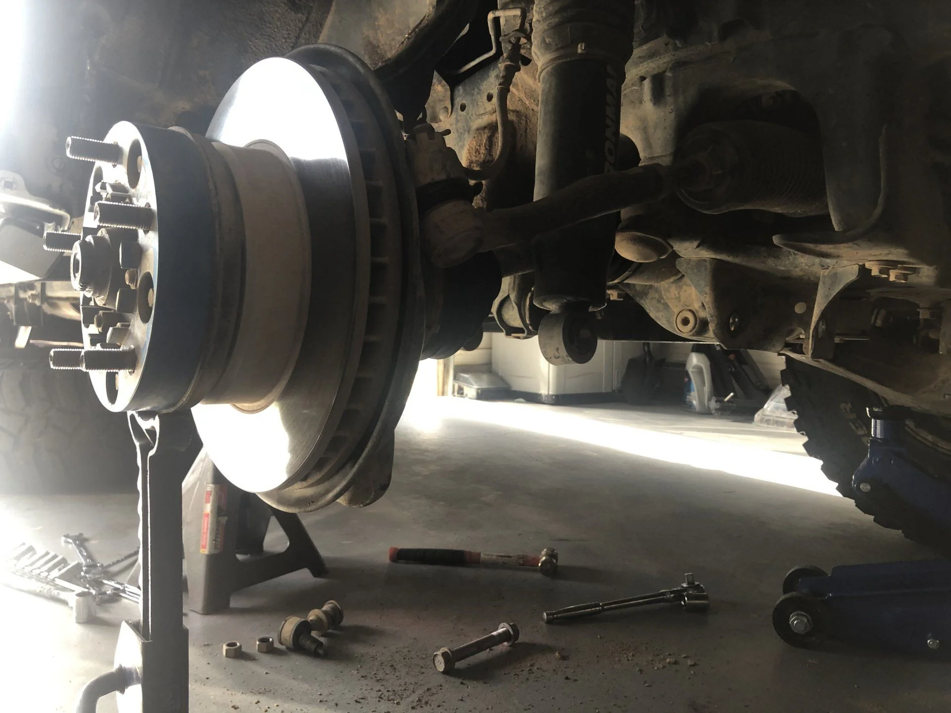

Got my TC UCAs on yesterday using their instructional videos which were super helpful. When pulling the eccentrics to swap the UCAs I could then my alignment tech had to push the front eccentric all the way out and the rear eccentric all the way in to artificially get some castor. This explains why my bushings have been creaking lately.
I reinstalled the eccentrics with the new UCAs and just installed the front one all the way out and the rear one at neutral, assuming that I didn’t want to bind the bushings. As it turns out I really needed a set of UCA’s because it forced so much positive camber the truck was almost undrivable, as in the front view of the truck looked like this \——/
Luckily to adjust camber (at least from the UCAs) you really don’t even have to pull the tires on a 100. I turned my eccentrics to the 1-2 o’clock position, or 3/4 of the way to the innermost position, and this turned out to be a really good eyeball alignment. I still need to install my LCAs and get a professional alignment, but I am not DDing the cruiser right now so I have time.
Overall the ride is much better. I can tell you after pulling them that my upper ball joints were toast. I can feel how much the steering shored up. I do have a lot of visible play in my lowers so replacing those will be amazing. The steering at low speed feels more or less the same. Steering at any real speed, the wheel centers it’s self much better, wheres before is was just kind of floaty. My steering has been tight since I did my column and tie rods but the wheel feel is much more similar to stock.
In addition these are fully tubular with a 1” uniball, and I can tell you now, if something in my front end is going to break, it’s not these. My front end is pretty much maxed out on height, and you can see how comfortable these ICAs look at neurtral as compared to stock. And, while these don’t add articulation, they certailinly take away some stress from the front end at these lift heights.

The truck tracks soooo much better on the highway, way less wander. Just need to replace my LCAs with OEM replacements and my front end will be tight!

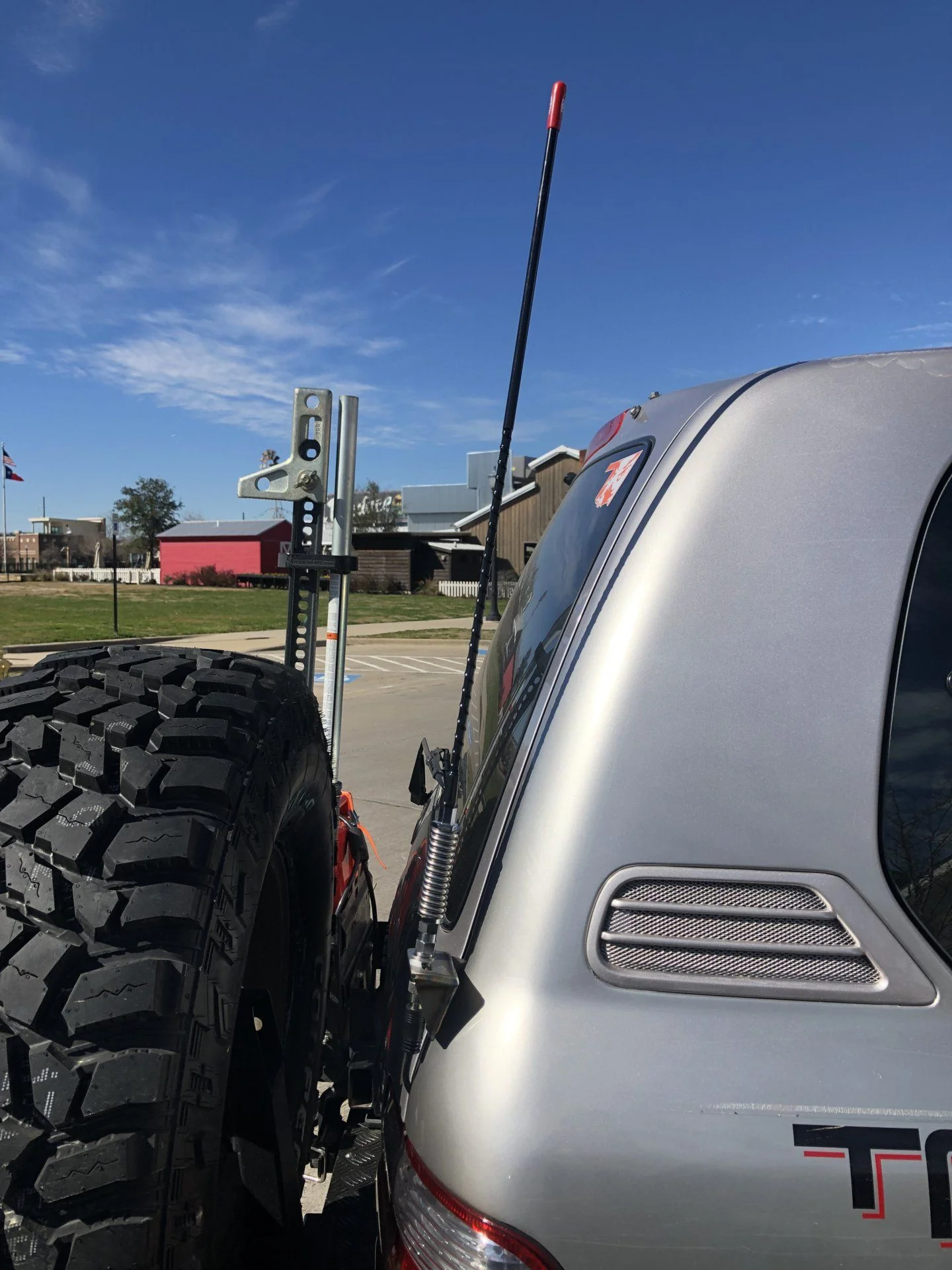

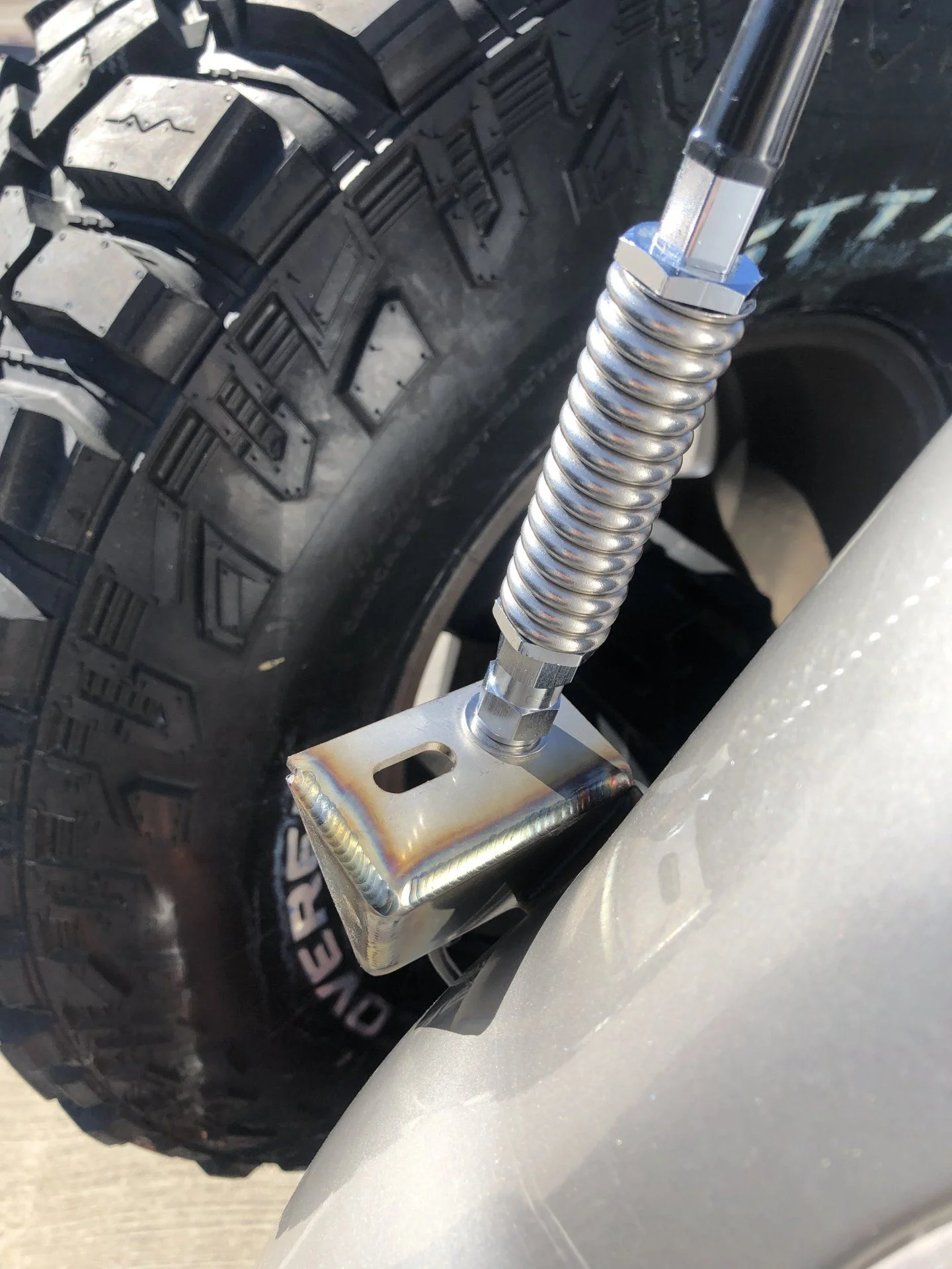

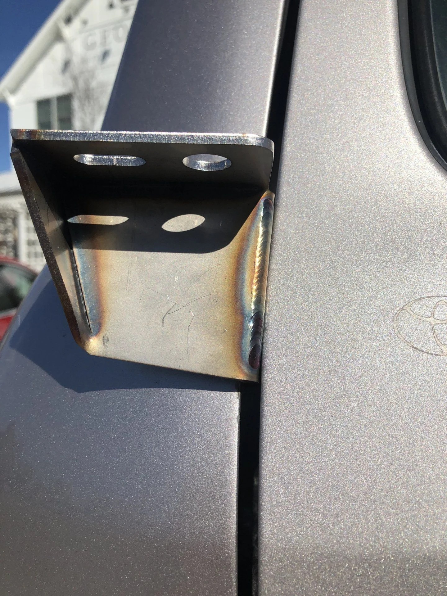

I installed my @TRAIL TAILOR rear hatch light/CB tabs. Still need to get some 2” LED pods to throw on but my 24” andtenna and spring mount perfectly to the passenger side tab.

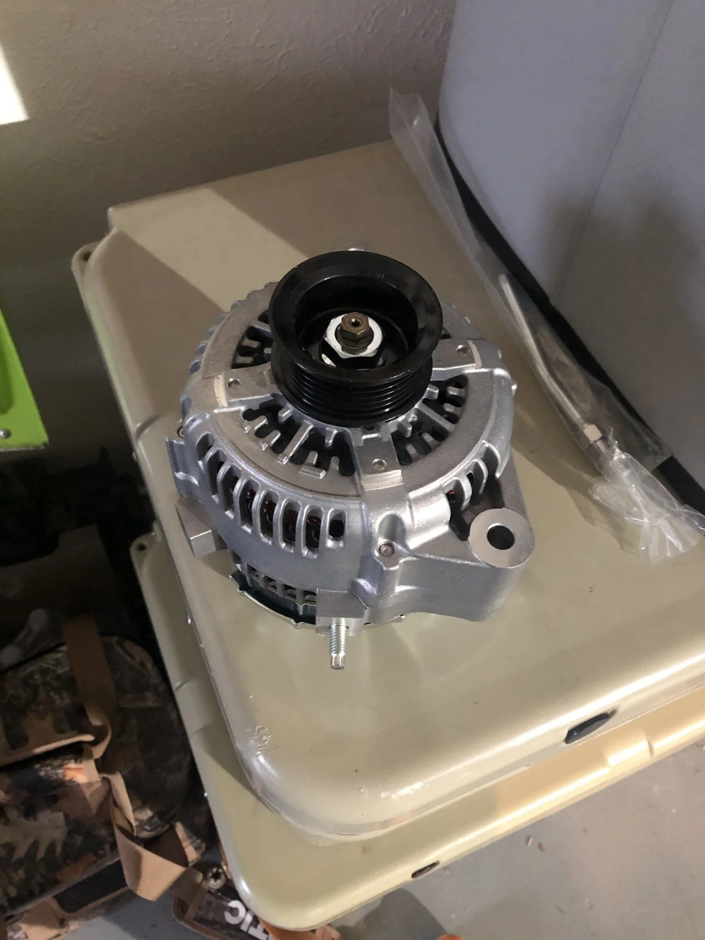

2. I have seen since I got this scangauge that if I let the truck idle my voltage slowly dropped but came back with engine rpm. Never caused electrical or starter issues ever, except one time last summer I was on the tractor planting a good plot and left the car idling with AC on. I came back to a flickering radio and gauges. I drove a quick lap and voltage was back. Well on Thursday my alternator completely died on me, but again scangauge made this an unbelievably quick diagnosis.
I was beyond lucky that Toyota of Dallas had the alternator on the shelf for ~$200 plus a $75 core, which I returned the same day. There’s a big thread on it and some people made it sound like a 2 banana job, IT IS NOT AN EASY JOB. I think the 98-99 models came with an 80 amp alt that is physically smaller that the later model 100 amp alternators. That’s makes the job significantly more difficult. The power steering pump needs to be unbolted and pushed out of the way (this isn’t inherently hard), and squeezing the alternator out and back in is a huge pain.

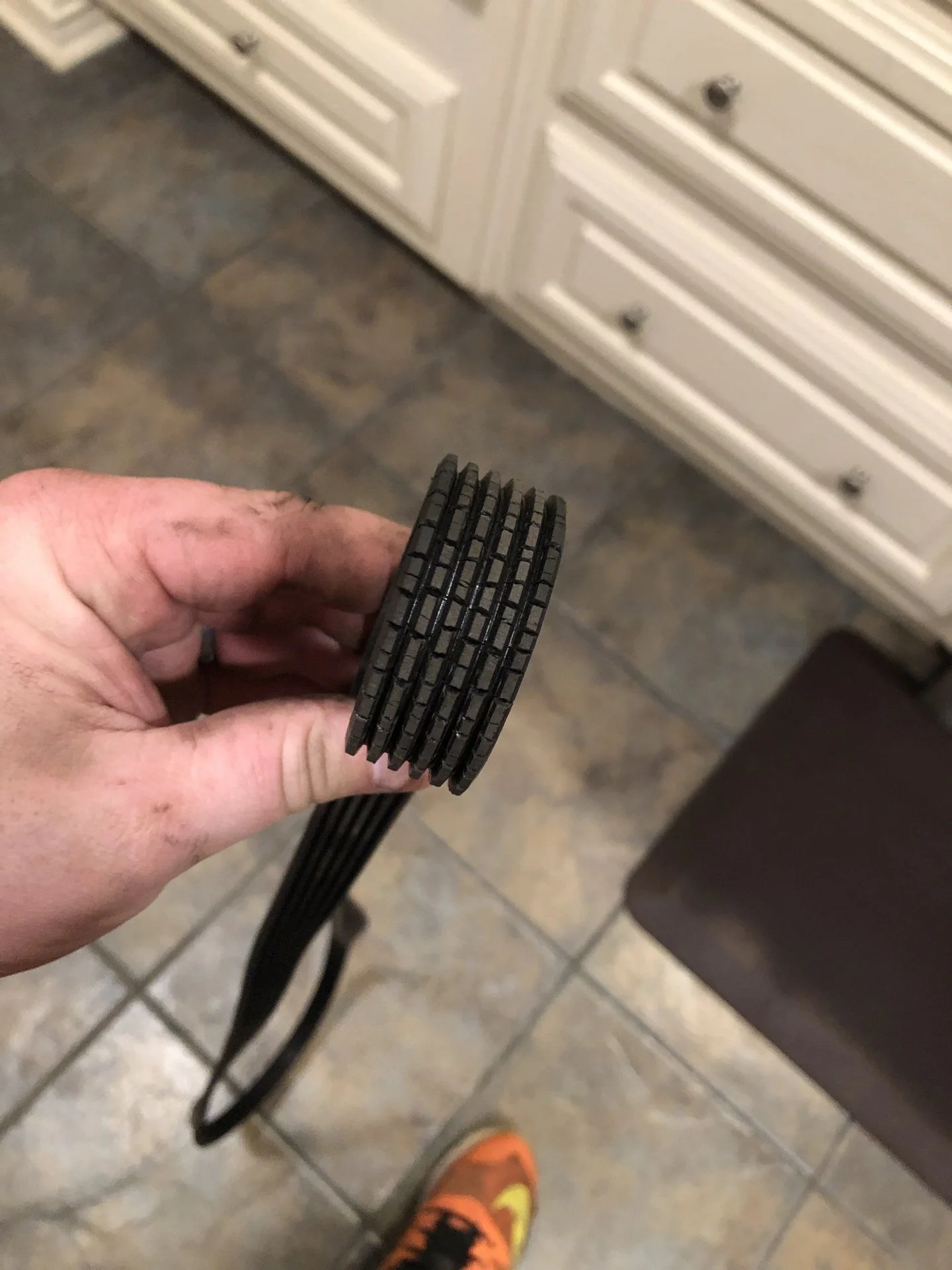

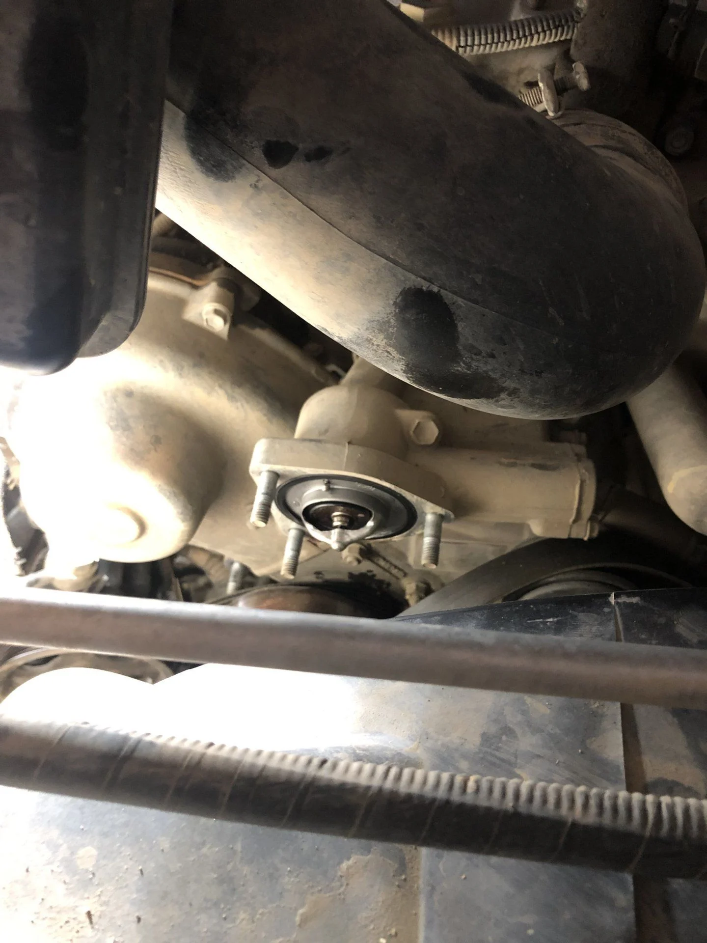

My serpentine belt was super cracked and dry when I pulled it to unbolt the alternator and PS pump. No problem, I had to drain the coolant to pull the lower rad hose and pull the alternator so I needed coolant at Toyota anyways. ALSO was a good time to do my thermostat which has not failed but I know is sticky.

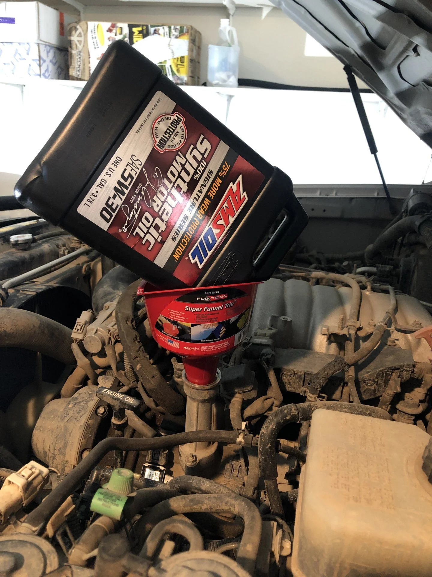

Also did an oil change with my usual amsoil and Toyota filter and a fresh drain plug washer.
Got it all put back together and filled up and immediately showed adequate voltage 13.8-14.2, I had no more chirping or squeaking from the engine bay. (I inspected my pulleys and they all spun great and my tensioner had plenty of life left). My AC clutch would squeal some when it engaged and that is all gone. I have also been chasing a hum that comes with engine rpm and it must have been my alternator because it is long gone. Overall the truck is purring better than ever and I’m very happy with the outcome because that alternator job was a PITA!!

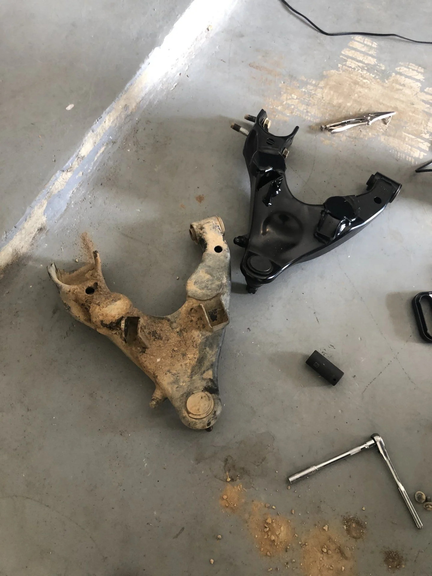

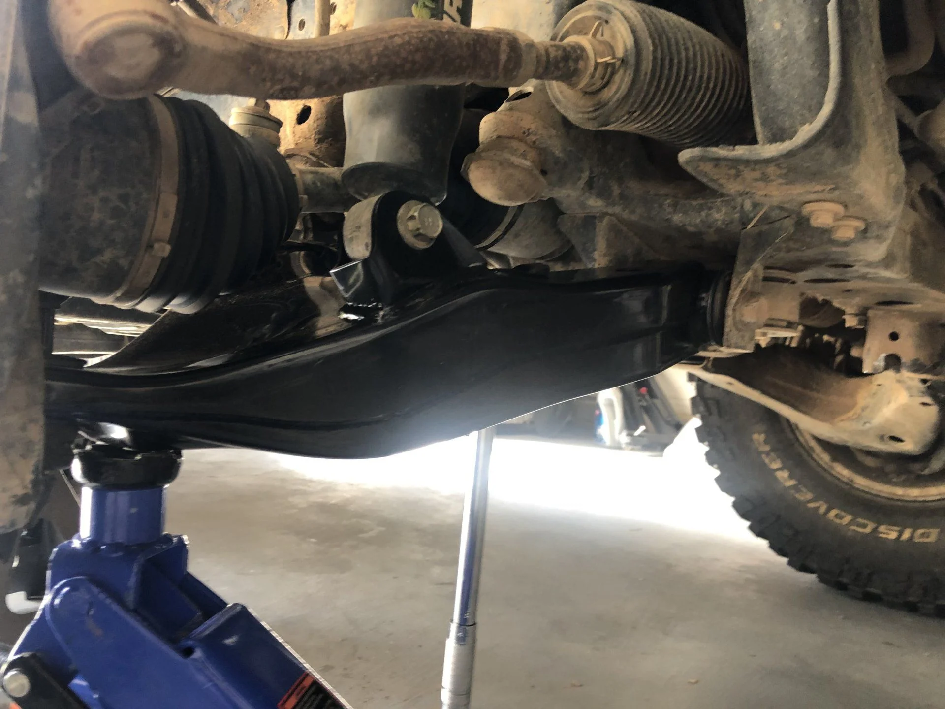

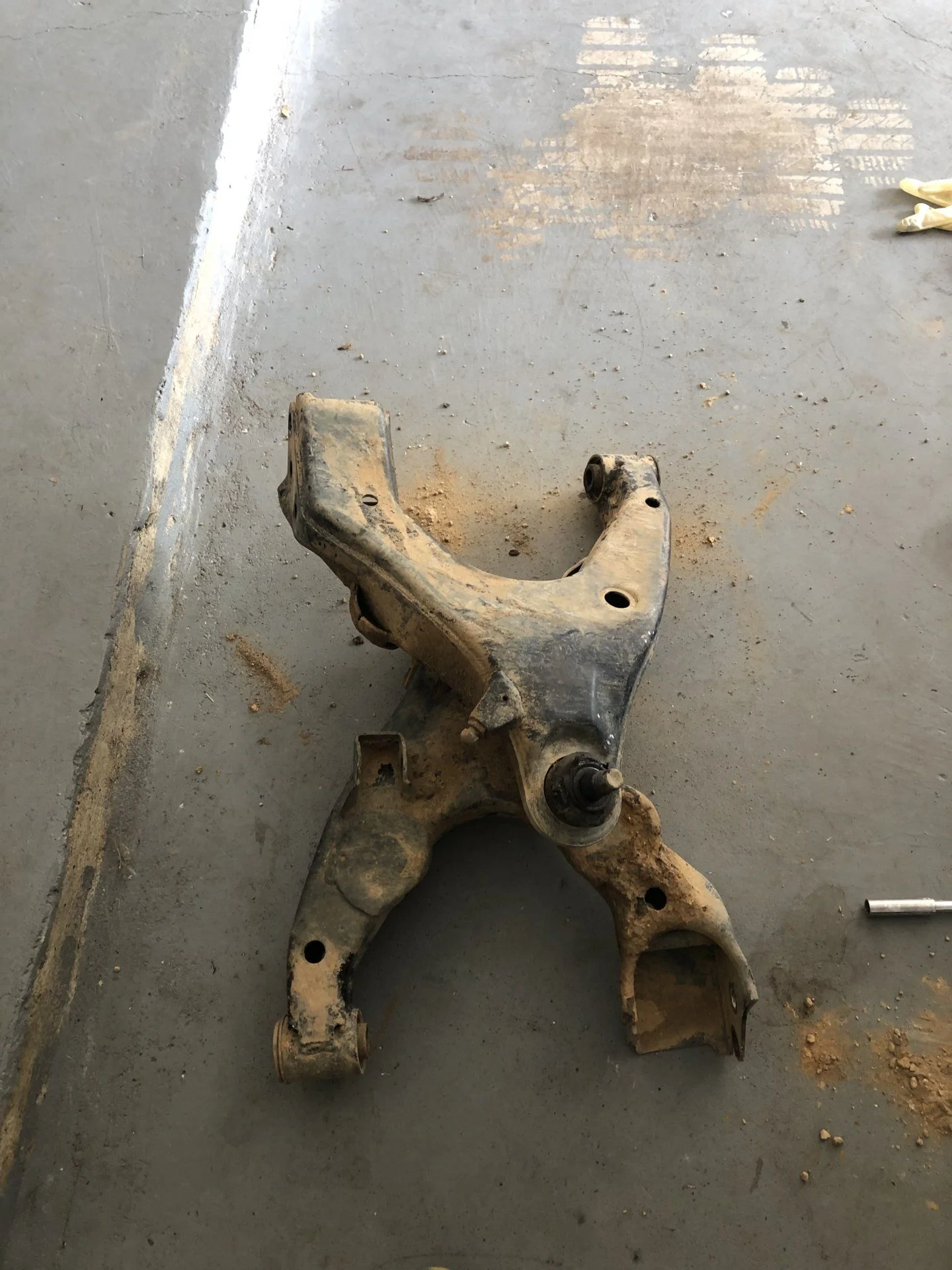

I needed new lower ball joints and opted just to get whole new lower arms. This job wasn’t terrible, just a lot of steps since you have to remove the torsion bar torque collar, lower shock, sway bar end link, etc. I have done my tie rods, UCA, wheel bearings, and all and I can tell this by far made the biggest difference. Haven’t even had it aligned yet and the truck is tracking straighter than ever. Most importantly all my clunking is gone. Really happy with this job.
