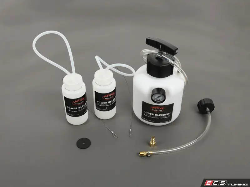

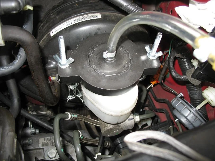

No, the Power Motive system pushes the fluid from master to bleeders. SOP is start (or start again in your case) from the furthest cylinder (pass rear). Pressurize master then go to the back and open bleeder.. watching for bubbles. Then work your way through progressively closer wheel cylinders. It goes fast! You can go through a lot of fluid so keep checking reservoir.
For the Landcruiser I use the Universal Round master adapter below (you pick when you buy, I also have a screw on one for German cars) I use their catch bottles cuz they came in my kit; but you can also just use what you have.
Once you use it, it would be hard to go back. It also makes it super fast to “change” brake fluid when it gets old n dark (usually with water molecules entrapped)
