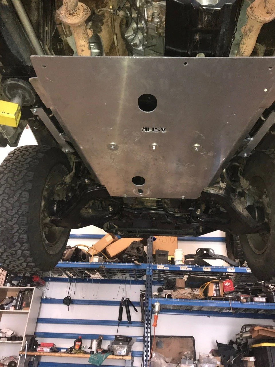

I'm not sure if these photos are mine to share, but just to give you an idea of what the coverage looks like. Keep in mind, these are prototypes and they are not fully installed in this photo. I'll post better photos when everything is completed.
Looks pretty good in that one picture. If they price them aggressively (as before) and don't have stupid wait time /out of stock issues like a lot of other small vendors seems to suffer with, I am definitely planning to buy the two rears to go with my front.

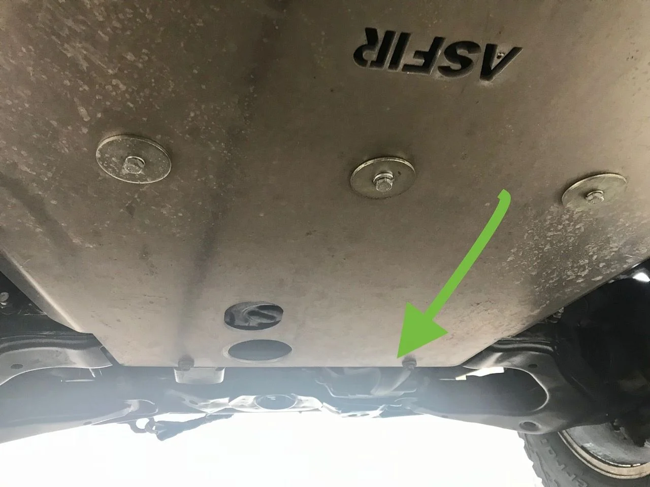

I've contacted ASIR and Leonard said the front skid plate is un-changed as it has always worked with the Diesel and Petrol versions.
Can you confirm this front skid plate is long enough so that it covers the front differential?
Maybe I just need to move the transfer skid plate forward? 9I tried to line the holes on the skid plate with the captive nuts on the provided cross brace, maybe I just have to drill some hole towards the rear of the plate)
Thanks for the photos. I now see that I just need to move the transmission skid plate forward, so that it covers the front diff. Currently, as it sits, it protrudes to the back of the transmission crossmember and even covers a little of the transfer case (see on the pics I posted above) I just tried to align the holes that where already drilled on the plate with the captive nuts on the provided skid plate cross member, but I guess I need to just drill new holes.
Front skid reaches the end of the diff cross member.
