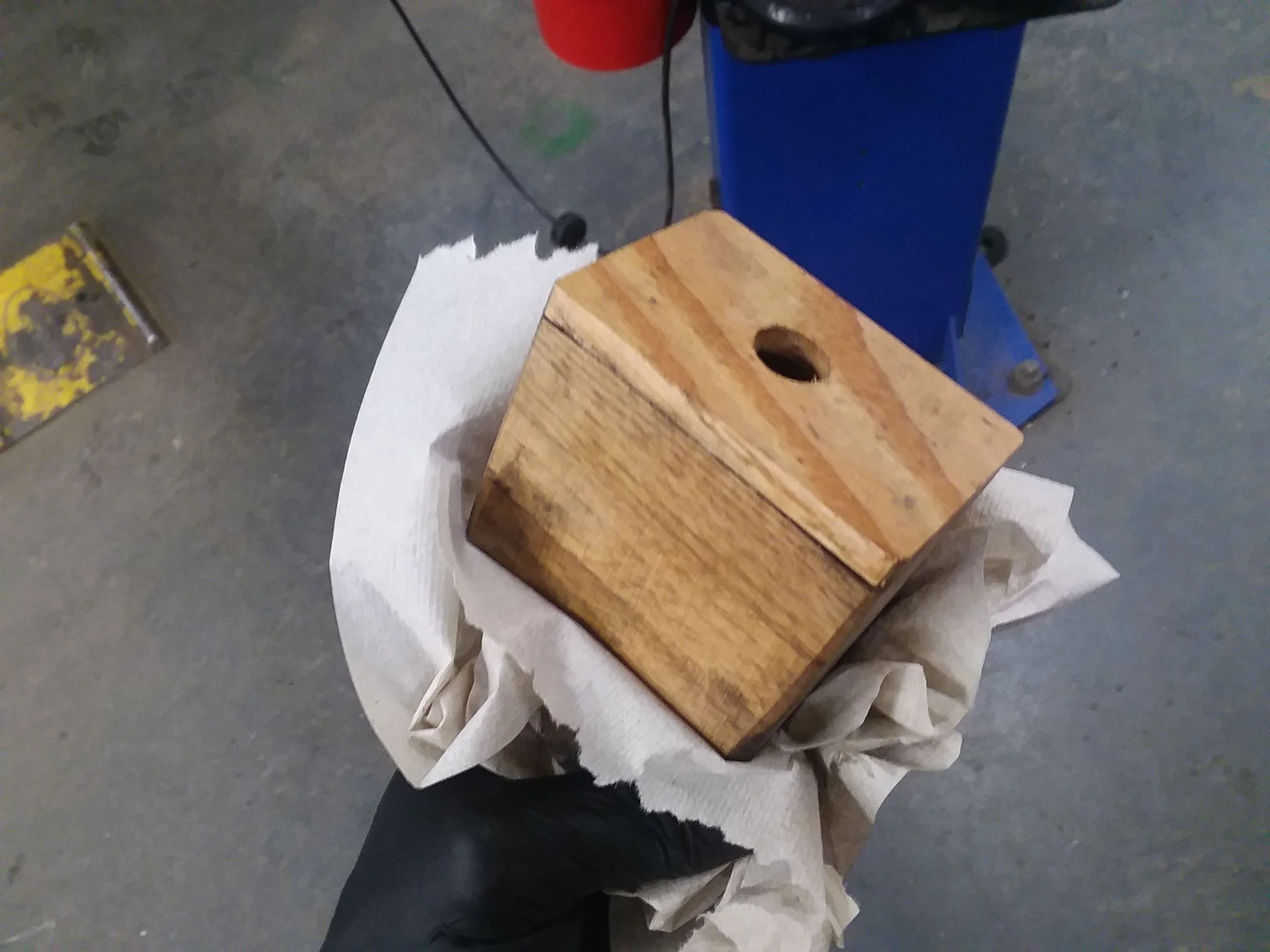

For those adding the middle skid you may want to increase the front center support by 1/4" to make up for the overlap with the middle ( I added a wood block to the tube and just added .25" more wood).
Oh, and figure out how you are going to jack/lift -the pads for the lift I use just squeezed into the right spot.
