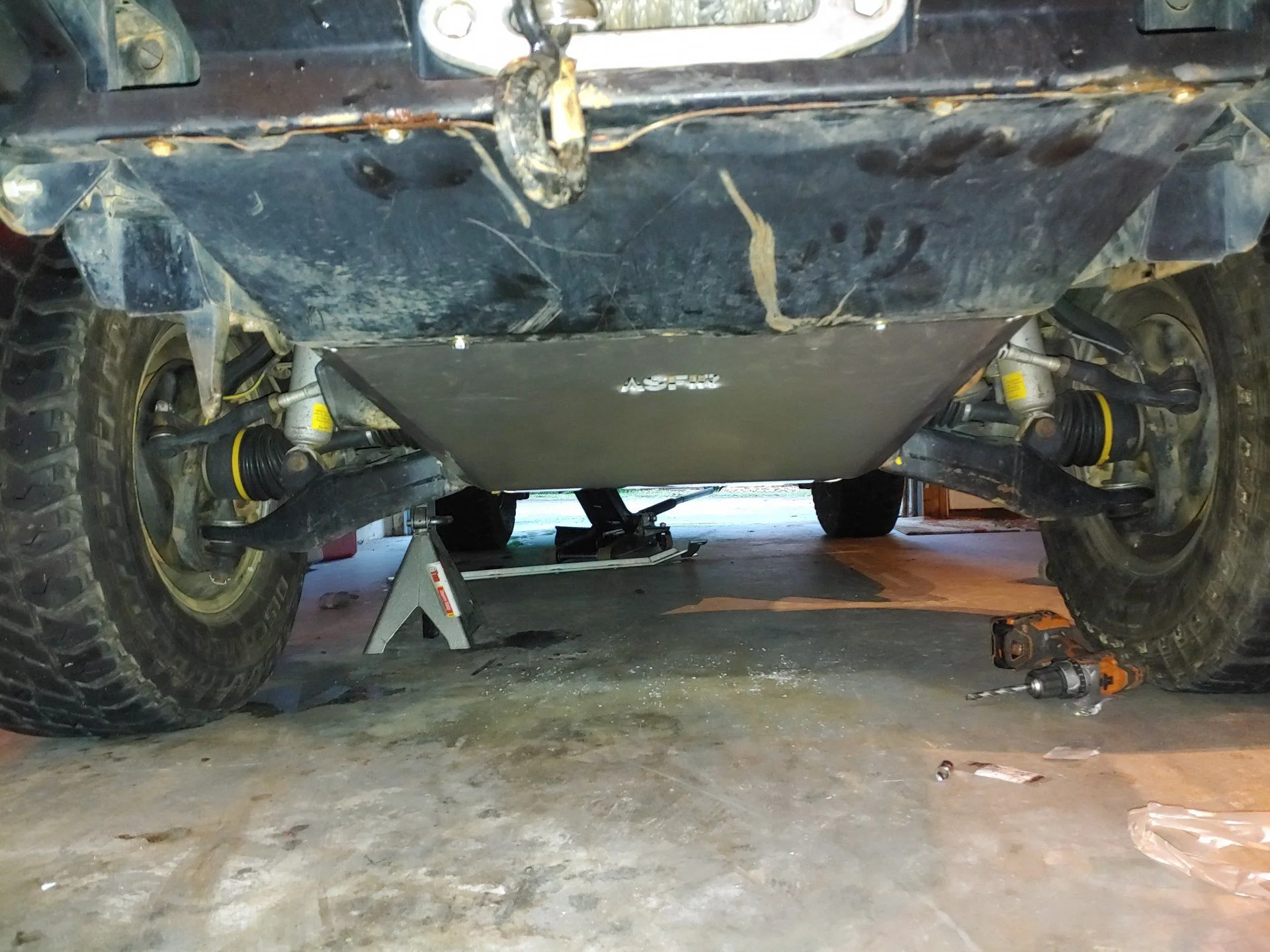

@ClassyJalopy was there any kind of modification needed to fit the front skid with your ARB?
I installed the front before I even had the ARB and all I had to do was to elongate the front and rear holes slightly to make it easier to install. Also, I remember having to buy a little longer bolt for the center mount. But since then I have installed a TT diff drop and have decided not to bother running the center mount bolt at all :meh:

I already installed the front a few months ago and like everyone else, I did need a longer center bolt. I'll get it installed tonight.

I did get the front skid on. As mentioned, leave things loose until the bolts are all in place. For the ARB, I did need to trim the most forward tabs at the top of the skid to clear the ARB's bottom cover. No biggie. With the trail tailor diff drop, there was a little warbling needed with a drill to get the holes of the skid lined up. Just about 1/8" short rearward.
So, so far, a little more than just bolt on but I like the product. The construction looks good and the plates are stout for sure.

I have a ARB bullbar with ASFIR front skid and @TRAIL TAILOR diff drop. Here's what it looks like:
I see you went over the ARB plate with the Asfir. I went under. 🤔
