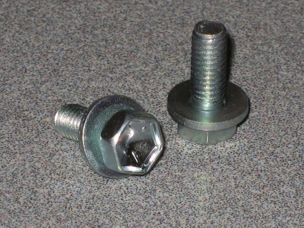

Pretty hubs indeed. Why'd you paint the bolts? Those are still available from Toyota.

Have a good p/n for that specific piece of hardware? (lockout dial bolt, with flat washer)
I was told two years ago that they were disco...

I believe you are right. The real correct ones have a '7' strength mark on them. They are superseded by the ones I got which do not: part number, 91641-80616
Installed, and looking at this pic they don't look to have the washer. I'm going to have to go pull one off and have a look.
