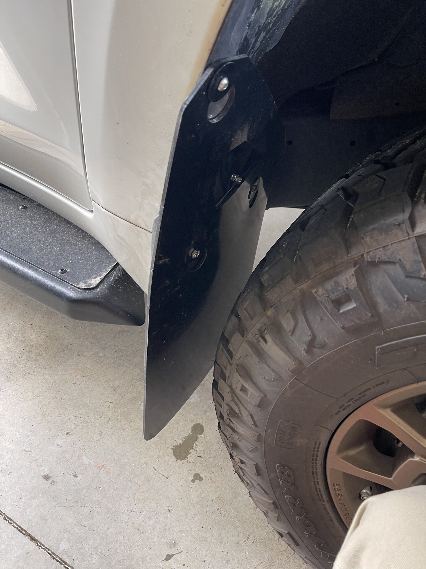

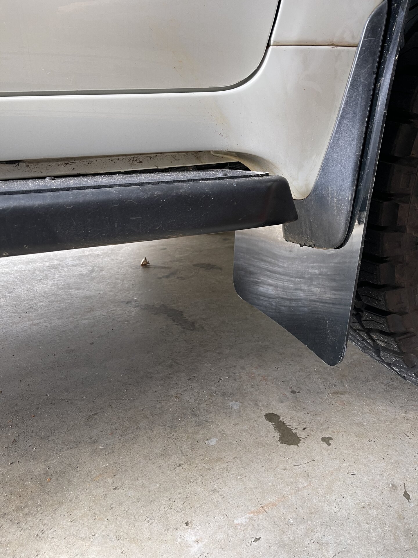

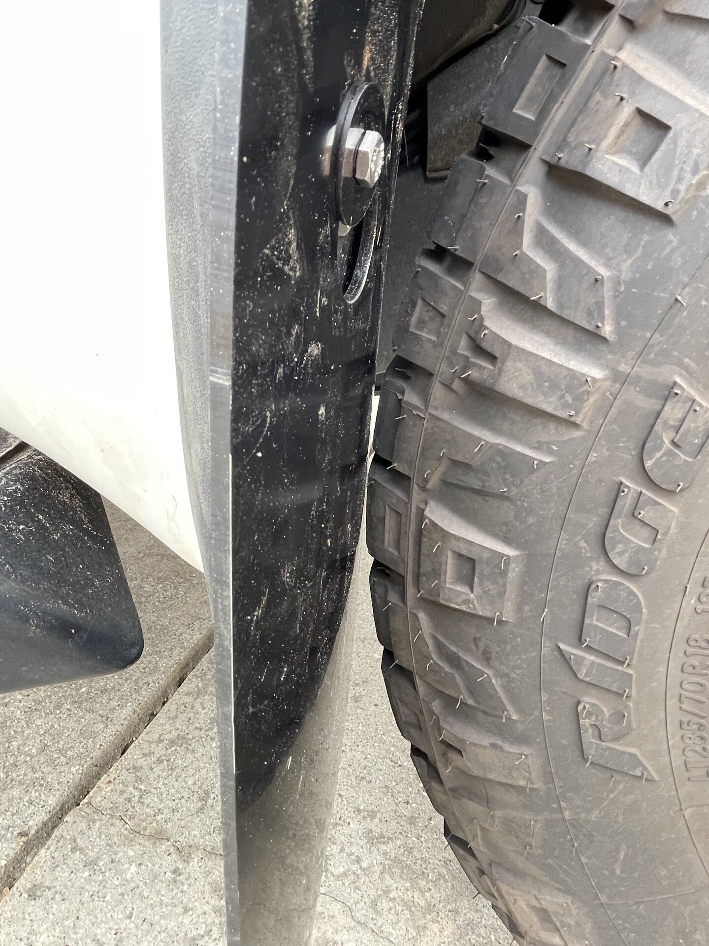

Finally had the time to get the fronts installed. I had enough time to piddle around with the brackets and retain the stock flap. It’s super close and may rub a tiny bit close to full lock but at that steep a turn I will be going slow enough to hopefully noticed any accidental removal. One thing to note if you’re having to bend the mounting bracket, it can end up bending enough to make the flap retention screw not engage very well.
All in all I’m happy with the product, my main goal was to cut down on mud and I don’t see how these won’t accomplish that.View attachment 3218041View attachment 3218043View attachment 3218042

Thanks for sharing! Just want to point out, for those that may just see these photos, that these flaps are not intended to be installed over the existing flaps. If I recall, you kept your stock flaps on because your paint protection film doesn't cover the area under the stock flaps.
Not having the stock flap under would provide more tire clearance and prevent needing to bend the bracket more. Also, if the bracket does need bent and the retention bolt isn't hitting, you can remove the bolt and bend the tab down. It will extend further than the head of the bolt did and further prevent an accidental release.
Yes, this is all accurate.
The amount of room lost by retaining the stock flap isn’t very much but in a game of clearance even a 1/4 inch can make a difference.
