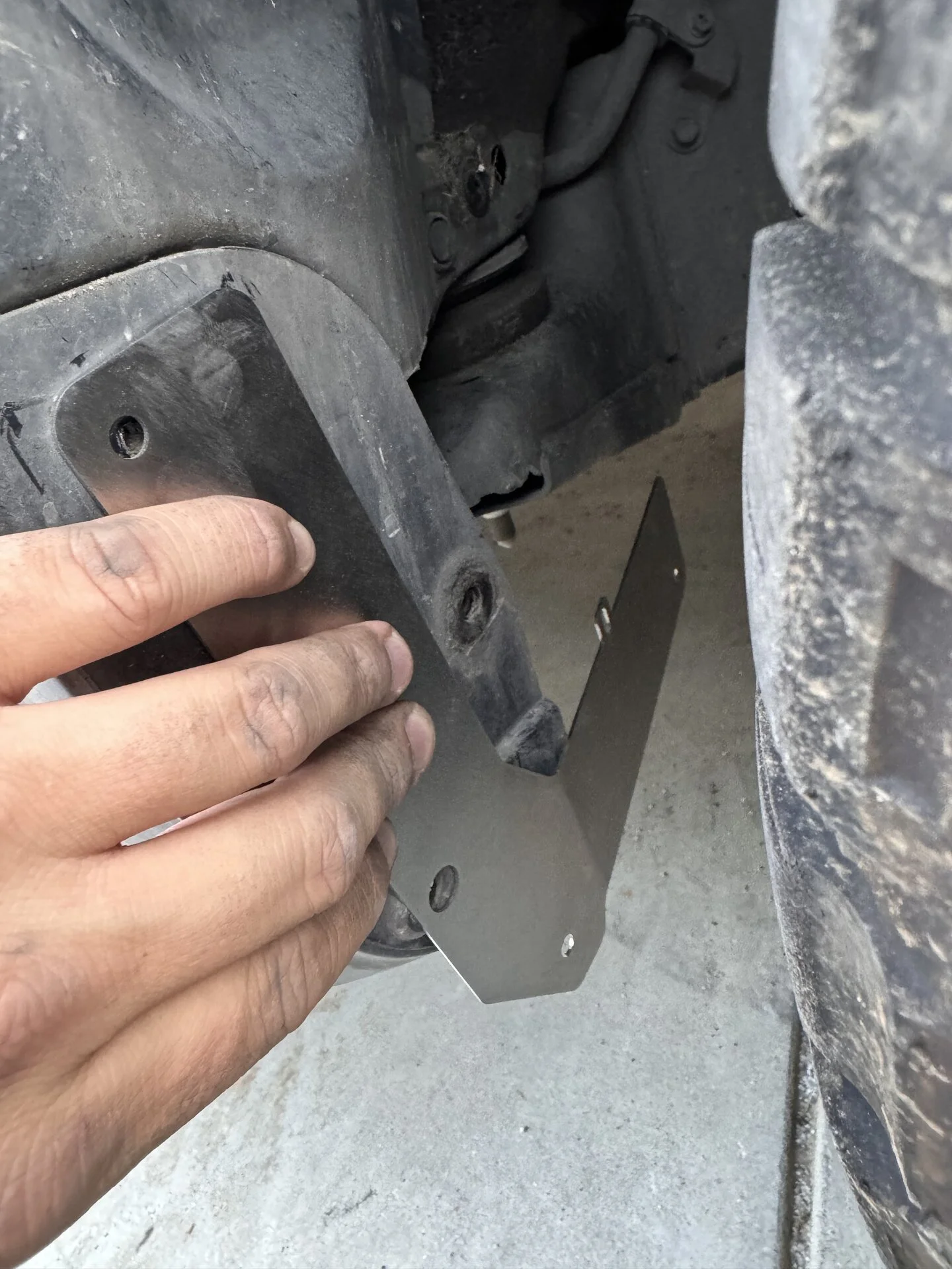

So did I **** up? I got my flaps and the parts but quite a few bolts don’t seem to fit in the LX570. Most of the holes are too small for the bolts that were sent. I can use the stock bolts but that doesn’t seem like it’ll hold the flaps then.
If I remove this piece I won’t have enough nuts to tighten the bolts.
The install photos don’t match this at all either. This will easily break off.
I’m so confused why it says it’s LX570 compatible.

Hey! Sorry I didn't see this earlier. I responded to your email last night. Hopefully we can figure it out. Not sure about the fronts from your photos, but in the rear, the factory inserts need to be removed and the extruded nuts used.

Hey. Sorry ended up seeing it late last night. Will give it a shot again after lunch. Makes sense about the rear. I’ll send you some more photos of the front and what you suggested in the email and go from there. Report back later!
would someone be able to hop on the phone with me to help. I’m so lost. Nothing fits with this kit and the LX570. Photos don’t match the install.
I’m having to force everything to the point of panels making cracking sounds.
Don't break anything. I'll get with you via emails and we'll figure it out. There may have been a change in the LX that I'm unaware of. I'll email shortly.

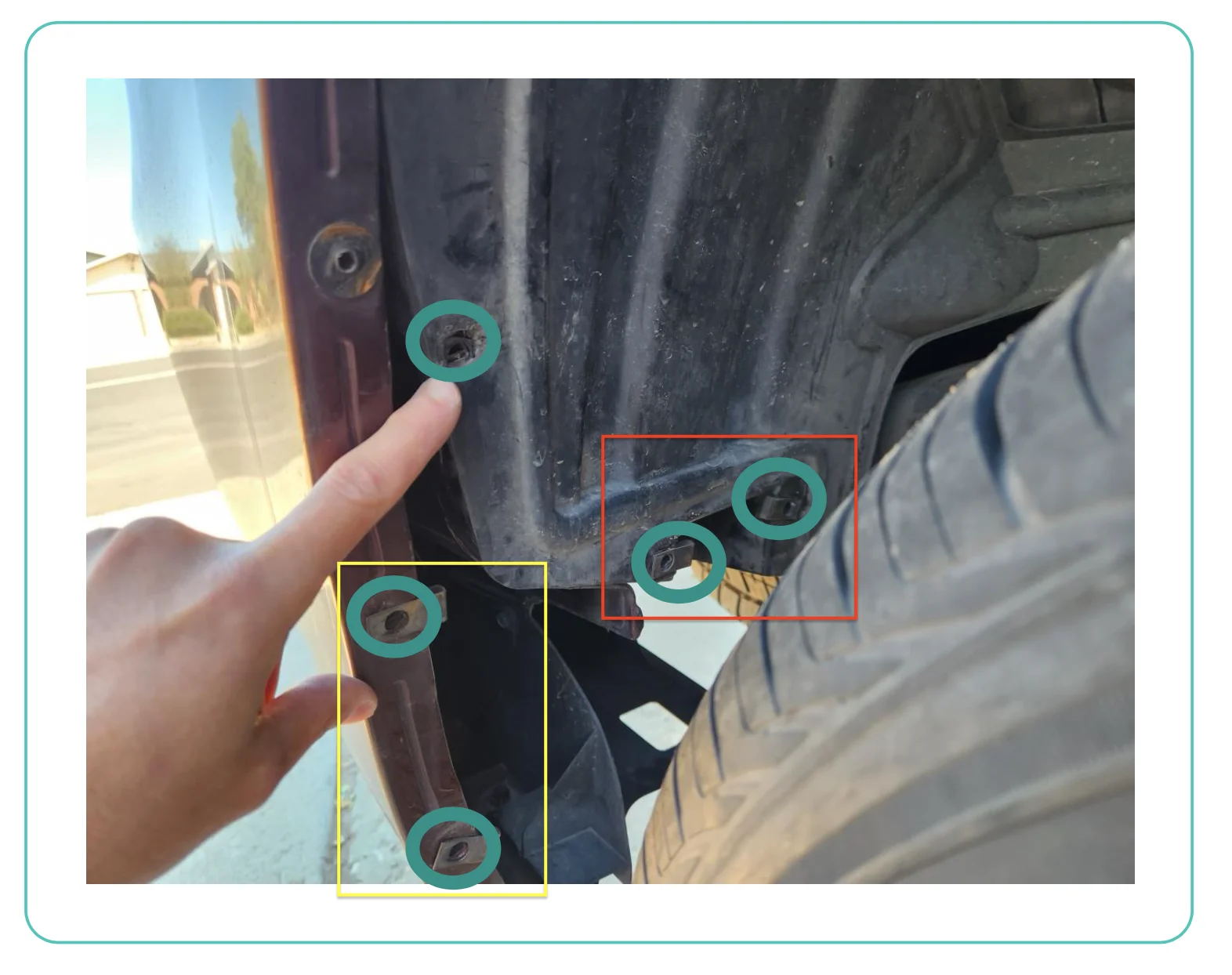

I did the driver's side yesterday. Today I did the passenger side. Mine is a 2021 LC, and there must have been some minor changes since whatever model you developed these on. No biggie, but differences from the instructions.
On the attached image from step three, you tell us to remove the plastic inserts. However, on mine, the hole marked in yellow do not have inserts, as these fasteners are the type where you pop out the center pin and pull out the whole fastener. This is the case on the other side, too. So these were easy. The two in red, however, are steel threaded clips, not plastic. And the thread in them is too small to accept the 1/4" screws that are included with the kit. They are easy to remove, but installing the plastic extruded nuts is a different story. The nut side of the plastic extruded nut is too large to fit through the small slot previously occupied by the steel nut. So the back side needs to be snipped larger enough to accept the plastic extruded nut. Again, not a project stopper, but a pain to get any snips in there to open the slot.
All done now. Not difficult, just some minor bits of confusion once I got into it. These will definitely help protect the trailer! Thanks!
