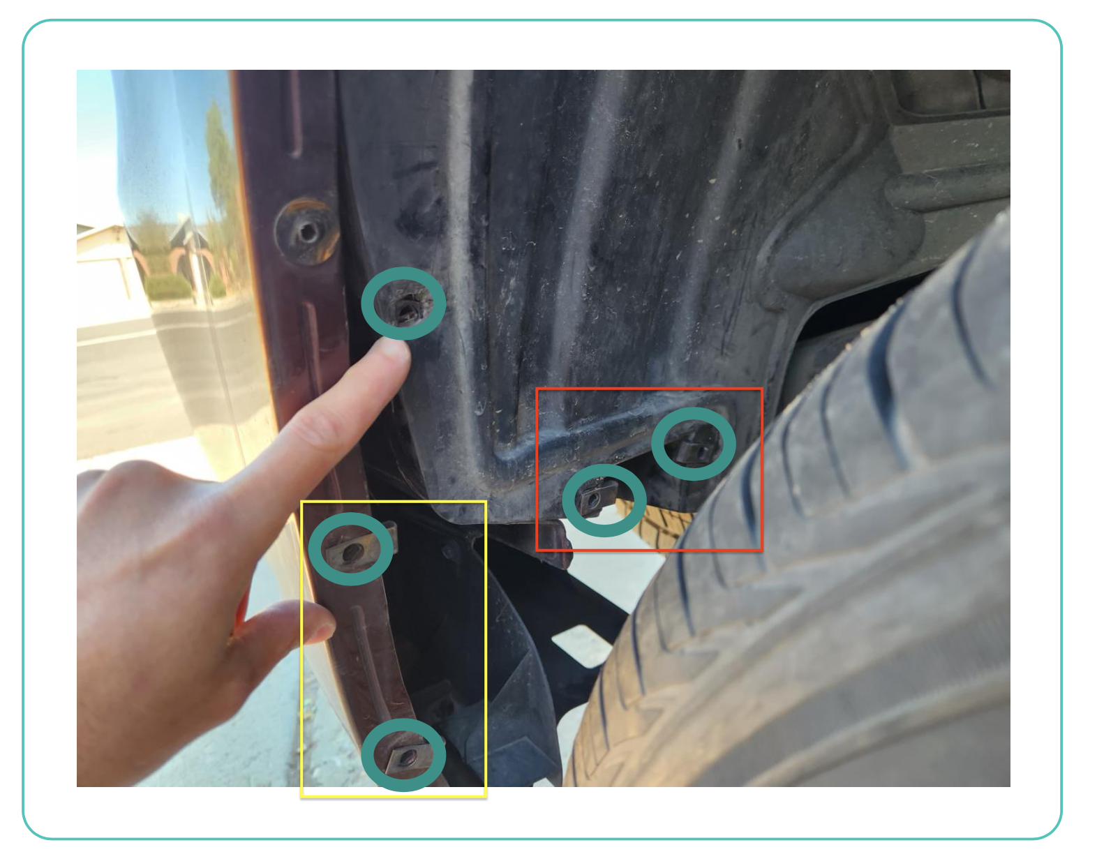

On the attached image from step three, you tell us to remove the plastic inserts. However, on mine, the hole marked in yellow do not have inserts, as these fasteners are the type where you pop out the center pin and pull out the whole fastener. This is the case on the other side, too. So these were easy. The two in red, however, are steel threaded clips, not plastic. And the thread in them is too small to accept the 1/4" screws that are included with the kit. They are easy to remove, but installing the plastic extruded nuts is a different story. The nut side of the plastic extruded nut is too large to fit through the small slot previously occupied by the steel nut. So the back side needs to be snipped larger enough to accept the plastic extruded nut. Again, not a project stopper, but a pain to get any snips in there to open the slot.
All done now. Not difficult, just some minor bits of confusion once I got into it. These will definitely help protect the trailer! Thanks!
The parts in red, I ended up using 2 flange nuts on the inside. I also couldn’t get the extruded nuts in there, but used the flange since I could reach my hand. Not sure which was is the right way to go. Ha!

Thanks for the feedback guys! I switched to the plastic extruded nuts because the metal ones I had been providing were starting to rust on some of the 3+ year old 100 series kits out in the wild. I tested the plastic ones in certain spots, but overlooked the two in red since I was more focused on the reach of the U shape. Sorry about that but I'm glad you guys figured out work arounds. Probably the simpler solution going forward is to just provide extra regular nuts for those two vs the extruded, like you ended up doing @poppe

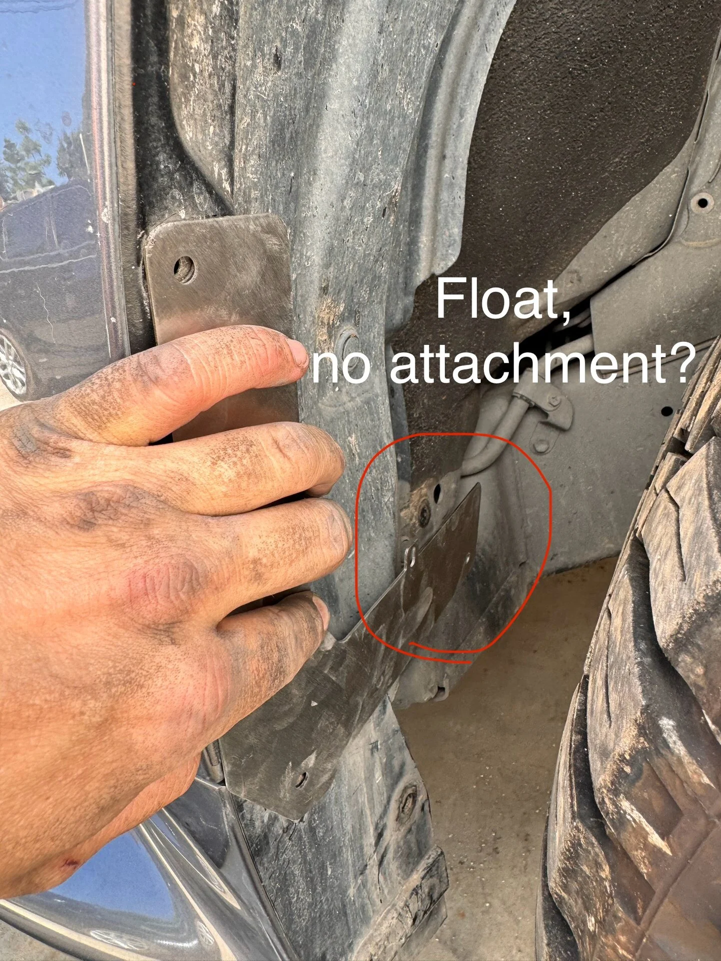

Let me know by email or here regarding the front bracket, if part leg of the L bracket should float?

I’m also nervous about the front bar floating and the lack of locking ball nut up there. That seems like both will be a long term weak point but maybe not? Curious to hear why the rear is locked but the front is not. I don’t do rock crawling really but I do take this LX on a ton of farm work pastures and super rough country roads with wash boards and various pot holes, sticks, corn stalks, etc. I’m not feeling super confident these will last or stay on in these conditions, but hoping I’m just grumpy from difficult install.
