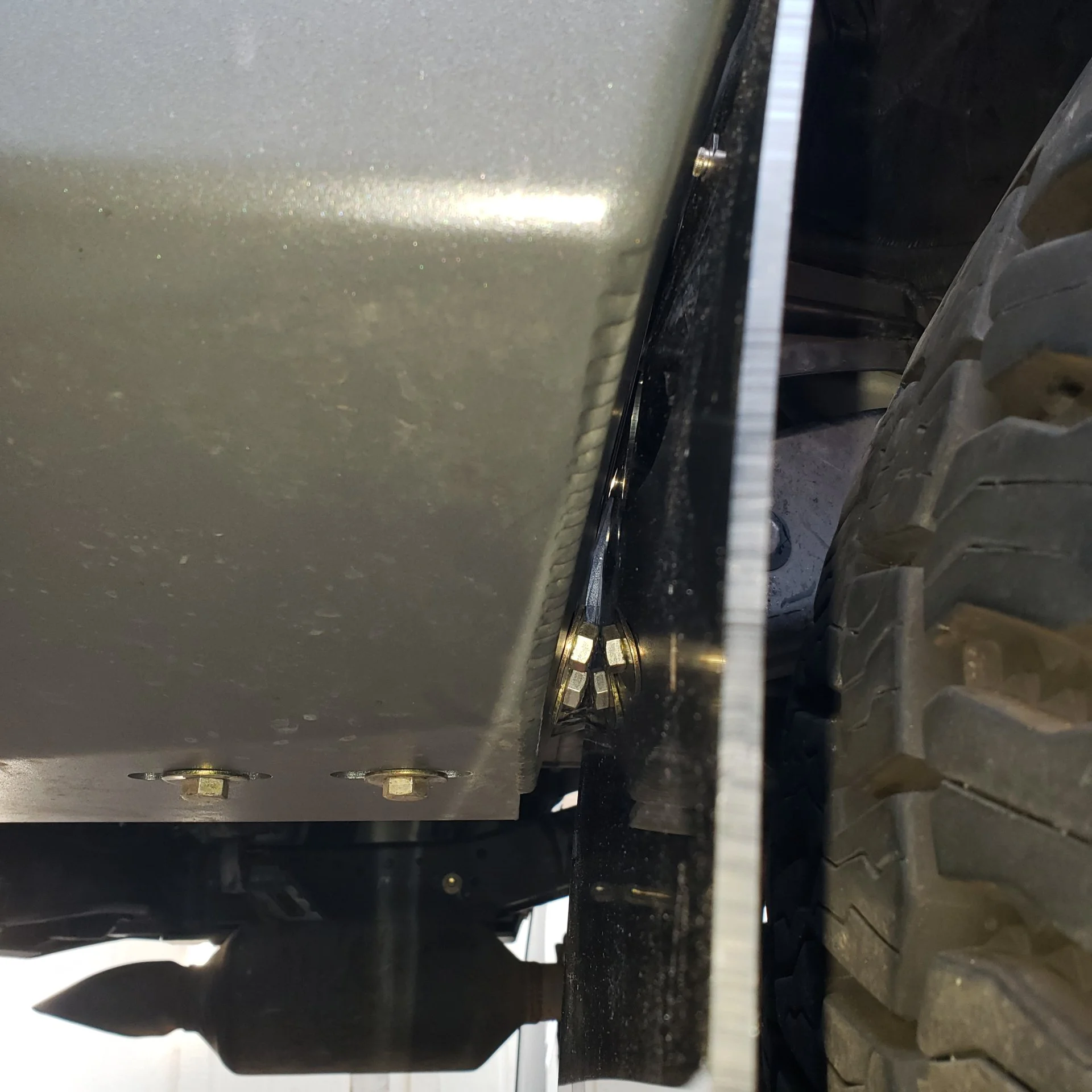

Yours is like mine and it’s a massive trap for mud and dust, I think I have souvenirs from every off pavement drive I’ve made to date.
One thing I did notice that’s different on yours is the white sheet metal area circled in red. Mine seems to hang out further than yours and I’ll need to grind mine down to get a mud flap to mount in there. I wonder what’s different about our installs.
only thing i can think of is that mine is an 08' and yours is the newer body. I have to be pretty diligent in cleaning out any dirt collected from trails so anything to cover this up would be nice.
Thanks for sharing photos! The one thing I'm not 100% on with the dissent is if the flap will be pushed into the wheel well by the two large bolts. I've been trying to think of solutions, and the only thing I've managed to come up with is the user needing to cut the flap material around those bolts.

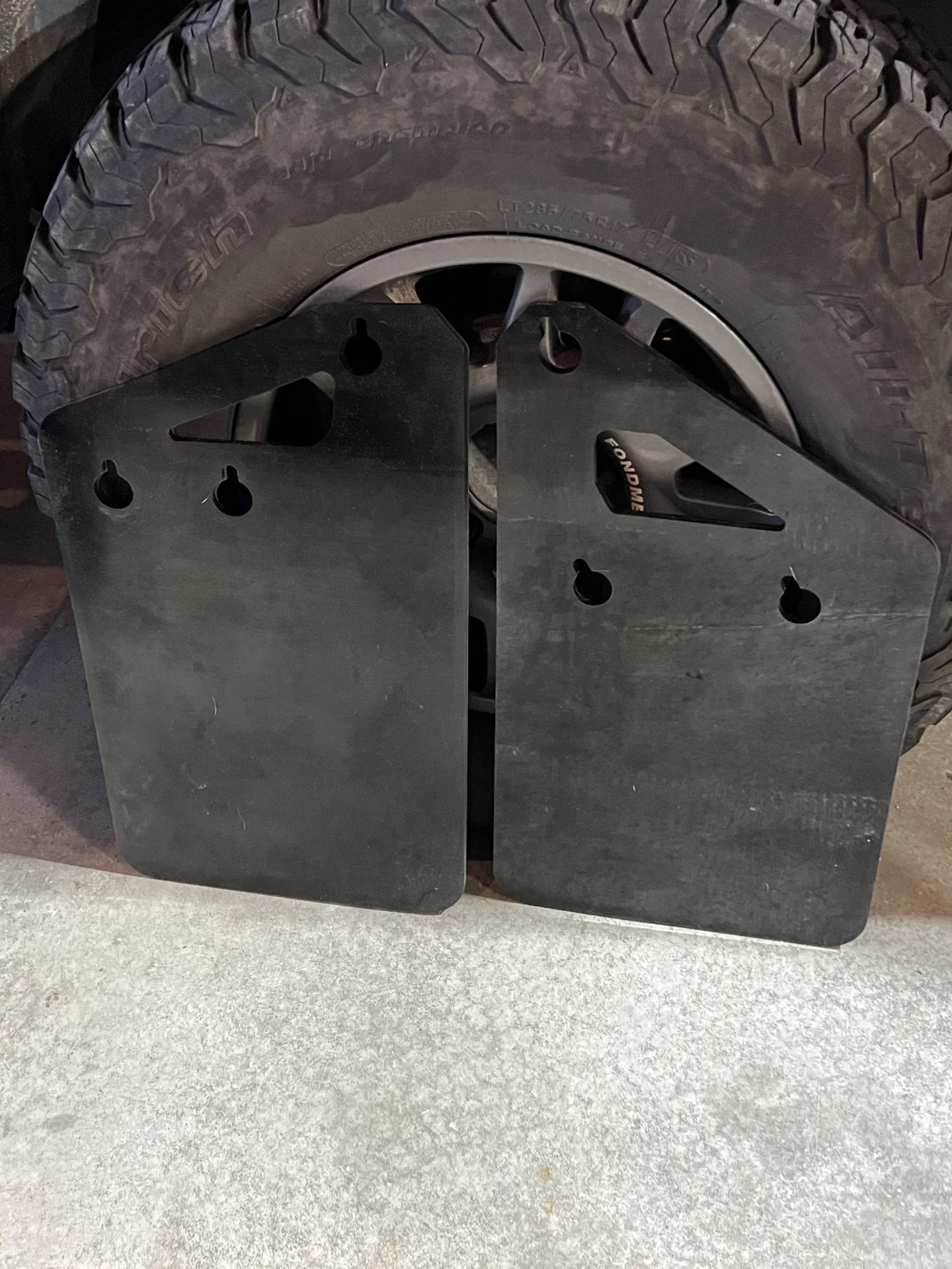

Ive got 1 kit out in the wild. Waiting for him to get time to do the install. Once that's done and presumably no major changes are needed, I'll be starting production. So hopefully a couple weeks at most.

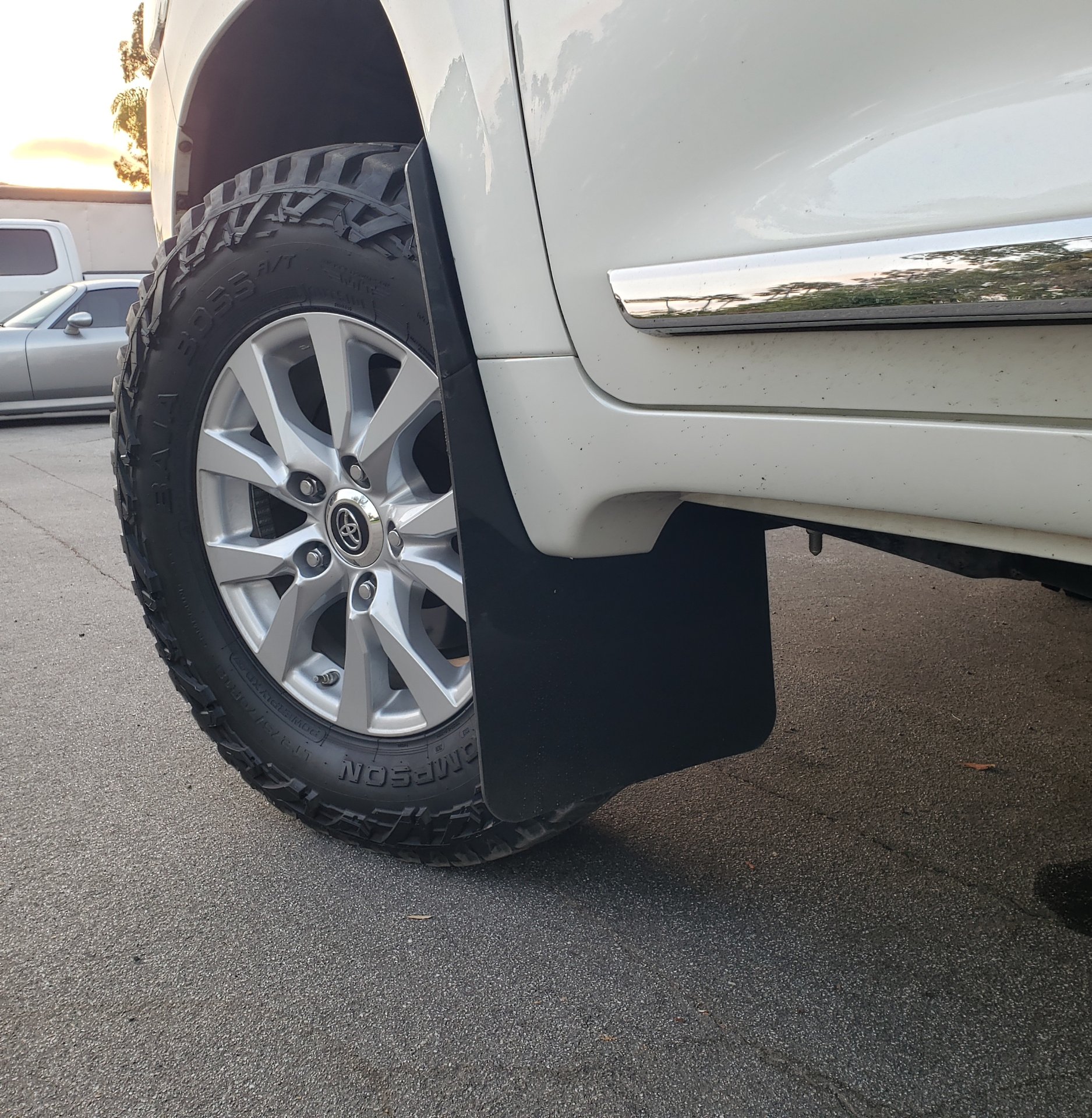

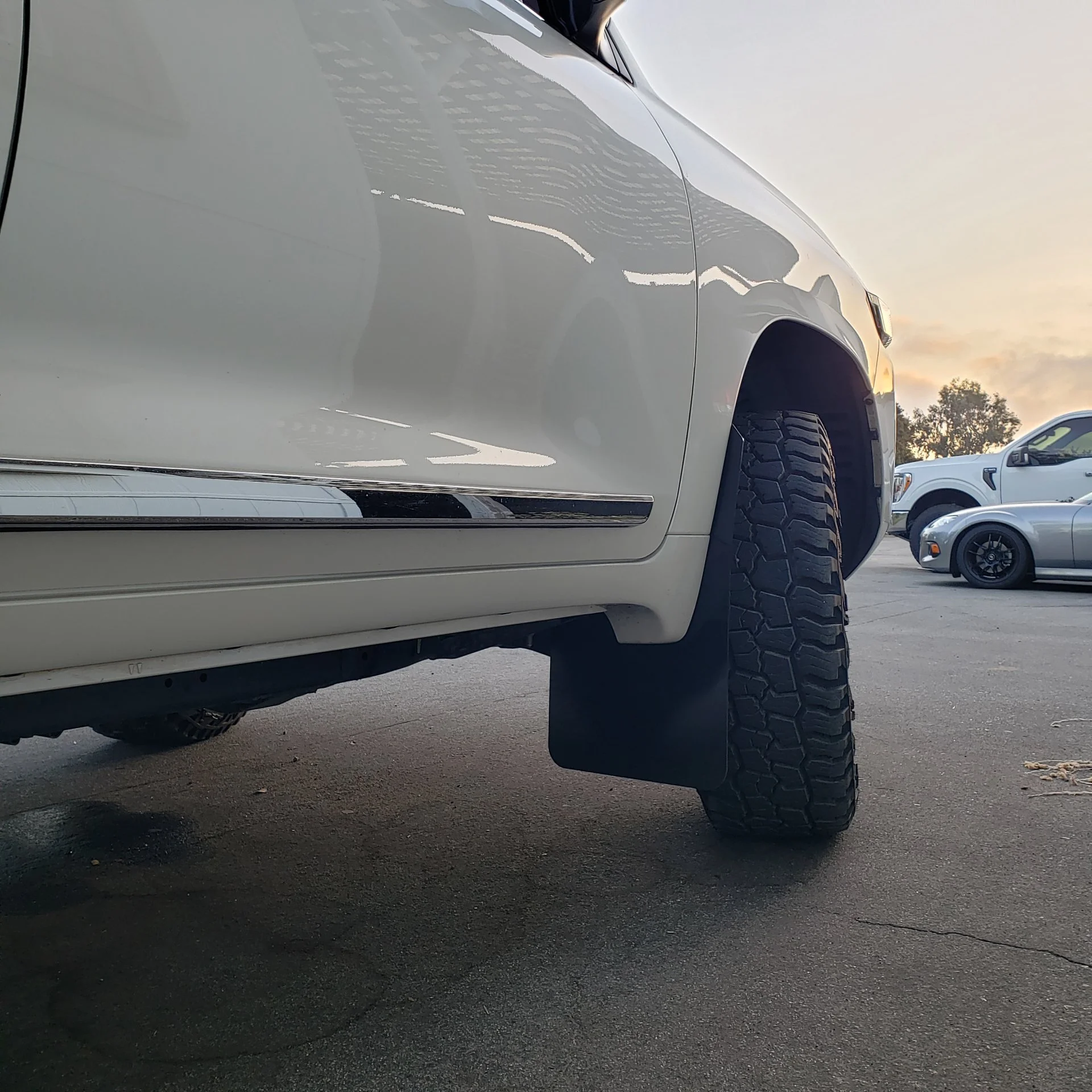

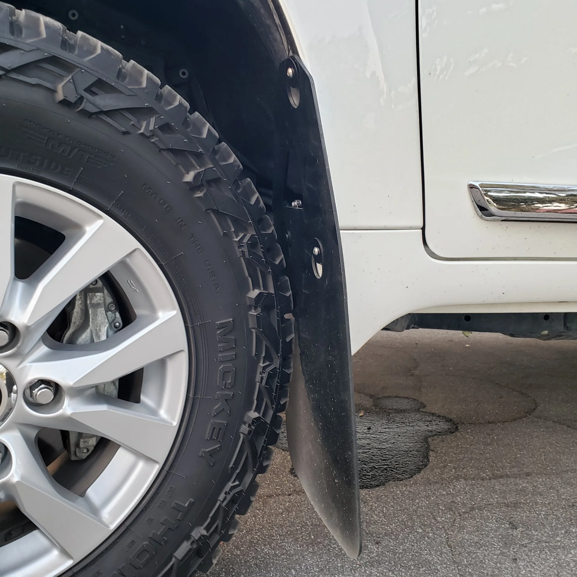

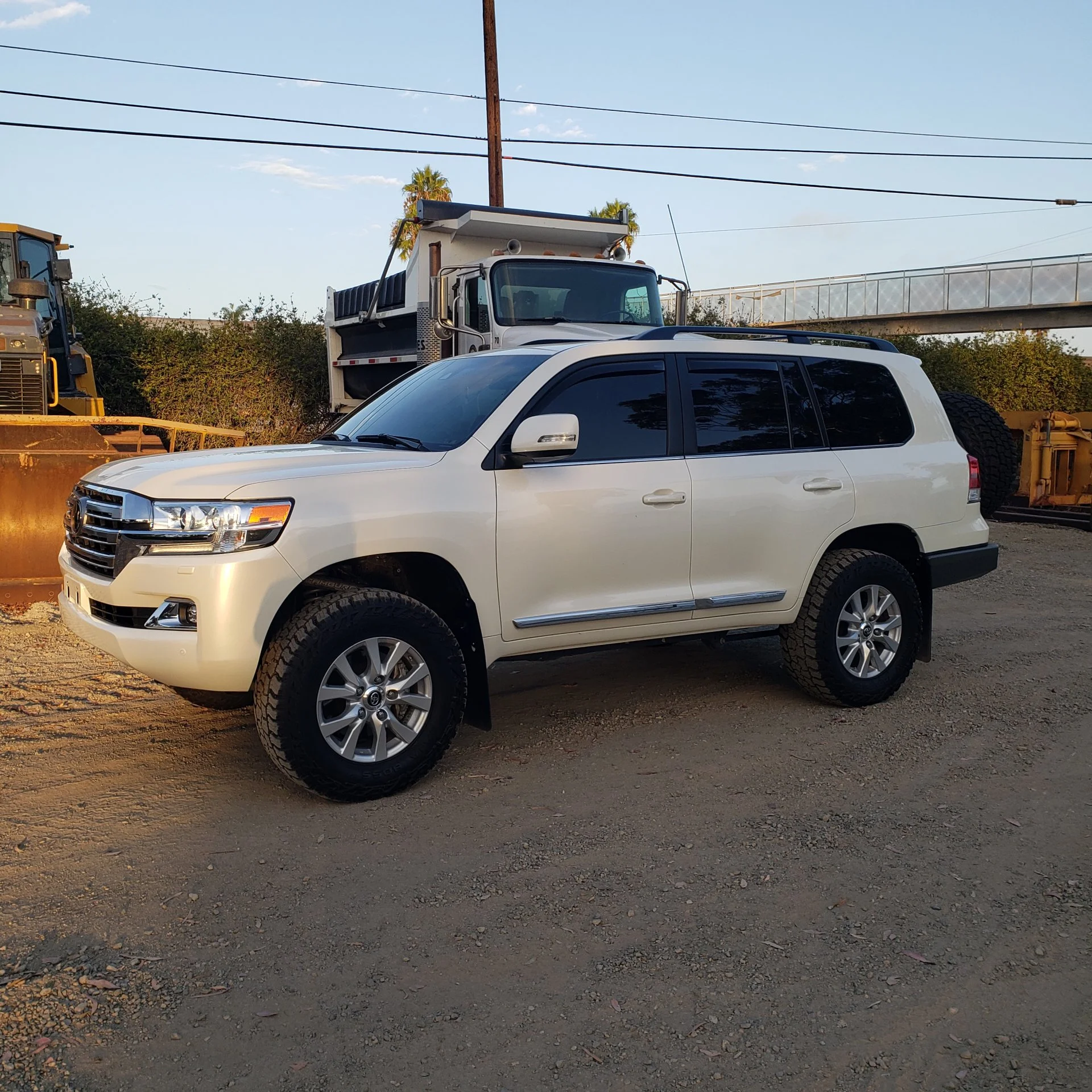

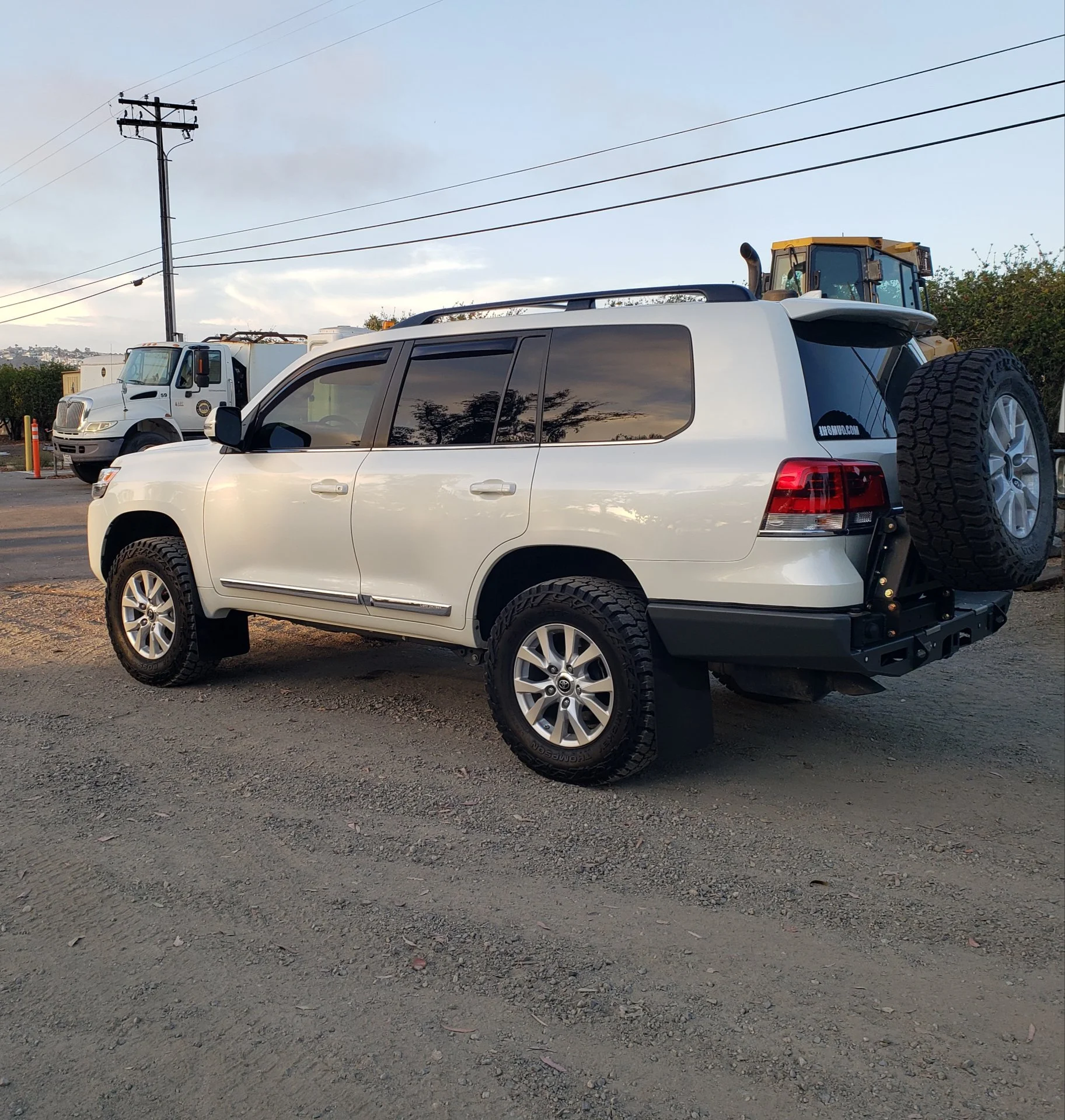

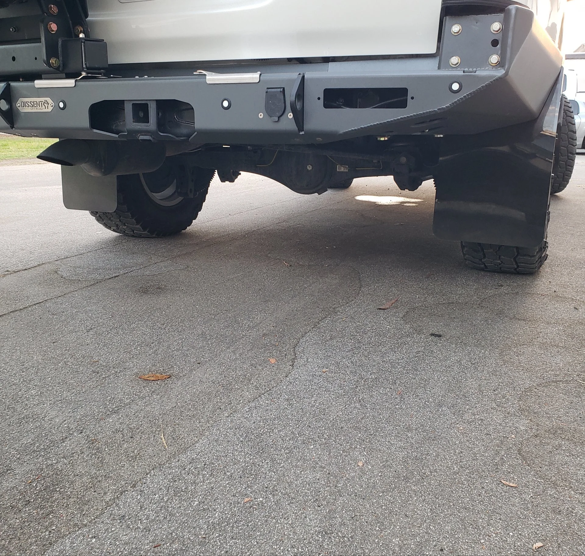

Here's a quick photo dump and a very brief summary, I'll elaborate more when I get to a computer.
Install was :banana: Only issue was finding the time between daddy day care sessions. I did have to pick up 2 longer panhead bolts, Rami has the info already. So far there's only 40ish miles on the set with mixed road and highway miles. The gaps between the tires and flaps are tiny at full lock. DS tire rubs the KDSS the lock. In the rear the bolts on the Dissent do push the flaps marginally forward. I haven't determined if I'll cut reliefs for them or not. There is no noticeable contact between the flaps and tires. I drove in a dirt/gravel lot, both forward and reverse, and built up a nice layer of dust on them before getting on the freeway. There are no rub marks on the flaps after the drive.
You can see my 200's specs in the signature. Fire off any questions you have and I'll do my best to answer. However, 'til then, here's some pics.
Yes, it's right around 1/4" static. I was somewhat surprised to see no contact marks in the dust on them after backing with the wheels at full lock to the either side.

Is that showing 1/4" between the tire and mudflap?

The front flap bracket is designed so that it can be bent further back to clear larger tires. One difficulty with the 200 is that the plastic rocker actually comes out, toward the tire, as it goes into the wheel well. That portion wants to push the front flap further in towards the wheel. Those who aren't afraid of cutting away a bit of plastic and maybe hammering a bit will be able to clear very easily.

I didn't make it to the local mountain the weekend before last, work called and I had to make a trip to the north end of the state. Lots of I 5 miles with some gravel road miles inter-mixed. The flaps did their job; no new chips on the roll pans or loud dings from the gravel hitting the Dissent Rear. They also have done a great job of keep the road water/dirt off the side of the cruiser. Stoked.
