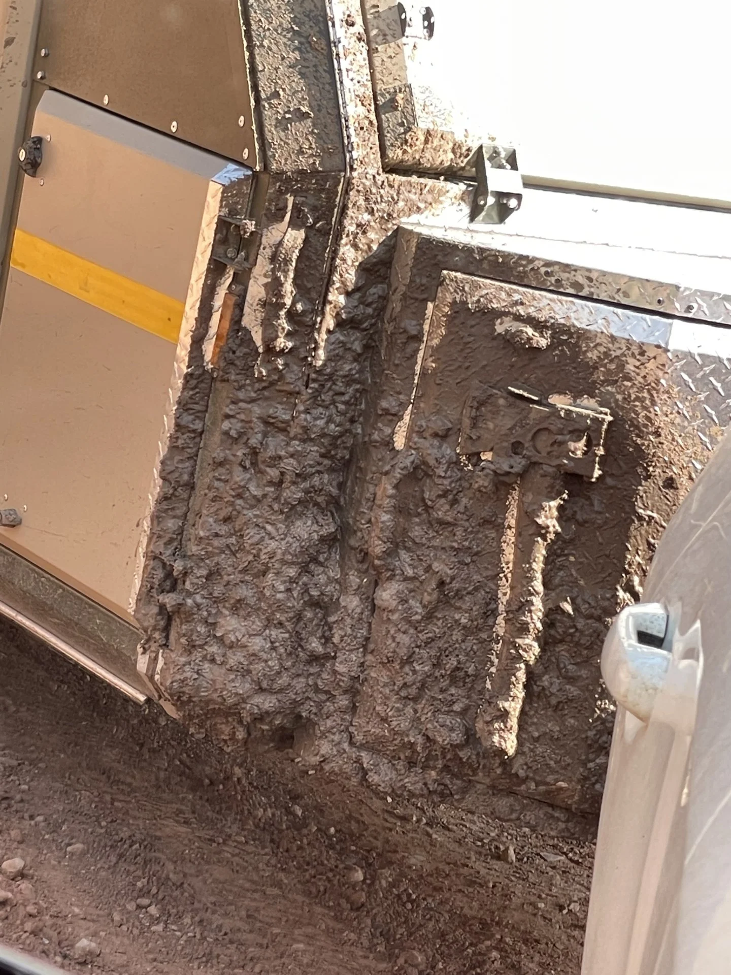

If they will prevent the camper disaster pictured below and they fit a ‘21 with a rear Dissent bumper can you please just take my money.

I pull a small trailer too. They can't keep 100% off, but they make it a hell of a lot better. The hope is that they will fit both dissent and slee. I had to go off pictures of both though, so it's still a bit questionable. Hopefully will iron out those variables with the first few sets.
Any improvement would be an improvement. What I did at the car wash in Delores, CO can only be described as criminal, there was enough Moab dirt in that bay to build an adobe home.

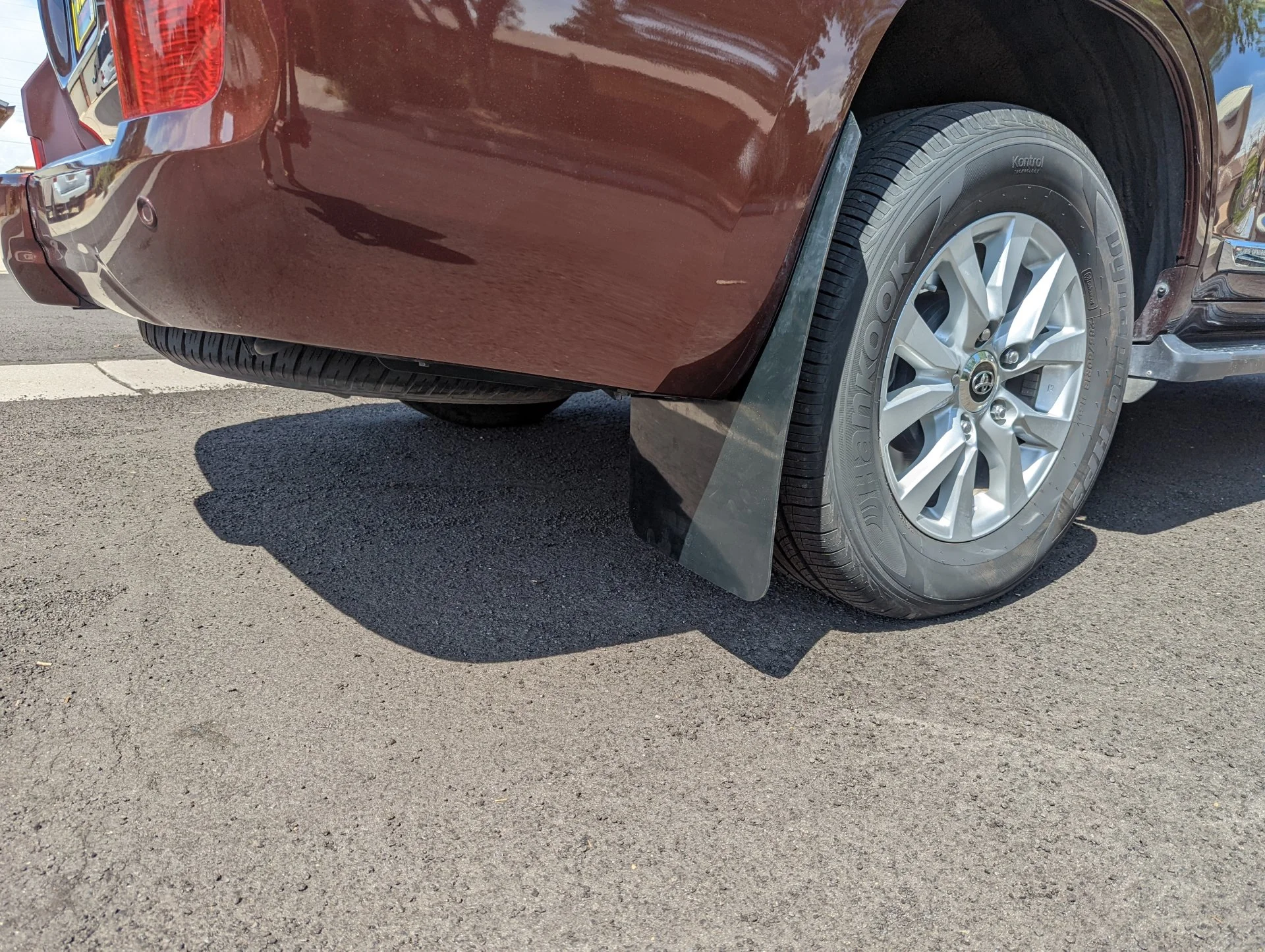

Almost there! Just a few small kinks to iron out and then I'll start ordering the metal and hardware. The final brackets will be 316 stainless and the hardware a mixture of stainless and coated.
I think they will really look great with some decent tires. I made them a bit oversized for stock because my target audience is people like us who put bigger tires, lifts, spacers, etc.

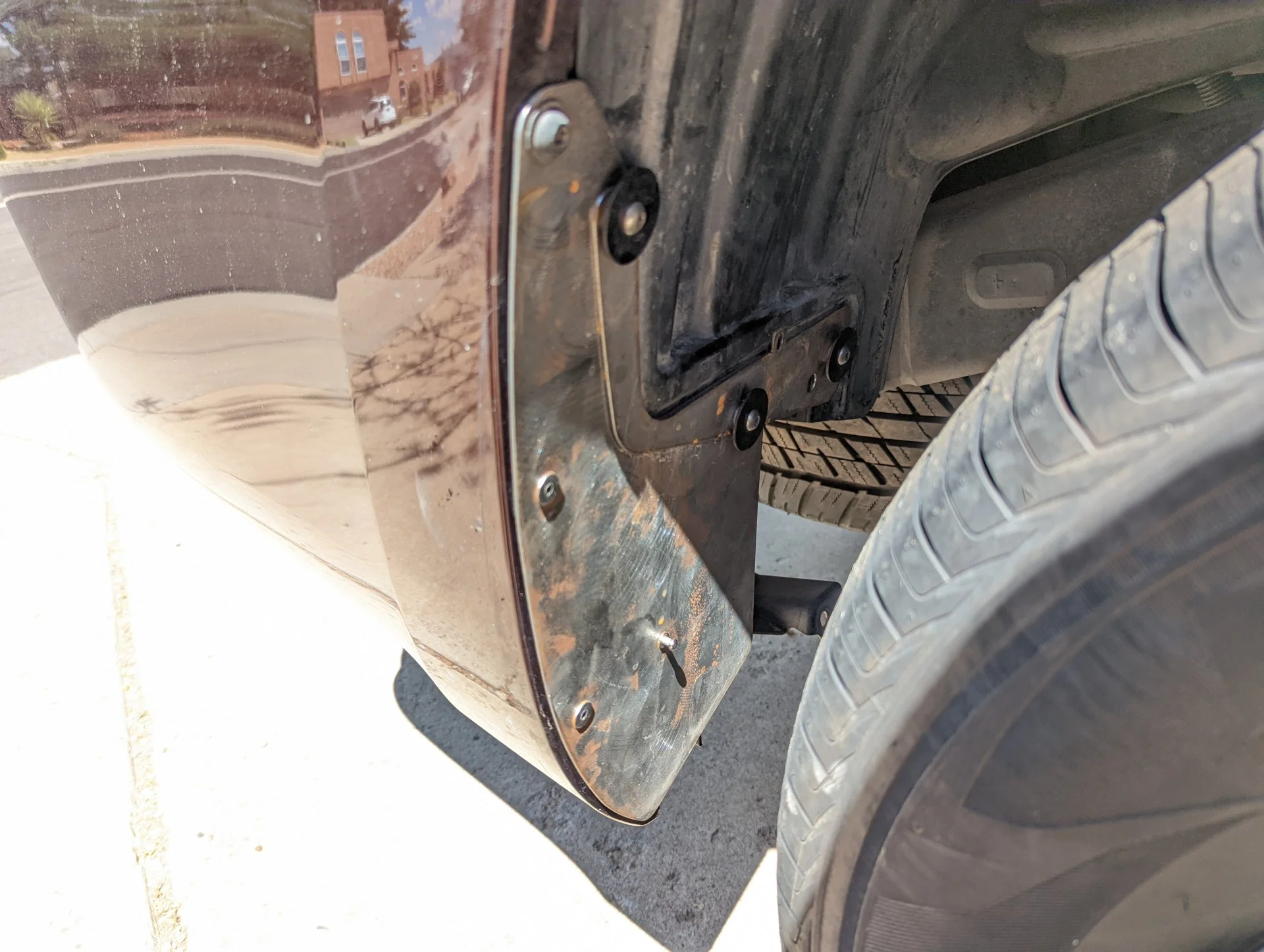

Some shots of how they attach/detach. The final hardware and brackets are all stainless or coated. Rust on these final prototypes is because its much cheaper to prototype with mild steel vs stainless.
Front bracket. Can be bent inward as much as needed to clear larger tires. Also helps hold back the fender liner.

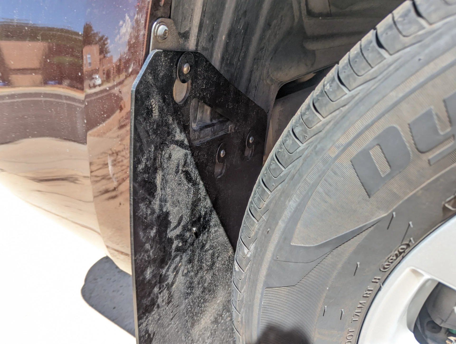

Front with flap on.

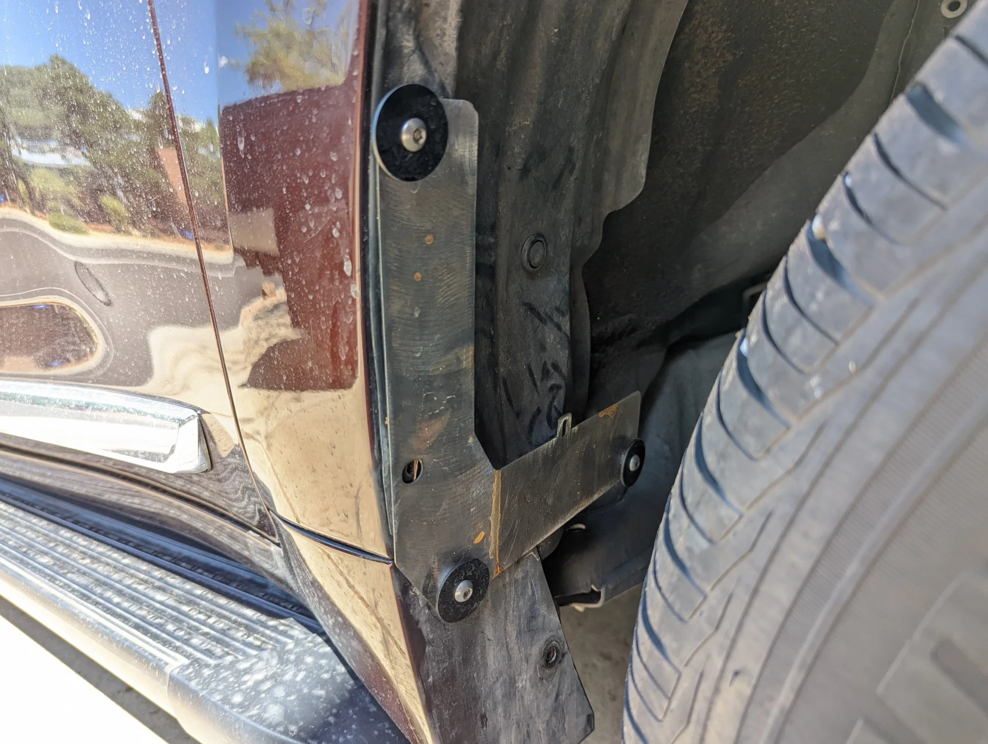

Rear with flap off. I use two brackets for the rear. The large one holding the stock bumper wouldn't be needed with aftermarket rear bumpers. That typically makes those kits a bit cheaper.

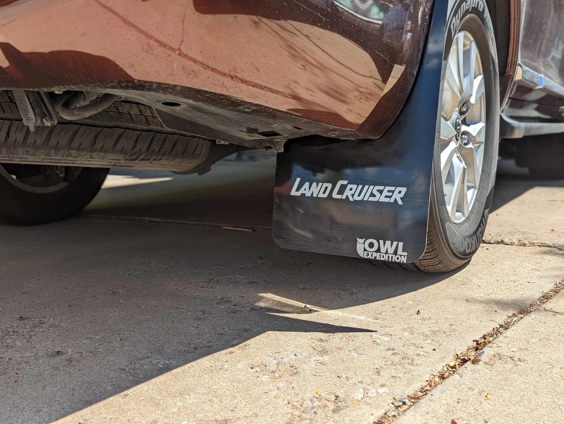

Rear with flap on
