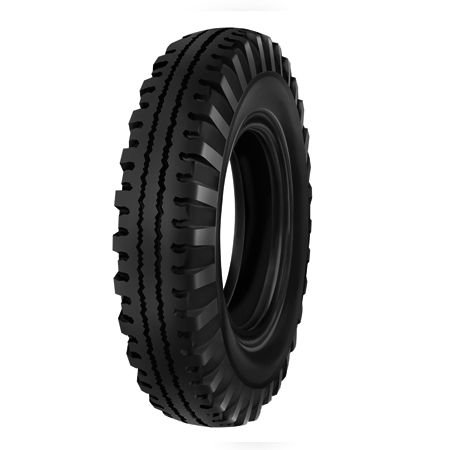

What about the Bridgestone jeep service tire...can we still find some around?
Besides them once being heavy, any feedback on this tire?
Bridgestone Jeep Service | Bridgestone New Zealand Tyres - Bridgestone
The Y720 look really cool, and I think you can still get them from a VW off road shop in CA (they seem to use them a lot as front tires on VW off road bugs)..., but I will be going with the Y742S for my project.
