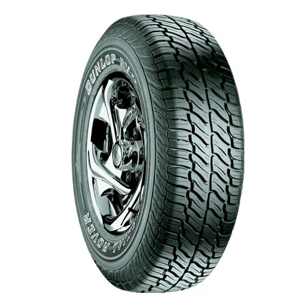

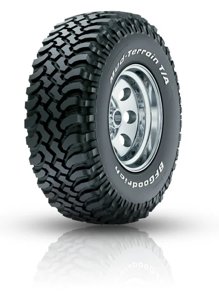

Those first Firestone Military 700-15 NDCC 29.50”OD is what I was looking at running on my '64 for that stock look, but after hearing some not so nice things about their wet weather ride, I started thinking about either the Yokohama Y720, BF Goodrich Mud-Terrain, maybe some Goodyear Wrangler GS-A, or finally the Dunlop Radial Rover RVXT...they say they come in narrower selections, but I can't find any photos.
I would prefer the Firestone Military since she won't be a daily, but looks like I may play it safe and run the Yokohama (if I can find them) or the Goodrich...which way you leaning to Jim?

Seeing as how I put about 5000 miles a year on my daily, I'll be excited if I get to 1000 miles per summer on the '64...so if I can find some skinny, "stock looking" Goodrich, then that may be the best tires for my needs...but I do like those Firestones...really...how bad are they in the rain and snow?
