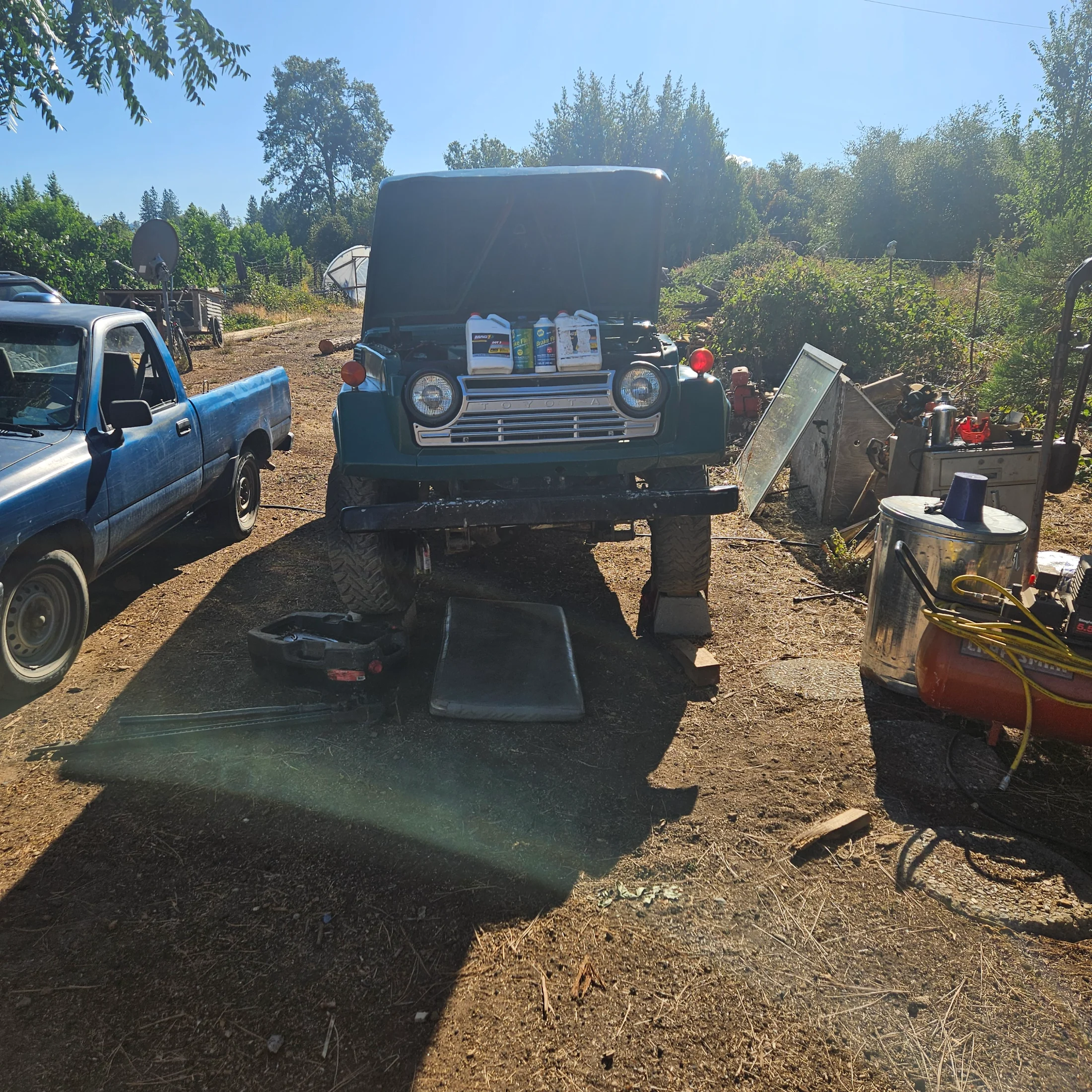

Last week i did a once over of the landcruiser, rotated tires, checked brakes, inspected chassis. During my shake down i found one rubber brake hose which i never replaced.
OEM, 53 years old, holding pressure and looking like a very tired brake hose.
Now ive had brake hoses blow up on me and cause no brake situations before, so i decided to go ahead and fix it.
I ordered one from one of the landcruiser enthusiast mark up centers for around $50 shipped.
2 days later tracking said it hasn't moved so i decide that ill try and get one on my trip to town. (Thinking i bought the part and stashed it)
I went looking at my stash spot and couldn't find what i was looking for.
I the process of removing the hose retaining clip i broke the steel bracket off of the frame.
I did not find my stash of new brake hose but i did bring my old one.
So i stopped by Brake parts supply in chico and had Leigh make me a new one for about $30. It took him about 3 minutes.
Between buying 2 (perhaps 3) lines and driving all over hell and back, brake fluid and paying my welder im going to have $250 into fixing this BS that could probably have lasted another 3 decades...
What else might murphy throw my way before tuesday?

I got it back together and bled and i think its bubble free but the sun went down and im done for the night. Hopefully ive got full pedal in the morning otherwise i keep bleeding until im out of dot-3.
This pig has always been a nightmare to bleed out.
Still got a tiny air bubble this morning evidenced by the fact that the pedal takes a few pumps so we go around it and bleed again, and again, and again until we get all of the air out.
Got enough brake fluid to do this all day so hows it going to play out?
Want to eff around and find out?
I went around again and it didn't get any better so i changed my technique.
Instead of using a tube attached to the bleeder into a bottle of beake fluid and pumping away, i pumped up the brakes and jammed the pedal down against the floor using a tire iron.
Went down and opened the right front rear bleeder.
Let it shoot air aind fluid and close it before it stops.
Pump it and jam it again
Next the right front front, open it and another huge bubble.
Then the left side and now we have a solid pedal...

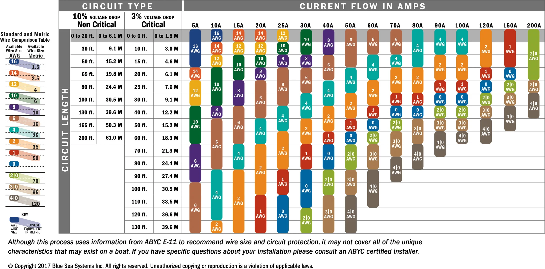

E=i×r
The current through the motor is defined by the resistance and suply voltage 12v at its terminals.
What im intending to do is eliminate the voltage drop in the old wiring and switch such that it gets 12v even under load.
As it sits the drop in the wiring is only allowing me 6 to 8 volts to apply to the motor...
Voltage drop testing, its something worth knowing how to do.
Yes, 4 gauge wire sounds a bit overkill for this project. Toyota also installed an automatic circuit breaker in this system so that the current is almost immediately disconnected for a brief period of time anytime the amps exceed a certain amperage. No idea what amperage that would be but probably something less than 30 amps. So when the motor stalls on up or down the amps will spike and the circuit breaker opens to protect the components (motor, glass, fuse, etc.). They are inexpensive but I have no idea what size you would need to use.

E=i/r
Ohm's Law is E=IxR. FWIW, I'm pretty sure you're not getting that much voltage drop and even if you are and you think it's because you need new wiring, there is no reason to go up several sizes from what the application calls for.
