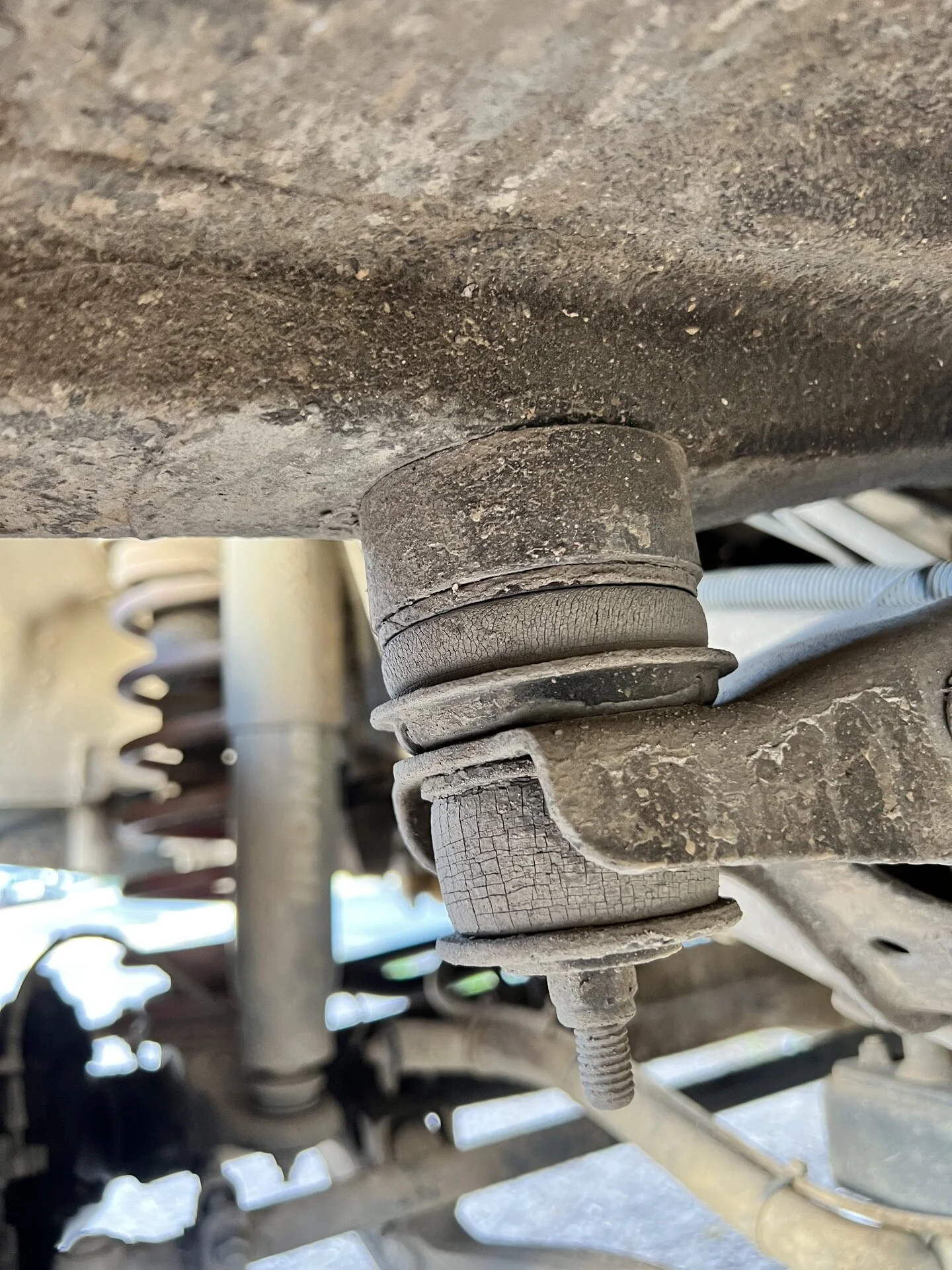

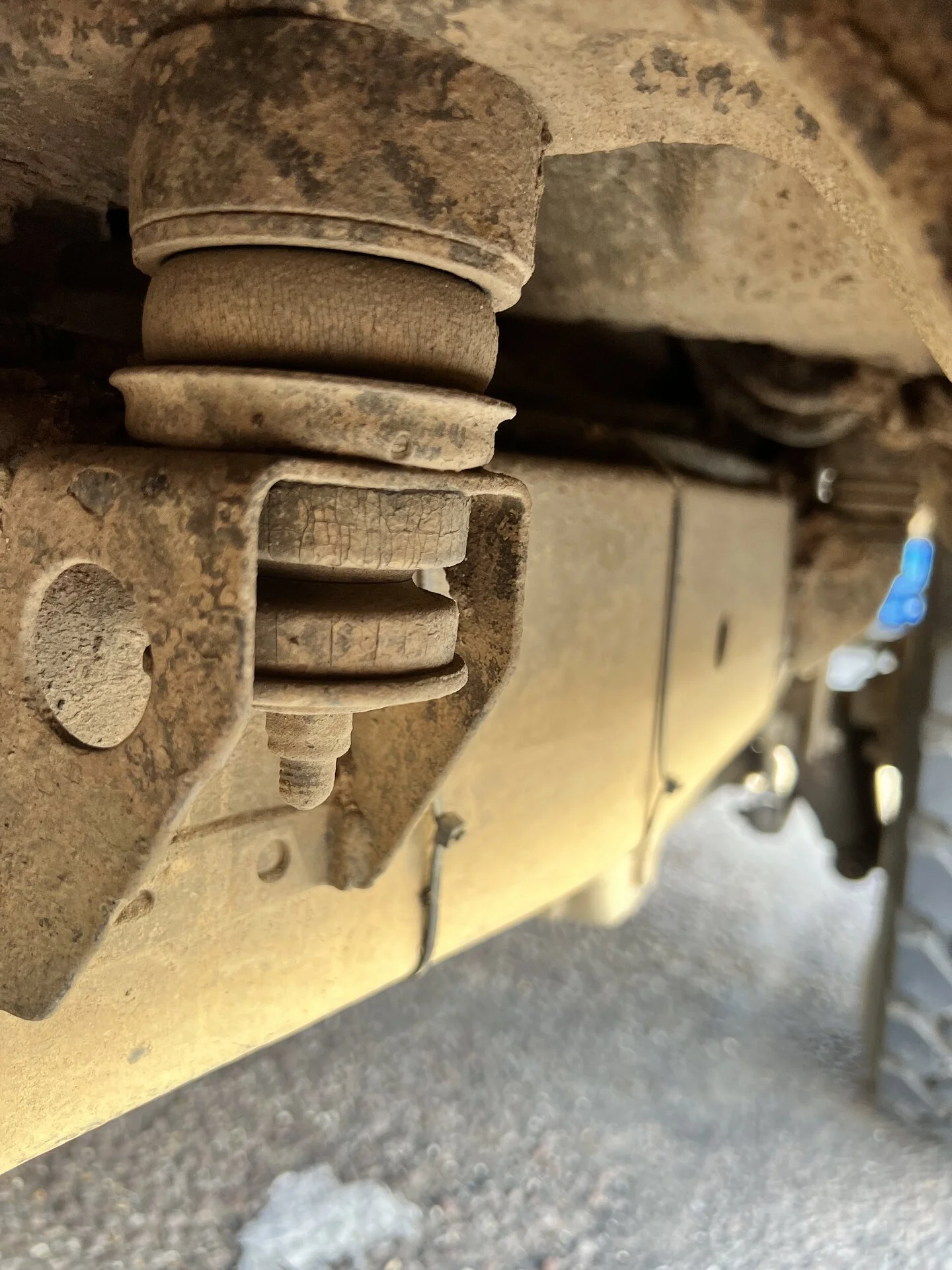

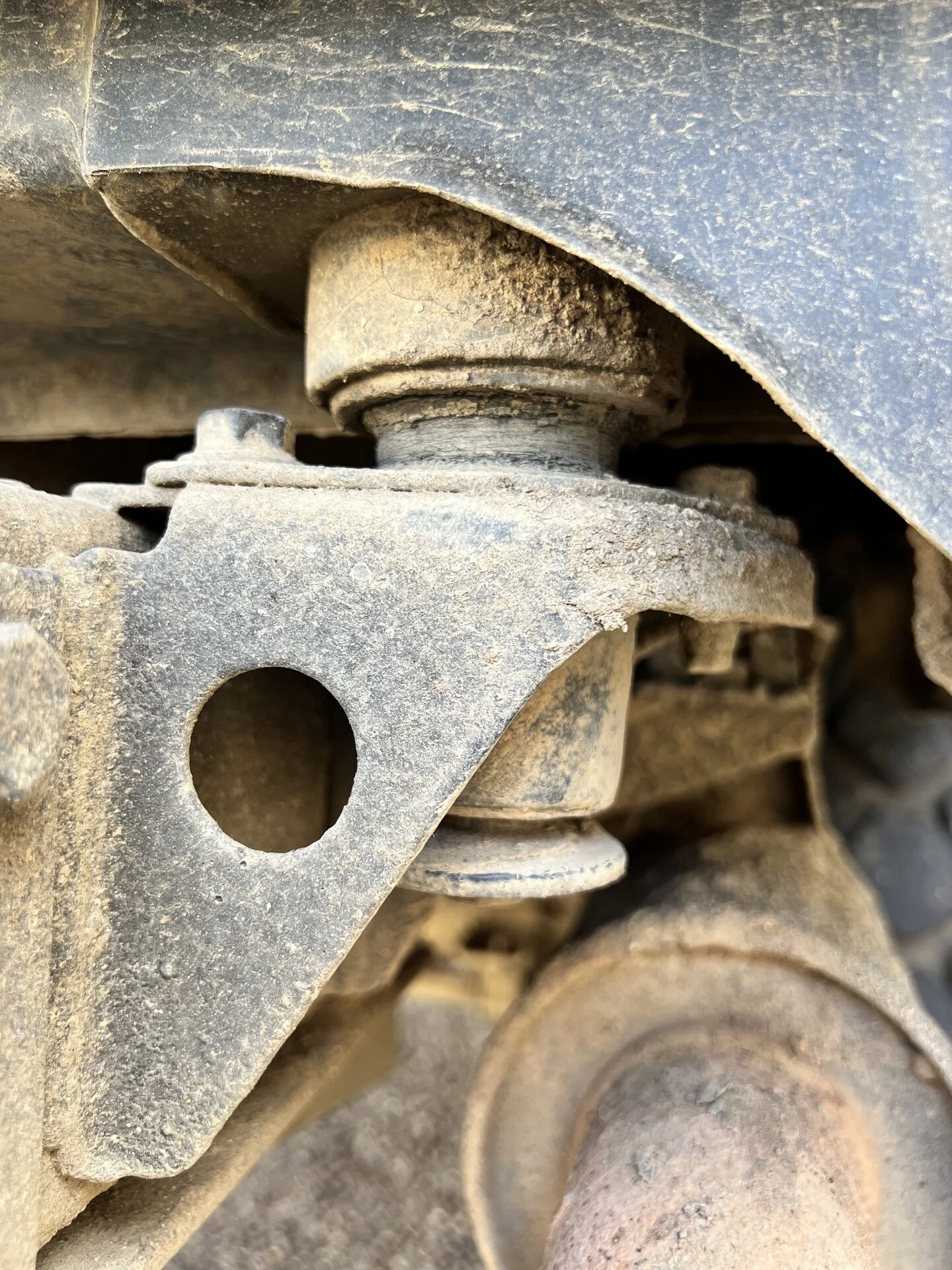

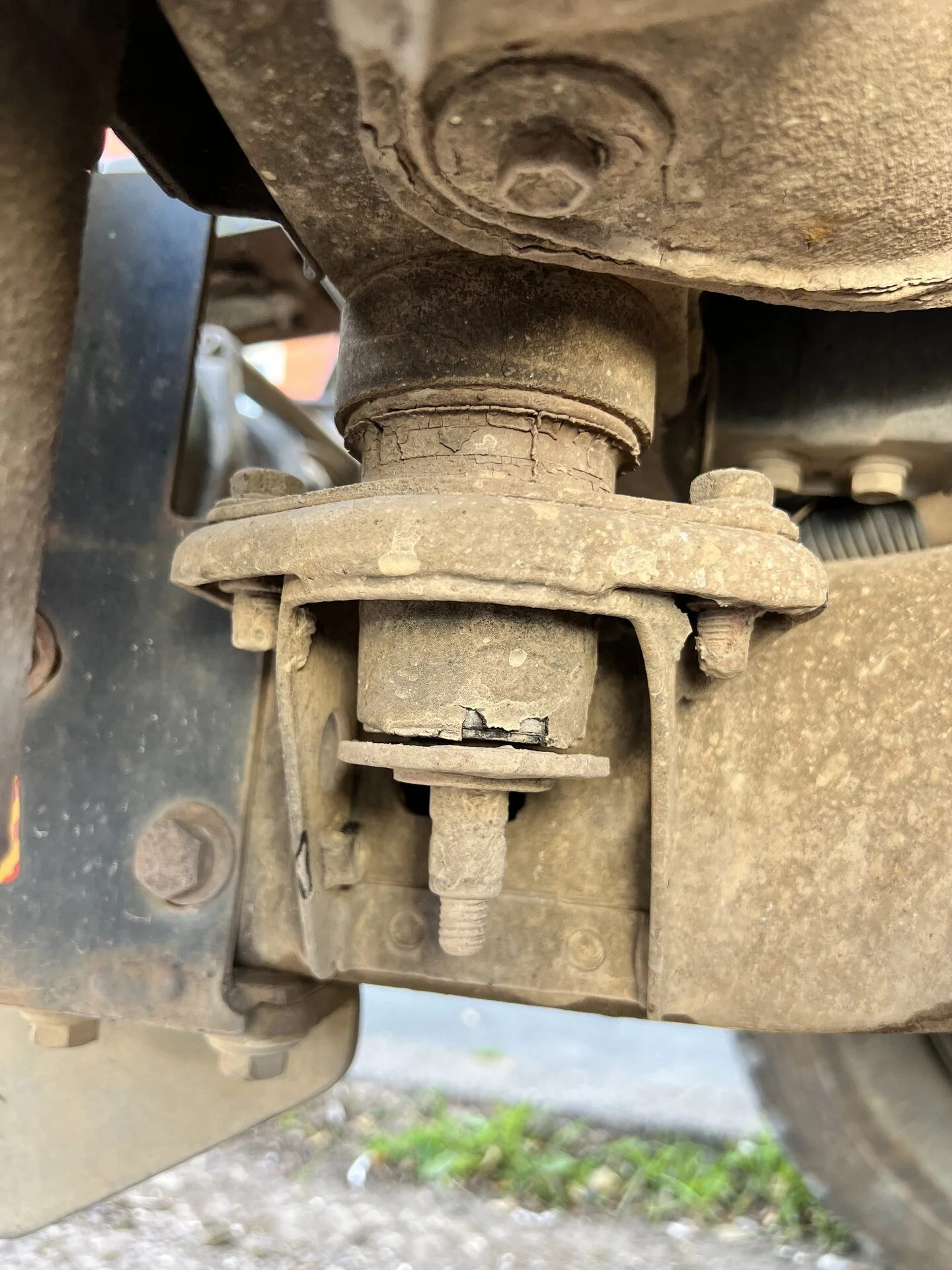

Are my front and rear mounts one or two piece? I need to know to order a replacement kit from 4crawler.
Fronts look like this
Rears look like this
The front and rears are both one piece, bonded into a slightly cone shaped flanged steel shell, with a tube steel core, that the bolt goes through.
Front and rear are different length.
And the left and right rear CAN use the same part, although OEM was handed.
All the middle ones are two piece rubber with an unbonded steel tube sleave.
Thank you. Hugely helpful
