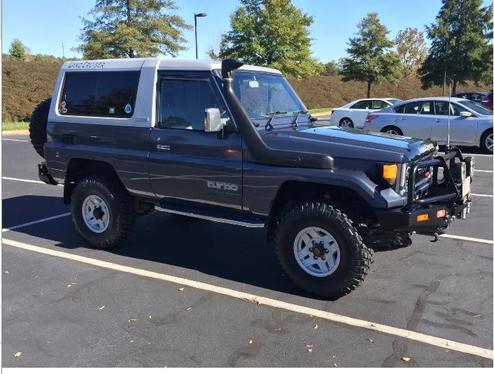

It was sold some time ago but my BJ74 had a PTO winch / ARB bumper combo.

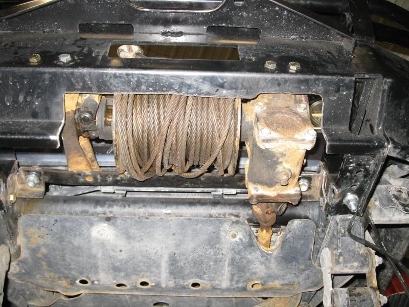

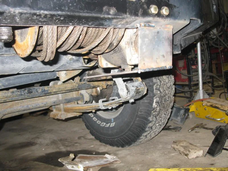

Hmmm. Lots of food for thought here, and exactly the kind of real feedback I'd hoped for. I've started looking (again) at how much there is to cut. Bear in mind I have an ARB on this truck (AND the Prado 90) because of the high potential of animal strikes. Removing material to fit the winch is part of what makes me hesitate... Here are some pics I grabbed a year or so back (wish I could give credit but can't remember where I go them).
This particular iteration puts much of the winch below the bumper line. I saw another nice install, but it had a bodylift, which made things much easier. Def not going that route...

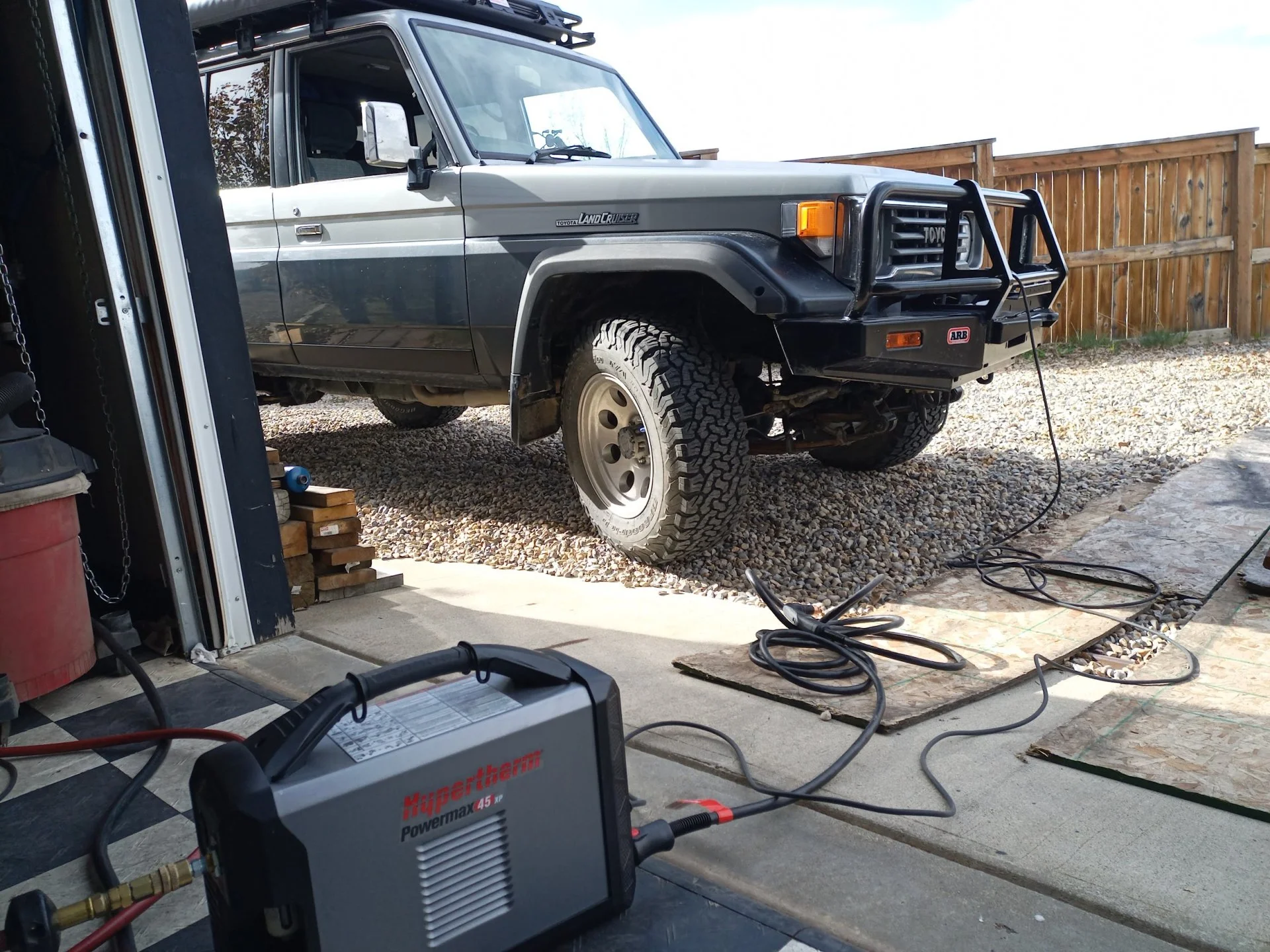

Well, I have begun this project. We started by cutting out the crossbar at the lower back of the ARB. I was hoping I could cut out a section of the plate on the front of the bumper sufficient to clear the motor protrusion on the LHS, but alas... still not enough room to get the motor low enough to mate with the drive shaft, and also have enough room behind to fashion a mounting bracket. Compounding this, the slip yoke did not want to separate from its splines. Finally I pulled the entire driveshaft, and after all manner of pounding, heat, and penetrating oil, we had to resort to cutting. Even one cut wouldn't do it. After the second cut and some cold chisel action, it finally, reluctantly, separated. Will have to weld some round stock over top once we get everything else finished.
My plan going forward is to cut more out of the front lower plate, and plane the rear mounts down a bit, allowing the winch to sit lower. Also, I'm going to try to move the last hanger bracket down a bit to improve the angle where the driveshaft comes under the rad.
