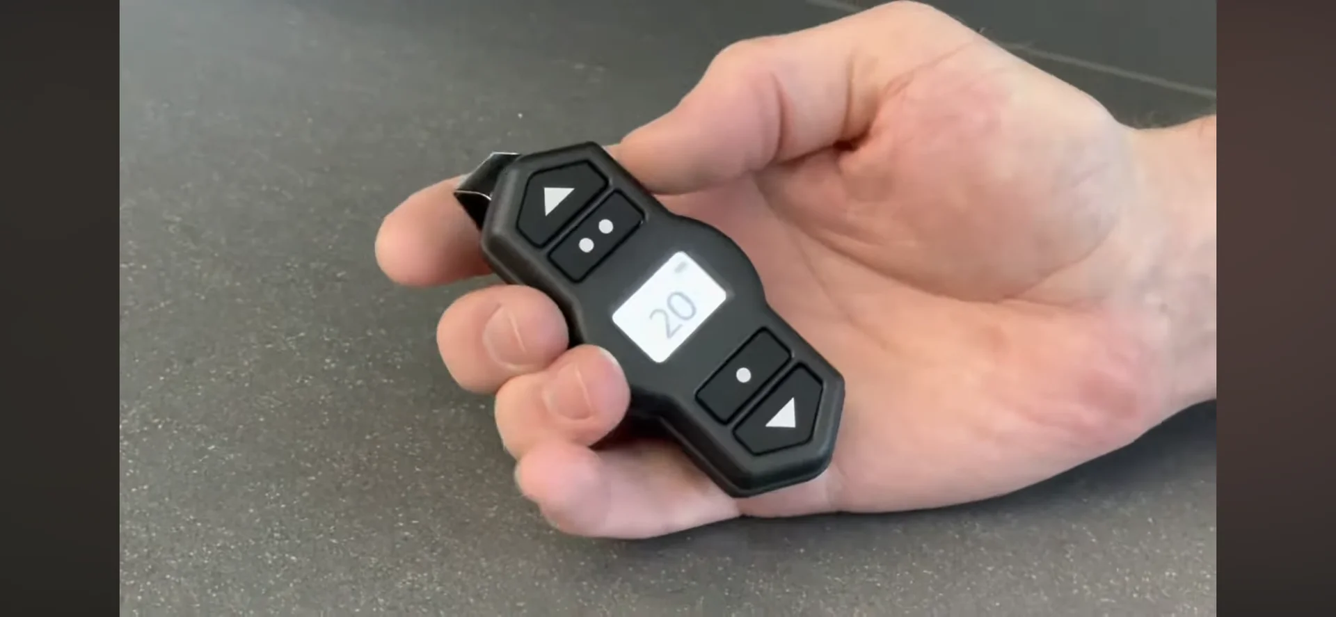

One of the airbag set ups was operated by wireless remote control, I ran across it when doing some research on adding air bags to my build.

THIS - the whole point of the airbags is to be able to adjust pressure/lift based on load, so if you are not able to manually inflate/deflate them, there is likely a remote to do that for you. If the compressor has a pressure switch (can't imagine your application doesn't) and it is cycling there is a leak. Also, be sure each one is controlled separately or at least each with its own ability to maintain pressure independent of the other. If they are T'd together, you can run into an issue when cornering where the outboard bag is compressed and transfers pressure to the inboard bag making it difficult or impossible for the springs to level you out - this is dangerous in higher speed cornering like entering an off ramp or an evasive maneuver. I almost learned this lesson the hard way with mine when trying to shift lanes quickly to make an exit.
