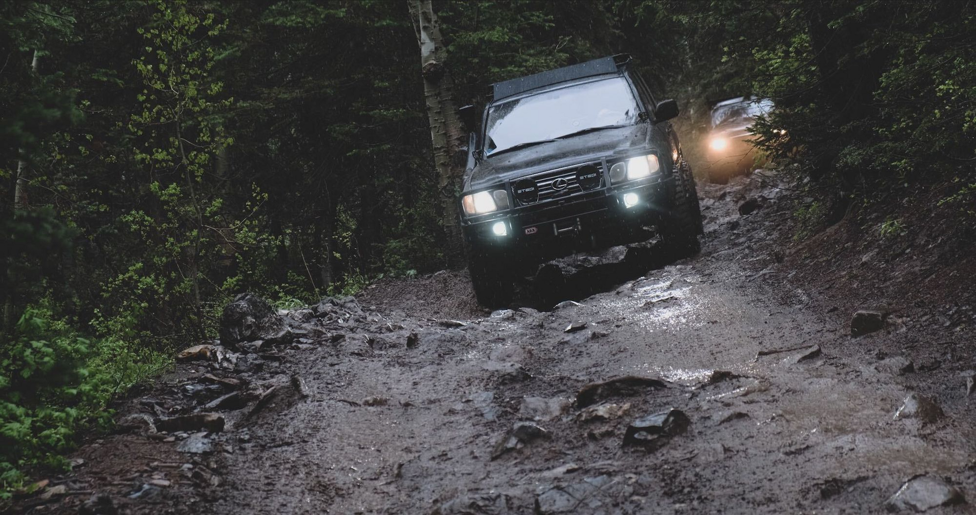

The Stedi lights are made to fit the openings and work pretty well. They're just fog lights, so they're not going to have output like what Slee sells. I'd buy them again. These are probably 4 years old at this point, looks like there are other options like the Boost light. I don't know much about those.

Thats a bummer. I have the Stedi Boost driving lights in my ARB and the light output is better than the high beams on my Depo headlights (Land Cruiser). I would contact Stedi customer service and see if they can still get them or are planning on releasing something else. They actually have fantastic customer service.
