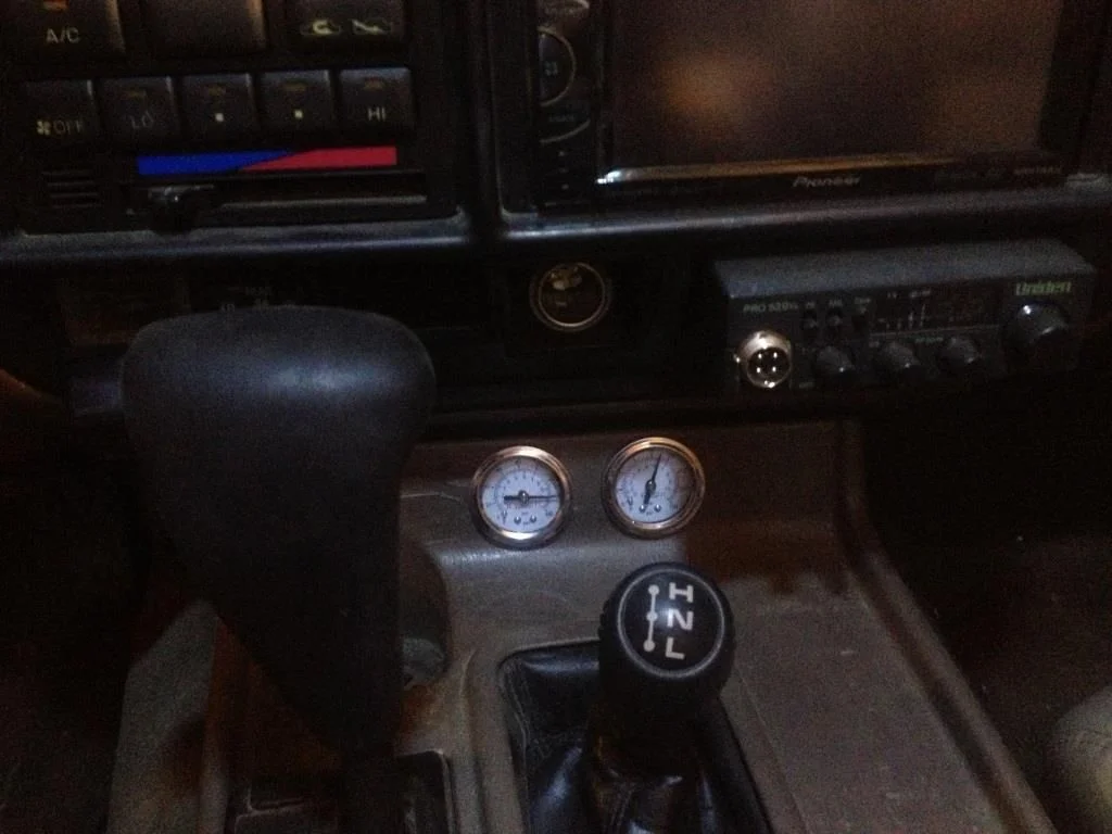

Here's how I monitor air pressure. The gauge on the left is the tank pressure and the gauge on the right is the pressure at the locker solenoids.
That's very nice and clean.
