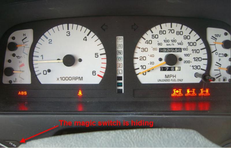

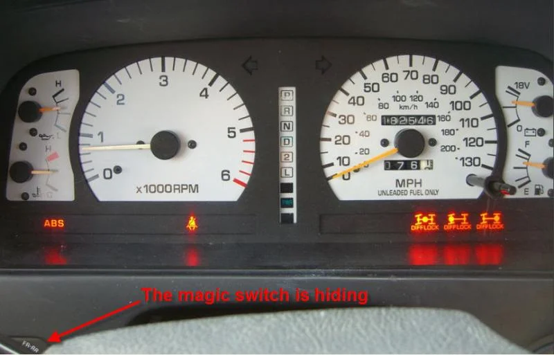

I purchased the factory rotary switch and the indicator lights from CDan. The wiring from the switch is already in place from the factory and just needed to be plugged in. The D5 connector ties this switch to the ARB relay board. The dash cluster has to be pulled out to install the indicator lights for the front and rear locker. The bulb sockets have masking tape over them from the factory that is easily removed.

The wire from the compressor harness for the compressor relay was not long enough to make it from the front right side of the truck all the way back to the left side of the dash so it needed to have a wire soldiered onto it so it could be extended. I purchased a Used Toyota switch with the plug and wires off Ebay for $5, there are lot of switches available that will fit in the 80 series dash holes but I waited till I could get one with the plug and wires attached. The switch just needed a 12v source that is fed off Ignition switched power.
The system works great and so far has presented no issues.
