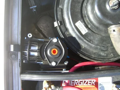

Chasetruck, do you have another picture of how the compressor is mounted? I am installing a SC and want to relocate my ARB compressor to that location.
Best I can do without a ladder or crawling on top of the engine...
There used to be an older RDCKA down there, but that started leaking at the big O-ring, and I know from the K5 how that ends.
Thanks ChaseTruck, that's pretty clear on how the compressor is mounted
With the S/C and dual batteries this was the only space left in my rig. Custom bracket bolted to the firewall and under the cruise module.

Thanks cyclosteve, really appreciate the pic of the mounting plate you made. Any chance you have a spare laying around?
