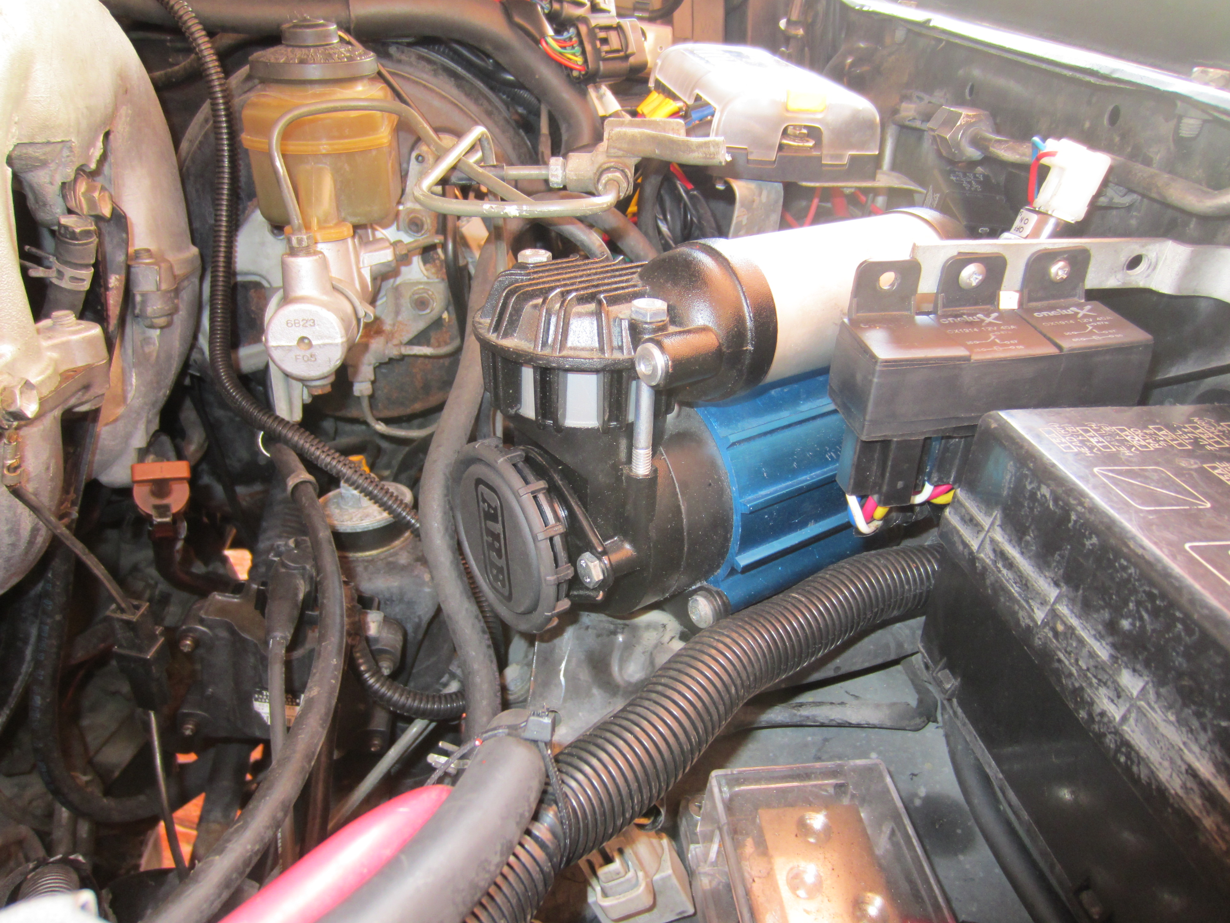

Purchased my rig already all ARB'd up (front and rear). Compressor mounted in engine bay never had a problem. Don't run it that often but so far so good.
Some vent their hoods (Pontiac or other) to help vent the bay heat, FYI.
Pics of my mount below FWIW. Good luck!

Thanks for the picture...
Is that the CKSA12?
