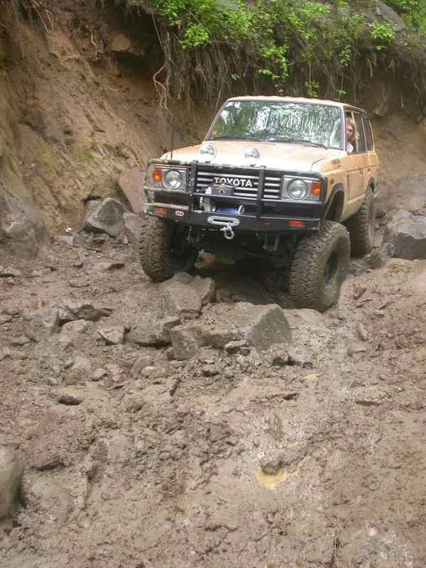

    The Sunshine State
    I have an 8274 smashed into a non-winch ARB, it effected the cooling power of the rad almost nil. Its a great winch too.

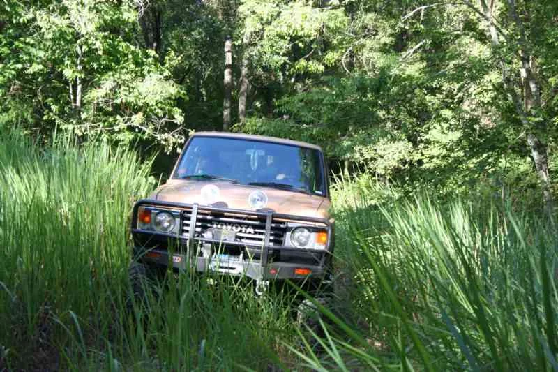

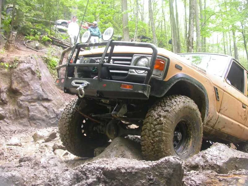

    Here is a few....its a tight fit. I even had to clock the winch forward a bit but it cleared everything with 1/8inch to spare on all sides. The only problem is relocating your lights if you have any, and the CB tab I moved to the outside of the bar.
    let me know if you have a questions...
