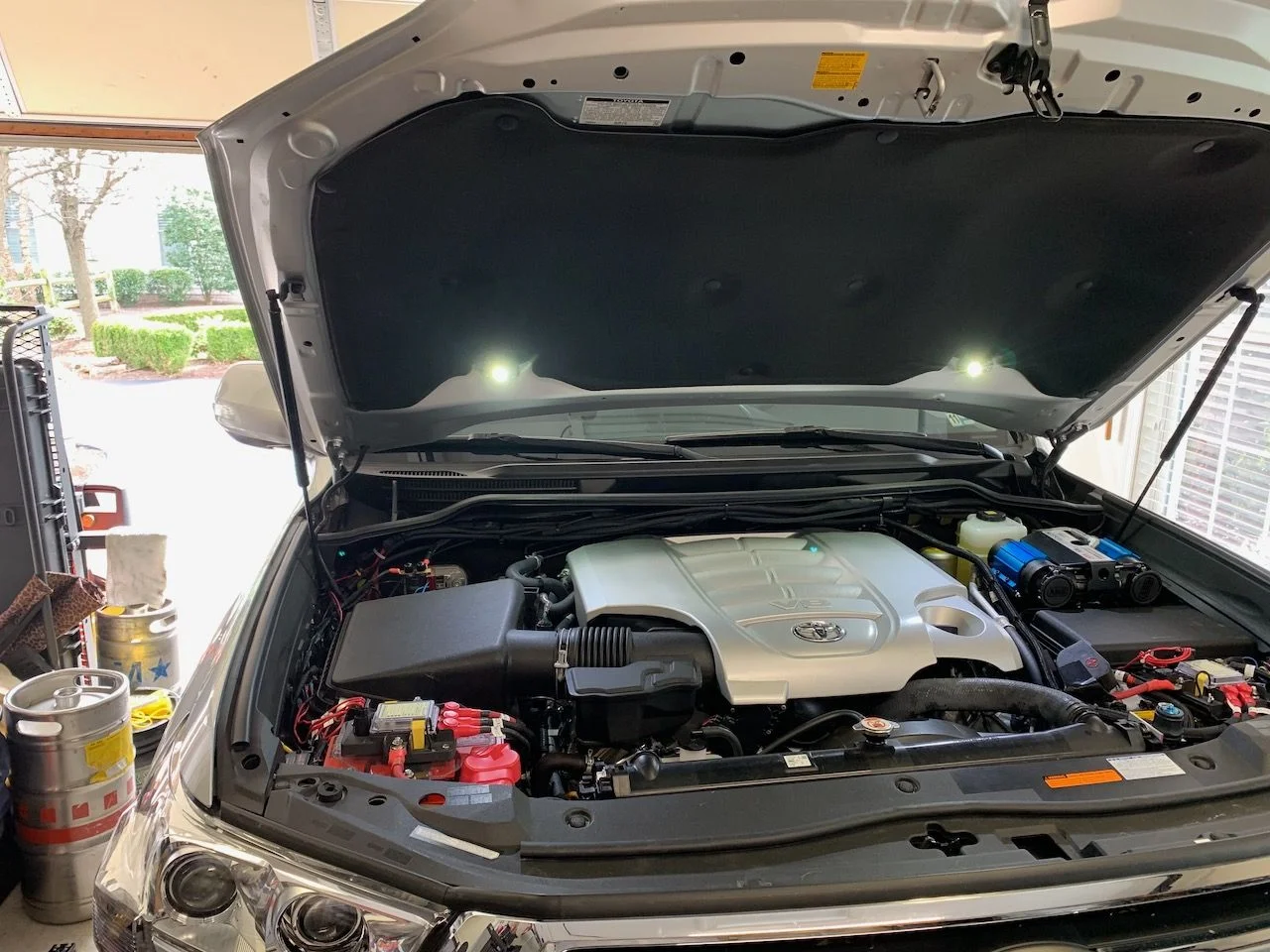

Pic below of the two LEDs in the engine bay that are triggered by the courtesy light. I can also manually override with a switch on Switch Pro panel or via app on the phone.

1. To have lightning in the engine bay when needed. Added two of the above lights for that purpose.
