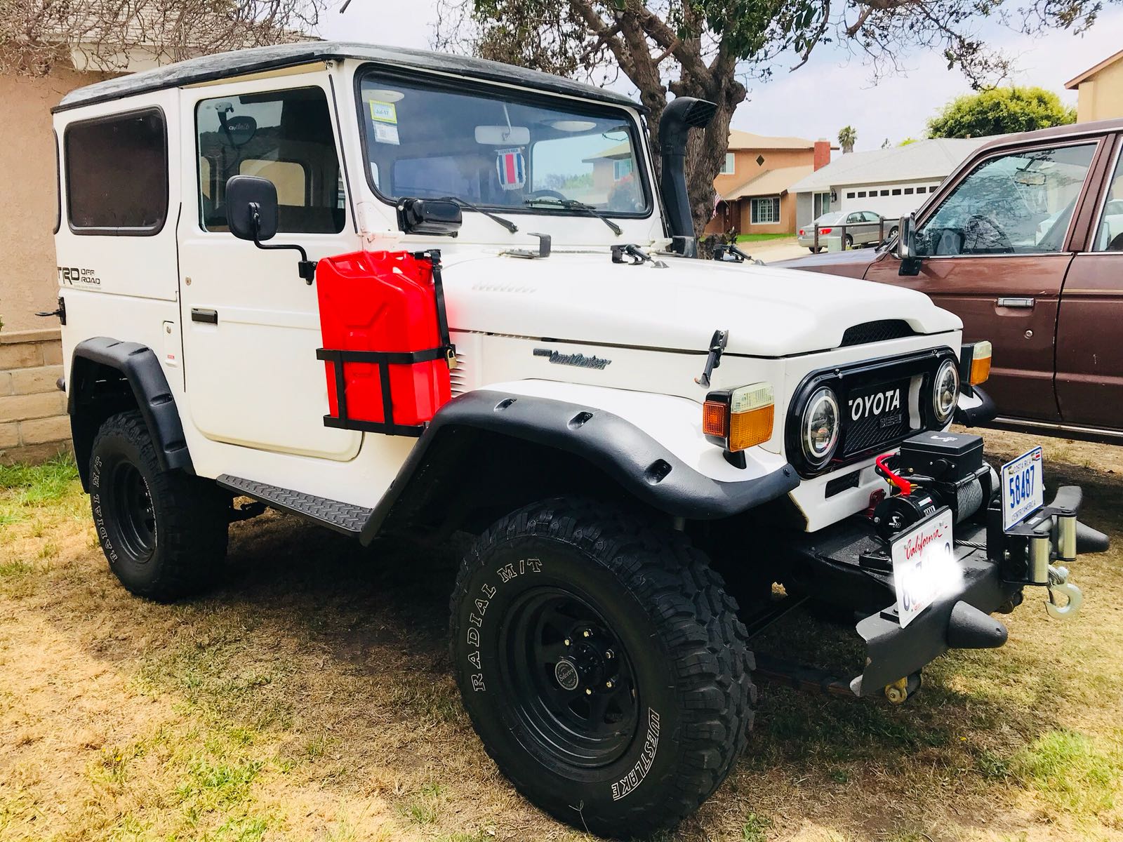

I purchased the 12HT drivetrain out of that beautiful beast. I’m currently restoring a 43 that the drivetrain will reside in here in California.

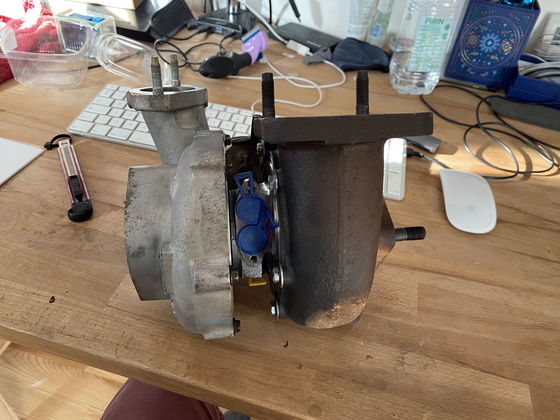

I got my stock 1HD-FTE VNT turbo reconditioned by Remy. Absolutely awful service! Initially everything started very well, a lot of communication exploring different options, boosting the engine, etc. In the end I decided on full reconditioning + replacing the impeller, CHRA and shaft with ones good for 1.5 bar.
Then I sent the turbo and it all went downhill after that. No responses for days. Finally I got my turbo back after a few weeks and the hot side impeller was binding?!

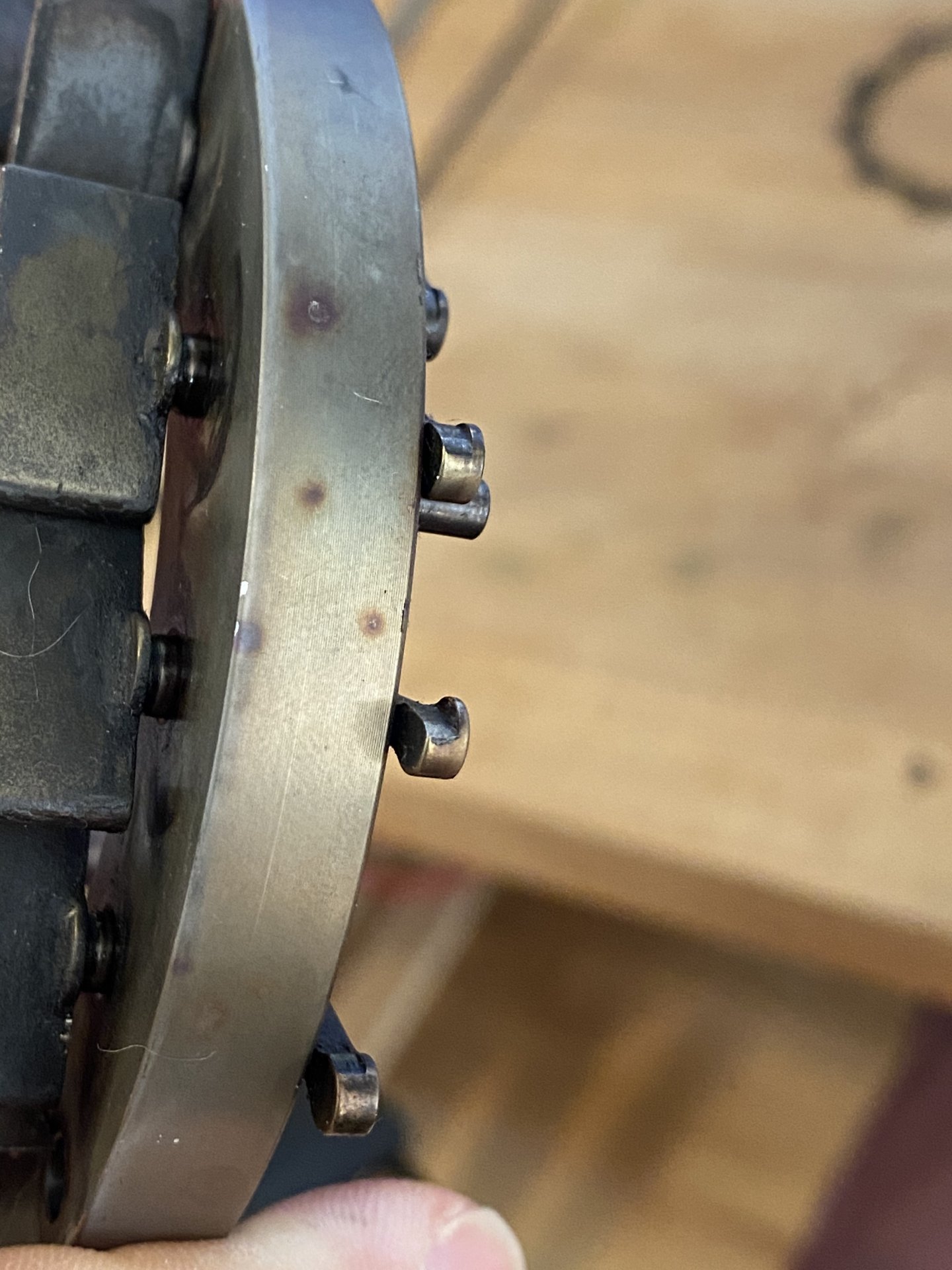

I had to get it to a local turbo shop to repair the repairs. Apparently the backing plate was bent and had hammer marks. They replaced it with a new one. The VNT vanes were badly worn. I specifically asked Remy about replacing them, because I had a couple of check engine lights that usually happen when the VNT starts sticking, but he assured me everything was fine. I had to source a set of new vanes myself - they are pretty rare to come across for the FTE.
This was the wear on the vane paddles that were supposed to be just fine...
The hot side was all dirty and greasy. The cold side flanges had dirt on them. It's a nitpick, but for the amount he charges, I expected at least a better cleaning, if not a working turbo.....
Remy never replied to my followup emails about the condition of the turbo. Just a short reply that the binding was normal ?!
I payed for the local repairs myself. He charged me €1046 for the pile of junk I got back.
