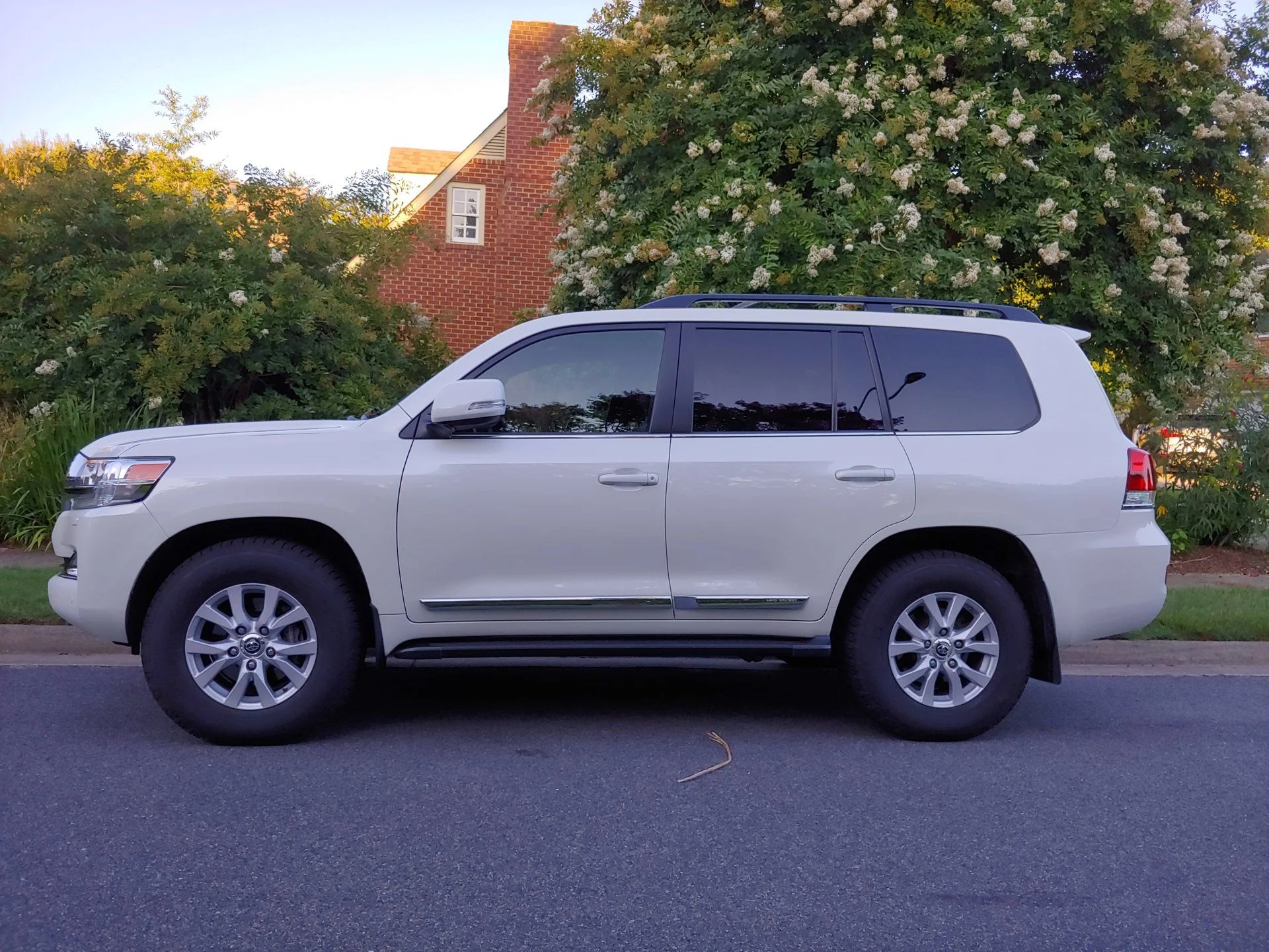

I just put a set of the General grabber APT 275/70r18 on my 2018 LC. Immediately did a 1000 mile road trip. Very comfortable, nearly as quiet as the stock dunlops. I averaged 17.9 mpg, mix of 80 mph highway and 55 mph 2 lane roads on the eastern shore of VA. This is the same mileage as the initial leg of the trip on the same roads with the stock tires. The 10+ lbs per corner really sold me initially, and now after the trip I am very happy with the choice. They fill the wheel wells perfectly and definitely look right on the truck.

Any chance you've got some side/profile photos of the LC with those tires?

Looks fantastic! The tires do fill the wheel wells nicely. Thinking I'm going to pair these with the AHC sensor lift and call it a day.
