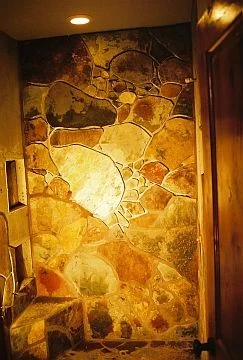

Most of the flagstone work out here is layed on a bed of morter and grouted in with morter. Also, the flagstone is random, I.E. not cut in squares. We score them with a 4-1/2 grinder with a diamond blade and shape to fit.
I'll post a pic of my shower, same principal. (This is slate).
