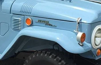

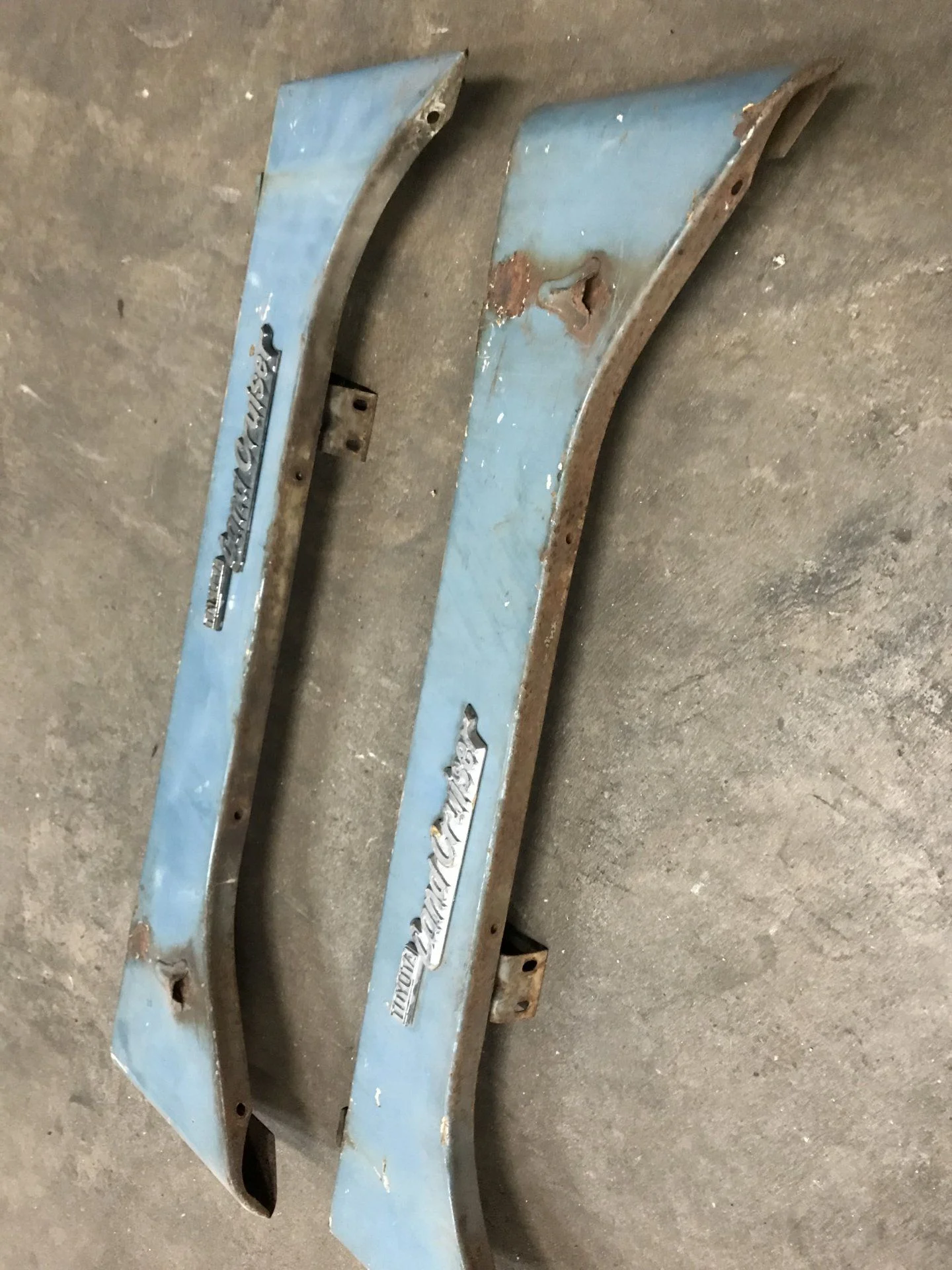

nope, those holes are for the 69/70 round reflector.
like this
Ok got it. So basically if it has no holes other than for the emblems it is a 75+, and should fit perfectly on my 1984?

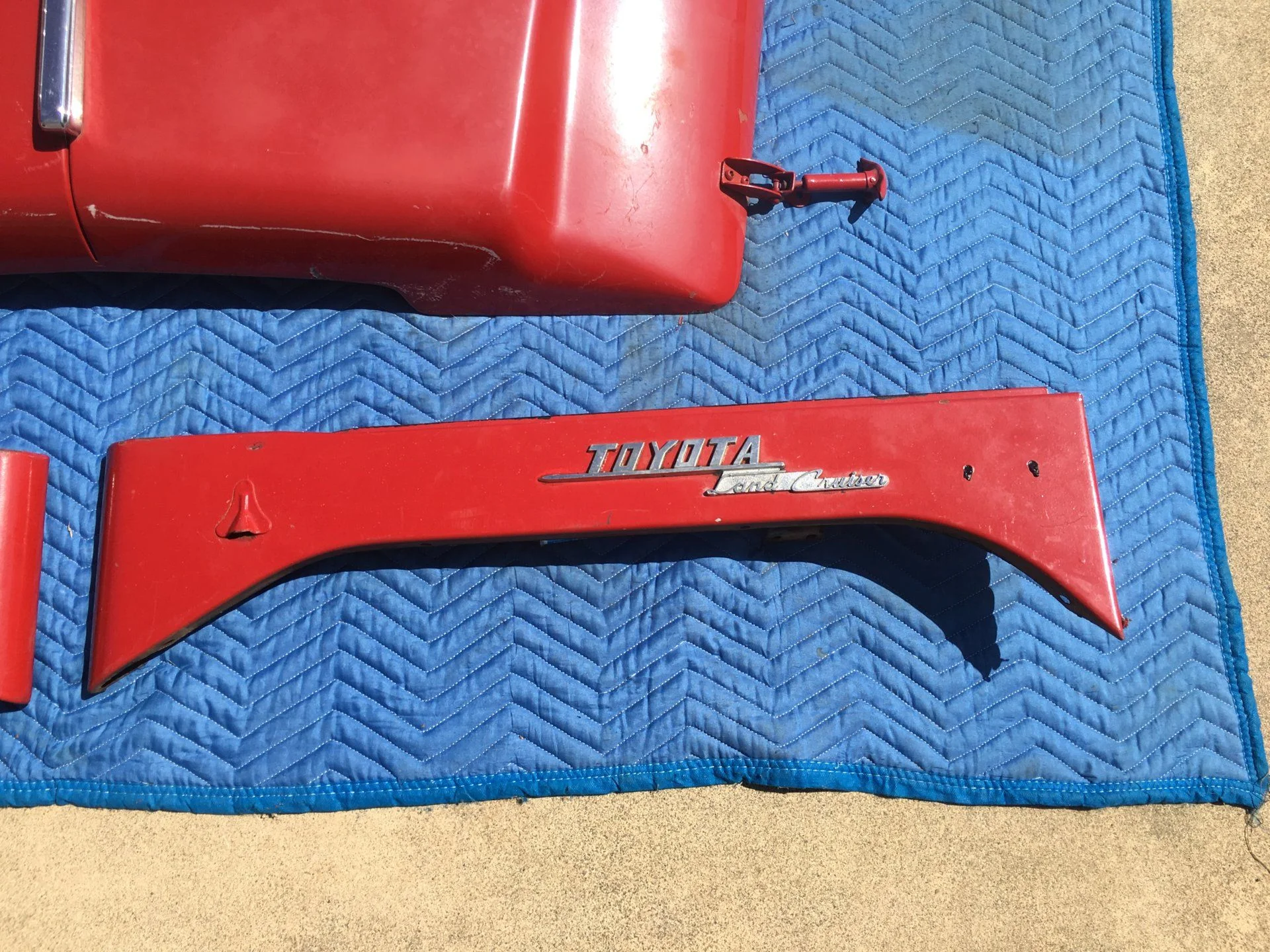

No prior to the 68 model there was no reflector other clearance light. It had a emblem but was a difference one. Older style was metal and newer was plastic. The newer also had a rubber pad towards the back to help support the hood and prevent it from rubbing directly on the apron.

Doesn’t matter that you have a B, 2B or 3B... I’m using early aprons for the early emblems. It’s just personal preference but I like the early chrome plated Land Cruiser emblem instead of the plastic version.
