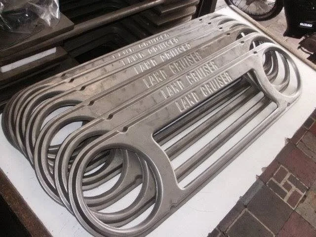

Anyone interested in these FJ40 headlight bezels?

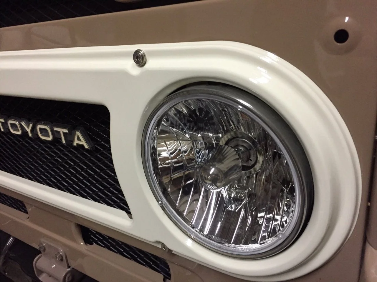

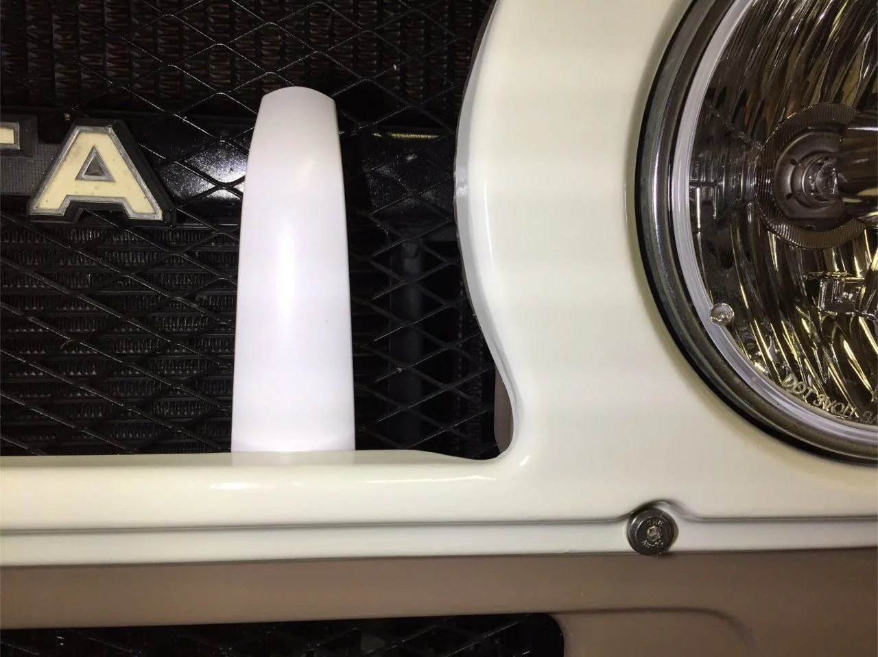

I prefered the 2K rattlecan epoxy from apstowerpaint.com over Cruiser Corps rattlecan paint. I had them mix 033 White. I PM'd a77FJ40 a more lengthy review. Here's a couple pics of the epoxy. The plastic piece in photo 2 is Nintendo Wii white:beer:

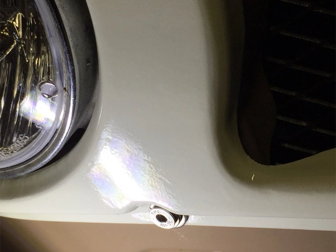

I just got around to mounting mine on the '74 and I may have found a fitment issue with mine... Looking at the photo of @Honger install you can just see edge of the recess for the headlight bucket on the bib at the passenger top side of the bezel. On my truck both sides are visible as well as along the entire top edge of the bezel. Thoughts on how to fix the alignment since it depends on fitting over the headlights? Will try to get the photos since we all love pictures...
Thanks,
Will

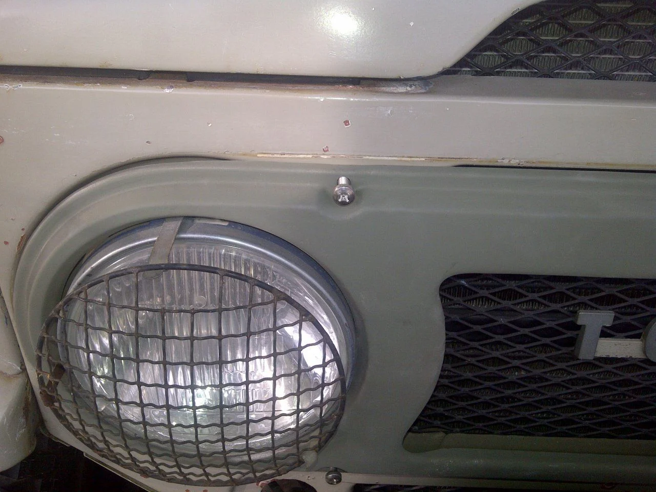

I used the original bezel as a template to locate the holes in the new one, laying the original on top of the new one and marked the holes for drilling and then drilled them one size larger with the step bit to allow for a little play for mounting... Bad idea?
You can see the gaps in mine because I've put spacers between the bib and bezel... as per original install by Toyota. When you look at mine dead-on you can't see the gaps.
That said, with the OEM bezel you couldn't see the gaps like this, even with the spacers. As it's a reproduction I'm overall very happy.
Yours does appear a bit more severe @tlc762, I'm curious if others have had theirs turn out the same way. I'm also wondering if there are subtle variations in the bib that is producing this result.
