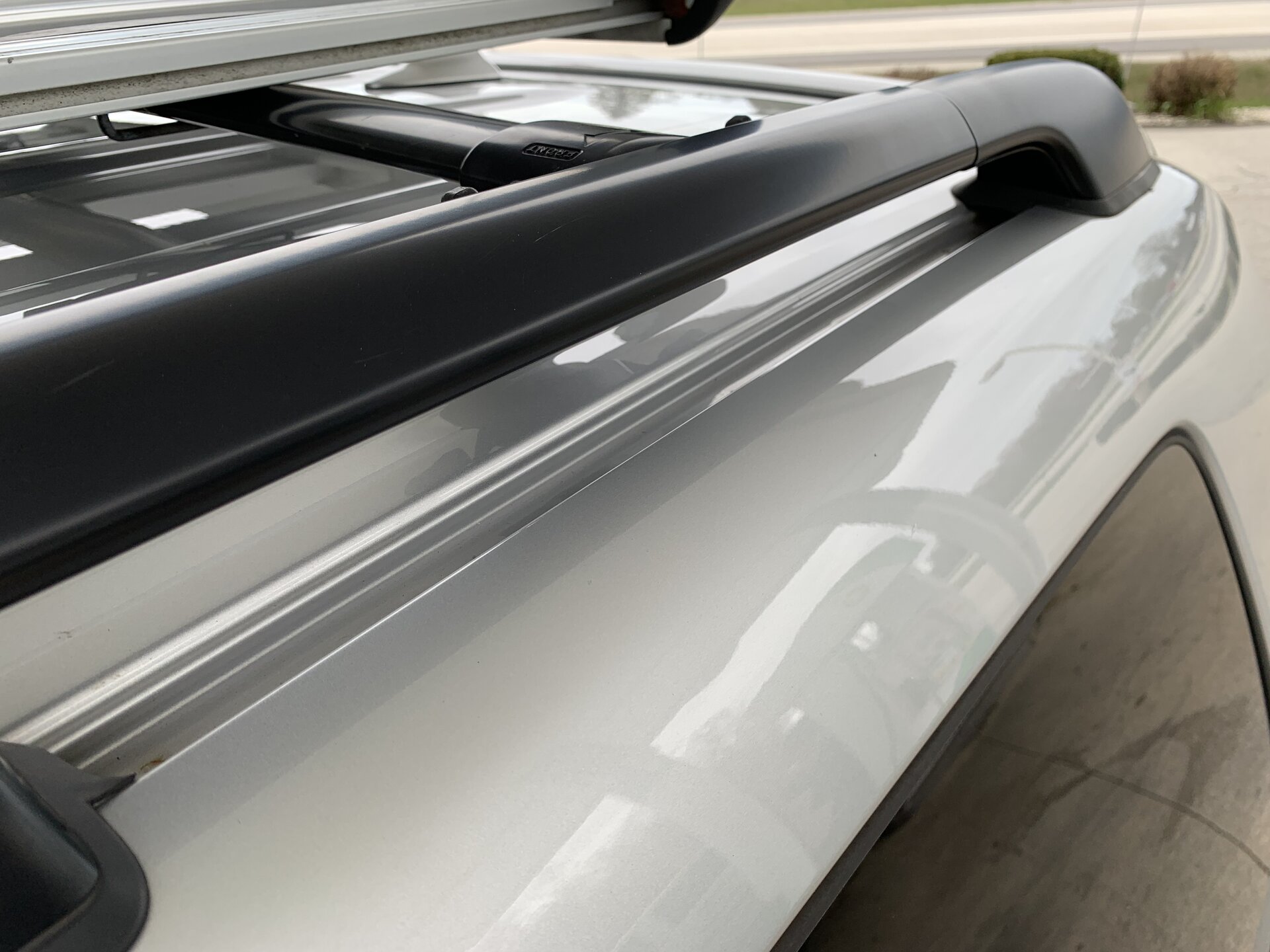

I checked my 2015 LC and sure enough I’m missing one on the back drivers side. I looked for the part number provided above (thank you) at Olathe Toyota and they have them in stock. Do I need to buy the clip (or anything else) or just clean the gutter and install? Maybe with a dot of adhesive +/-

Be careful not to bend the metal rib enough to give the trim an upward curve, which will help it fly out.
You don't need the metal clips, just the rubber strip.
