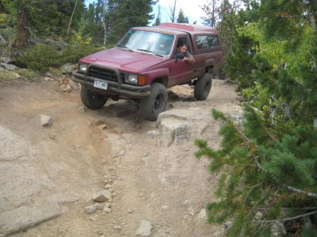

Maroon rustoleum. Looks pretty decent at first but fades to pink in about a year.

after a year I could tell a bit of fade...I attempted to buff it and it came out nice...
The best part is touch up after a full weekend of wheeling.:clap:
