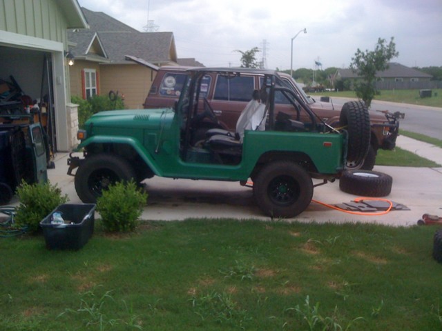

Heres mine....
rustloeum "navajo white"
I love touch ups after being on the trail or the trail being on it.

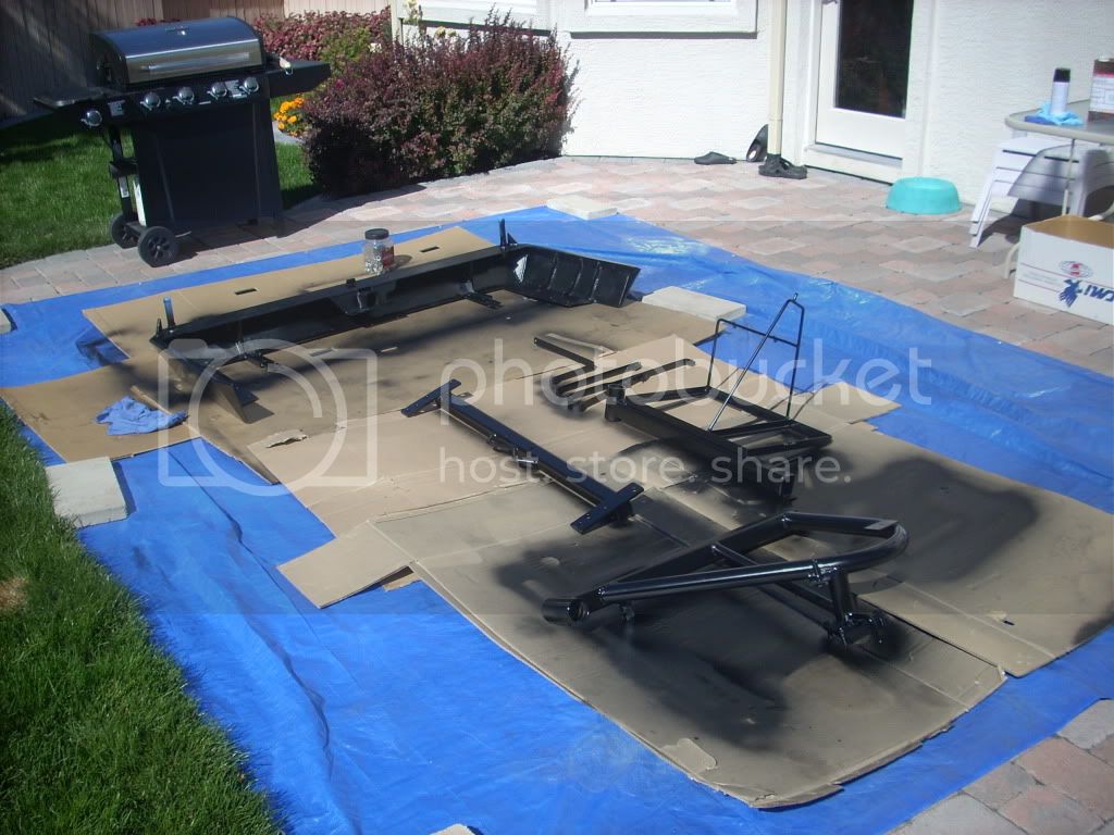

One suggestion I would make when painting bumpers etc. is to use appliance epoxy. It is a lot more durable and UV resistant. Regular Rustolem will fade in one season outside, appliance epoxy will hold up for years. The down side is that there is almost no color selection.
Here are the vents on my 60, I did them with black
Here is the rear bumper in my paint shop.
And installed.

How long has the black appliance epoxy held up on the vents and bumpers?
Probably a year with no change in appearance (the pictures were take right after I painted them but they look the same now). The truck is parked outside all the time.
