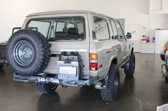

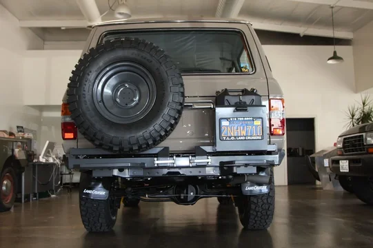

Does anyone know where I can have a bumper for my LX450 built? I saw a 62 on the TLC website and its exactly what I want. Designed by the owner, I figure with a Fab shop may be able to design a similar swingout after measuring my 80. How long does it normally take to fab a bumper like this and whats a ballpark estimate? Thanks guys
Hard to tell with pics but it looks like it sticks out really far. It might hit rocks, etc. Make sUre it fits bike racks trailer hitches etc.

Also, you might check out the 4x4labs 80 rear. Not just trying to sell you one since I have one, but the kit is a really good deal. I think I paid around $650 for just the bumper shell and then another $200 for all the swing out components, but I didn't buy the swing out that 4x4labs makes. If you get the double swing out with tire carrier and jerrycan holder (or ladder,etc.) its around $1000 as a kit or like $1500 welded up. Here are a few pictures of mine, but you can see more on his website http://www.4x4labs.com/products/rear-bumpers/

@pillguy it doesnt stick out to bad, this truck will be a dd and part time trail vehicle. I dont do any rock climbing so not to worried about rocks. Will accept a hitch, i just need something to carry a full size spare

A swing out made from proper materials with a strong spindle and high quality latch will have a greatly decreased change bending/breaking. A strong main swing (2"x2" or 2"x3" with at least 3/16" wall) is what you need along with strong tube for the vertical hoop. These are all things that a bumper fabricator SHOULD take into consideration when making swing outs. There are tons of pictures of sh**ty swing outs made by people in their backyard breaking, including on MUD. Things like this shouldn't discourage you from getting one made. A swing out is not something that should be done "cheaply" as these pictures are what the result will be. If you hire a reputable fabricator to do the job, they will know what they are doing and will come up with something that is strong and exactly what you wanted.
