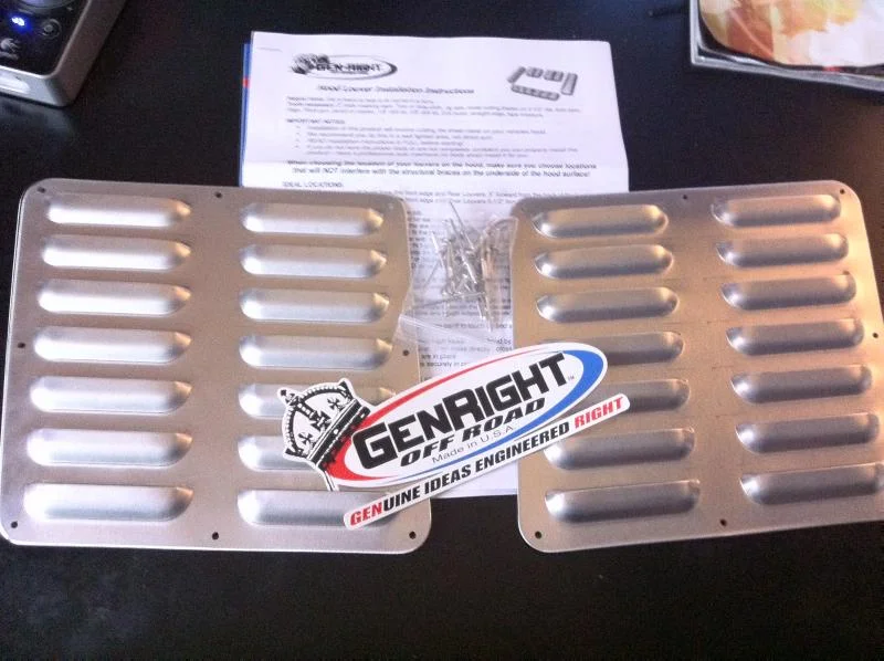

I pulled the trigger on the short hood louvers from Genright (ordered from MAF). I decided on these because I couldn't source some used GTP ones anywhere. New they are $80 a piece per my local stealership. The Genright pair were less than $70 to my doorstep.
I want to paint them yellow but don't think I have the balls to do so...
...........I want to paint them yellow but don't think I have the balls to do so...
I don't know. Paint 'em white like your rig, unless you want them to contrast. Then paint 'em black. The fun part is gonna be cutting holes in your hood :eek:. Hopefully they sent a template to aid in the install. Good luck!
Paint them yellow. I think the contrast would look great. Have you installed them yet?
I'm not sure why I want to paint them yellow. Probably because I like to be different. They didn't send a template, but I'll create one and take lots of pictures. They did send directions and a tool list...:meh:

I agree. Whatever color I choose, I think they'll look great. But more importantly, they are going to let all that hot air escape. I've been researching the location, I noticed they will fit in the same spot Treeroot did his. This location doesn't require as much work because it isn't interfering with the under hood bracing and overall structural integrity like the above picture.
