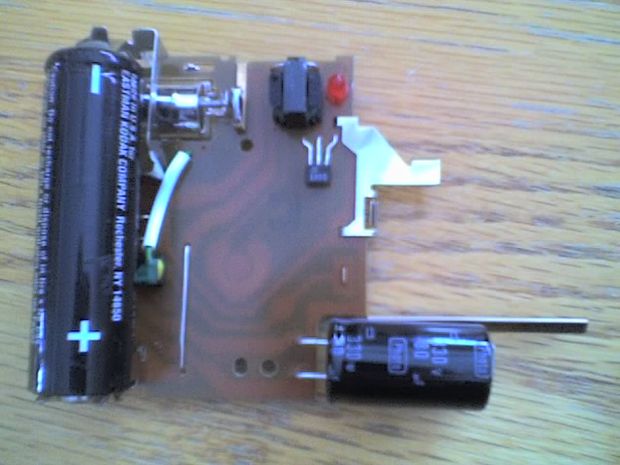

Here's how to put one together..
$5 disposable flash camera, break open the box, save the electronics.
Pick up some 14ga wires, a 3k capacitor, and a 9 volt battery connector and a 9 volt battery.
14mm socket and wrench.
Hog Ring Pliars.
Wire Strippers.
Solder gun.
Hot glue gun.
Remove the flash bulb and the small capacitor from the circuit board.
Place the 3k capacitor where the smaller one was.
Place the battery connector where the aa (*or aaa) battery leads are.
Run a pair of leads, around maybe 25" from the flash bulb terminals.
Pull out your driver's seat and remove your seat cover. Place both leads from the flash bulb part about 2" apart, with the last 1/2" of wire insulation stripped off. Splay the individual wire (threads) out into a half moon/star patters, towards each other and tack them down with some hot glue. *My preference is just a little off center to the right, where your pelvic bone/right butt cheek are.
Now, take some more wire, and tap off of the pressure switch, or if you're lucky you can remove the pressure switch and put it about 5" forward of the exposed flash circuit wires.
Throw your seat cover back on. Tuck the circuit up where it won't get shorted out. You can get fancy and figure out how to make a hidden push-click switch if you like somewhere along the left edging of the seat in the foam somewhere.
Next time some fool inadvertantly tries to take off with your vehicle, he gets a "pleasant shock" at your vehicles abilities.
